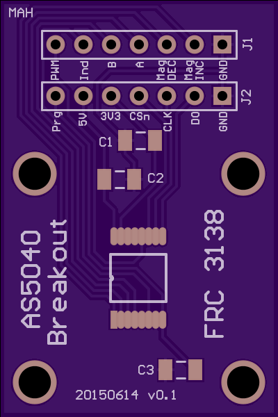

I was annoyed with the grounded mounting holes and the odd mounting dimensions for the eval board on DigiKey, so I made my own.
Use at your own risk as it has not been tested. While it looks like the holes are grounded, there is a ground pullback.
Gerber Files and Schematic are attached.
Order PCB here: https://oshpark.com/shared_projects/vgQrxpF7
OshPark Render
Layout:
