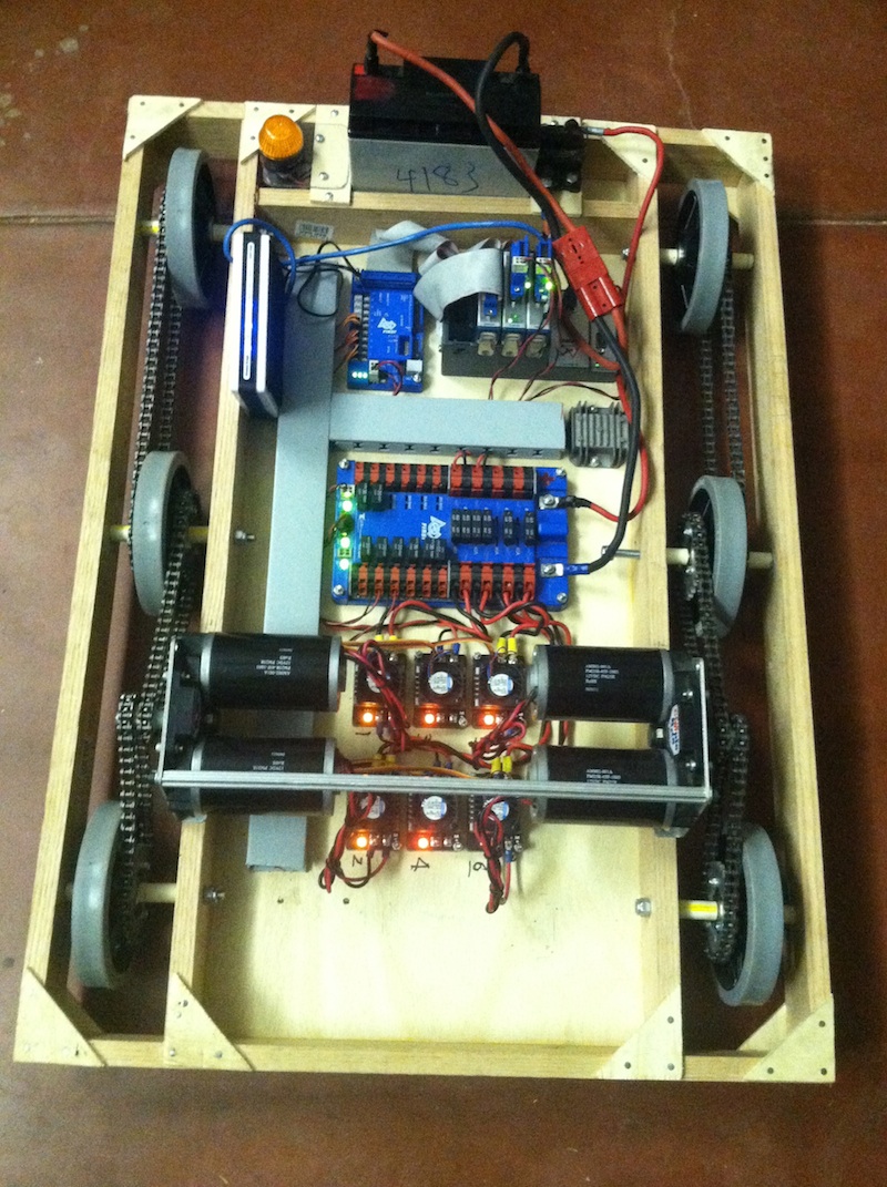

This is a prototype chassis we built to provide a platform for prototypes during build season. The frame is constructed from 1x3 red oak planks and 1/4" birch plywood. The framerails have axle holes drilled for 6wd drop center, 6wd planar, and 8wd using 4" through 8" wheels.

How strong is this frame? Could it hold up to an actual competition? I ask because 4392 builds their robots out of wood. Last year we used the kit frame but maybe our frame this year will be wood, if it could hold up.

This chassis is just our prototype so it will not be able to withstand competition, it is just for attaching various parts to to see if they work for this year's game. Because we don't know this year's game we decided to make out of wood and make it compatible with just about anything we need it to do.

To clarify what kuraikou posted, this chassis would likely be able to withstand competiton but will never have to. The chassis we use in competition will be somewhat more sophisticated...

I take it those are the optional fan mounts? Any reason for attaching those?

For anyone wondering if the wood will hold up in FRC, look up FRC 1771 in the CD images. They've used since 2009, and have never really had an issue with it "holding up".

A better example might be 173 RAGE, who has used a Birch chassis almost exclusively since at least 2001, and have won a Championship and a division and several regionals with it. (and pre-bumper era too!)
Search CD media for it, it's arranged very similar to yours. I would suspect your frame would hold up quite well with some aluminum angle on the corners and a few cross braces between the drive plates.

They came with the First Choice Talons. Running the Talons at 40 amp for two minutes can get them pretty hot, so by adding a very small amount of weight and complexity, we are keeping the Talons cool, and are likely to extend their life.

In case no one here knows....Gary (GUI) was the chassis lead for team 1726 in 2008 and 2009...the wood chassis he designed and built in 2009 won the Motorola Quality award (and the blue banner) at the 2009 AZ regional.
I woodn't diss the concept of a wood chassis for the final robot, and I sure like how this prototype looks in the photo.

I wouldn't use this specific layout for competition only because the outer frame rails are only supported at the ends. However, the basic "kitchen drawer" design is strong and rigid. This particular chassis has about eight hours of labor to this point, and most of the work was done by students with very little manufacturing experience. We chose wood for this chassis because it is readily available and allows for multiple axle holes and easy mechanism attachment without compromising the structural integrity.

Yeah, the talons are mounted, but electron-starved without an operating cRIO or battery, or or ore oar . . . . . The frame looks good, but drivetrain is best described as embryonic.

This effective use of resources that are common and easy to you would do well during season.
With some minor tweaks (as you already know I imagine), this could make a great competition chassis/drive.

What is the metal 't-shaped' piece mounted between the power distribution board and the CRio?

It looks like a plastic wire duct. A cover snaps over it. Keeps the wires organized and protected. But that's just a slightly educated guess.....

It's a very good guess. The duct should help keep the robot's wiring much neater.

Looks like the wires go the wrong way, maybe?

I work on the fields at competition, I see a lot of really weird things done with electronics. If you want to make them last, and fairly maintenance free, don't mount them face up like you did in this picture. Mount them standing or face down (just rotate the crio 90 degrees). It keeps all those pesky metal/wood shavings and dust from causing lots of issues down the line.
It certainly doesn't look as nice quickly, but if you take the time you can figure out a way to make it look real good. (And don't forget your Radio too!)
This step is crucial if you use jaguars also, but the victors and talons can probably get away without.

Yes it is a place to put the wires so that they are all nice and neat. As previously mentioned this will probably have a bunch of prototypes attached to it so it needs to save space and be able to be easily movable/removable and if the wires are tangled that will be difficult.

Here she is, all wired up and power applied. Still need to write some code... the programming team is learning Java robot programming this year, so they now have a nice, big, dangerous toy to work with.

looks good bro! With a few cross braces, that would be a stout chassis.

I second those who have mentioned teams using wood drivebases... it can be done very well and can be significantly easier to fabricate. I recall 173 - at least on their 2007 robot - used a many-ply (9 or 11?) birch plywood of about 3/8".
I don't have any experience with wood drivebases personally; however, our team (especially in it's early days) tended make things way too beefy and heavy. I know Oak is surprisingly dense, so I recommend intelligently experimenting some with using thinner/smaller parts in lower-load areas (it's easy to use a heavier member than needed just because you use it elsewhere... we've done this with 80-20, when many components could be 1x1x1/16 box alum, which is half as heavy). Speed-holing can also provide some weight savings... although I have also seen teams over-speed-hole a critical points. All that to say, "Be careful of surprisingly heavy drivebases... a 6WD doesn't need to weigh >50 pounds without electronics."
Also, if you're looking to save weight, switching to #25 chains or timing belts can be a good way to do it. The larger your sprockets are compared to your wheel diameter, the less tension they're subject to... A small change I recommend with little/no cost is to make the longer chain runs between the center wheels and the end wheels #25 chain instead. With a >3.5" sprocket, I would be surprised to see a failure on that chain run, but even then you'd still have 4 or 5 driven wheels.
It looks like you're using a 3/8" bolt for your axle... which I like using for dead axles... although be careful not to over-tighten them! I would recommend you make sure it's a Grade 8 bolt, though. From our team's experience, a standard (Grade 5) bolt is unlikely to hold up in competition.
I would strongly recommend implementing now the stiffness modifications you expect to make... Drive Bases - particularly 4, 6, and 8WD ones - take a surprising amount of internal load. A particularly important degree of stiffness is bending along the diagonals (when viewed from above). Drive Bases with insufficient stiffness can make a 6WD base with plenty of "center drop" hop. It's important to have a sufficiently strong drive base if you're going to be testing and comparing different drive trains, so you can get useful experience with each.

95 used wooden chassis almost exclusively until 2005, then a few more times since. Mostly in the pre-bumper days. It's a great what to make a chassis. We typically used 9-layer birch plywood connected with 1"x1"x1/8" aluminum angle and bolts if memory serves.
