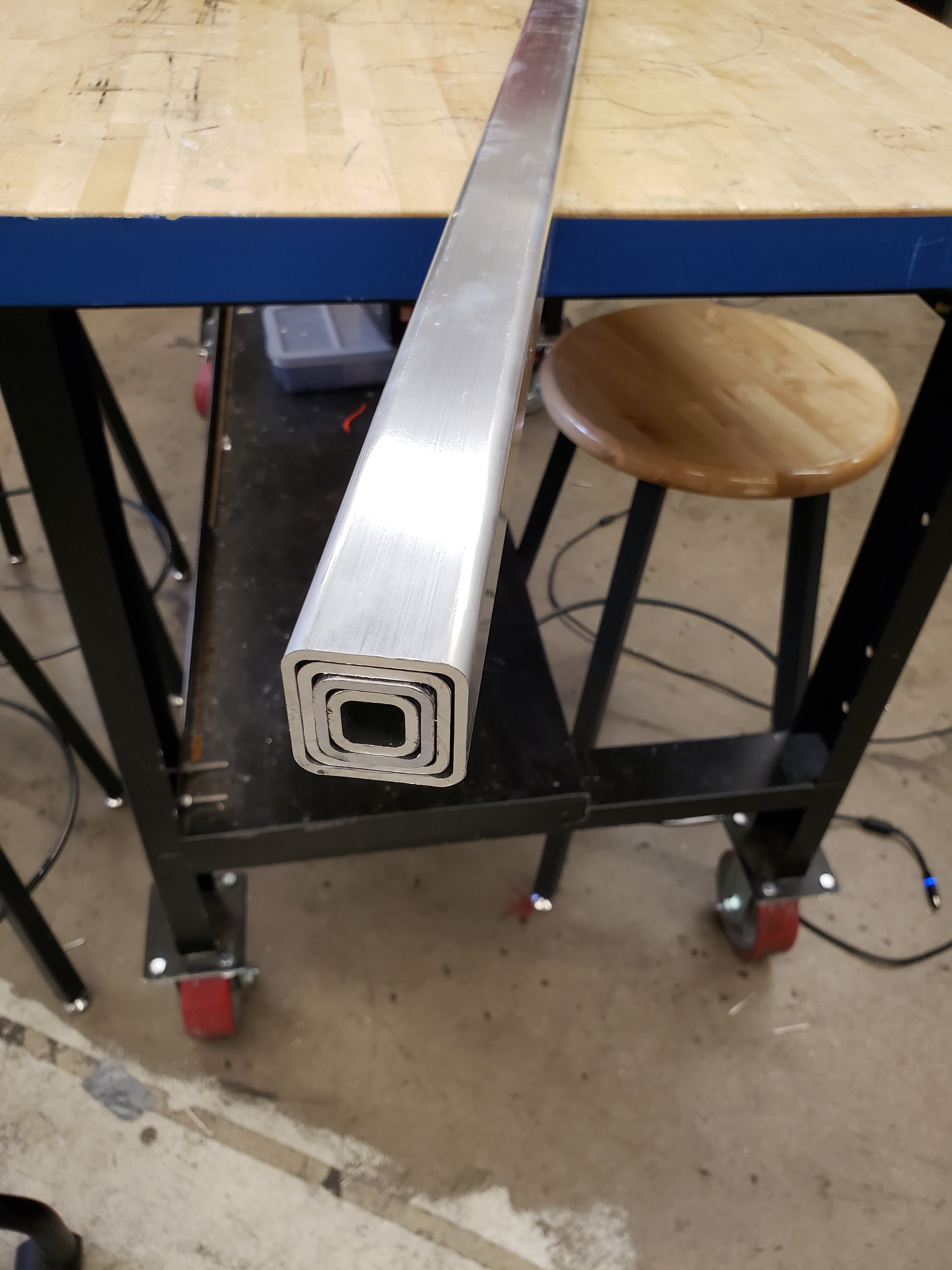

Alcobra has telescoping tubes that we are using for our climbing structure. Turnaround is about 4 business days.
Oooh, a telescoping elevator?
are those going to slide on themselves or with bearings?
We are using cf springs to power them out. No bearings.
I can’t wrap my head around this, how are you using CF springs to extend this?
This looks heavy, is it 1/8" wall on all of those or is my scale perception just off?

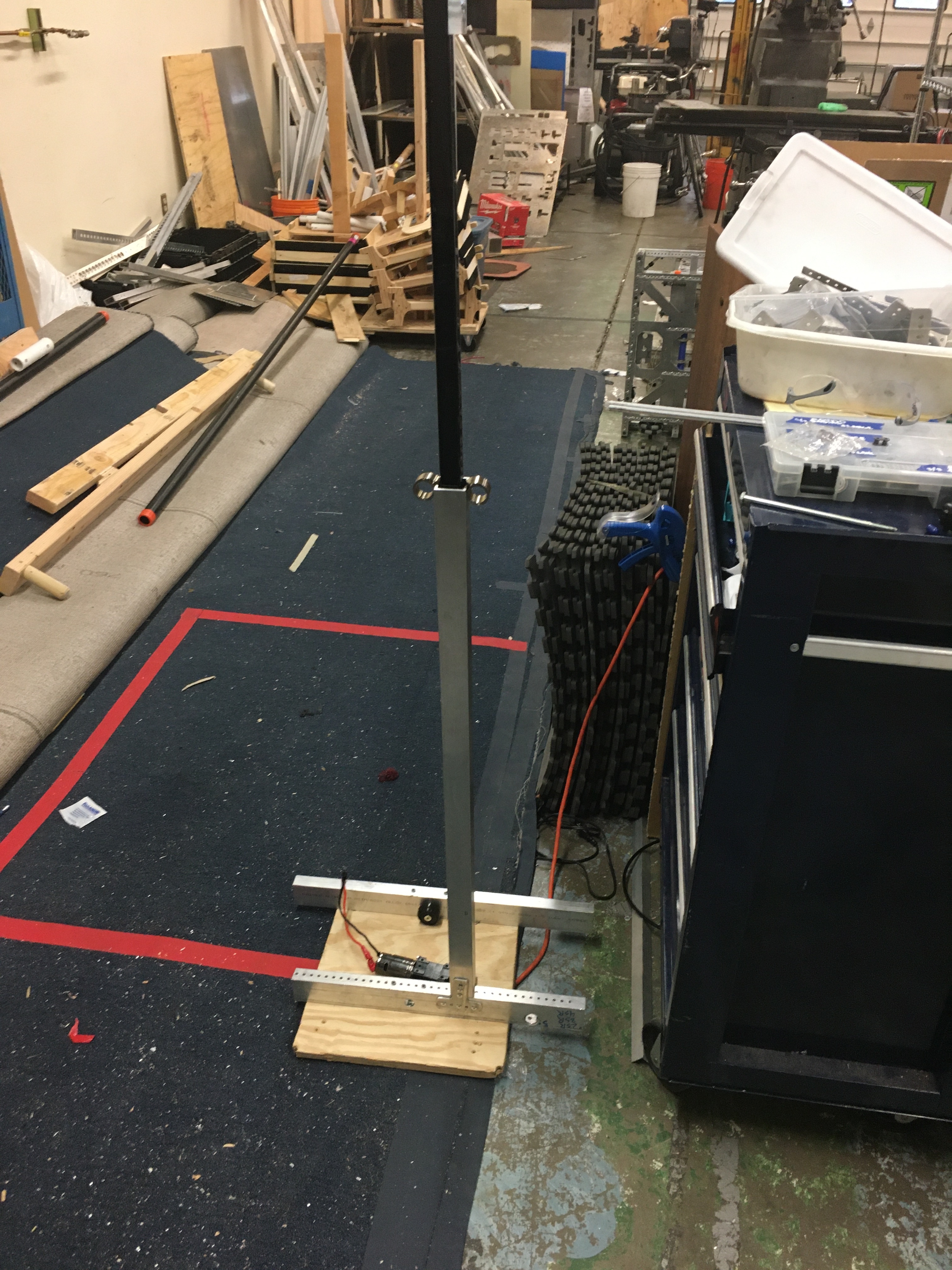

Nick is not only correct that this concept is similar to 33’s, it is based on the designs of teams 33 and 2056. In order to have enough space to insert the CF springs into the tubes we are milling two parallel sides on each (interior) tube. They are currently 0.11" thick, and the parallel sides are being milled to 0.05" thick each. On the non-milled faces, the gap is large enough that we will put a piece of Teflon tape at the top and bottom of the tube on each side, preventing aluminum-on-aluminum contact.
This is not ours, but a good example of the way this is setting up.
I think I posted a chart of CoF for aluminum on aluminum when we were discussing robots sliding during hang…but I can’t find the picture now. It was very reassuring, assuming we use an aluminum hook. But it’s very scary, if one intends aluminum parts to move inside other aluminum parts.
