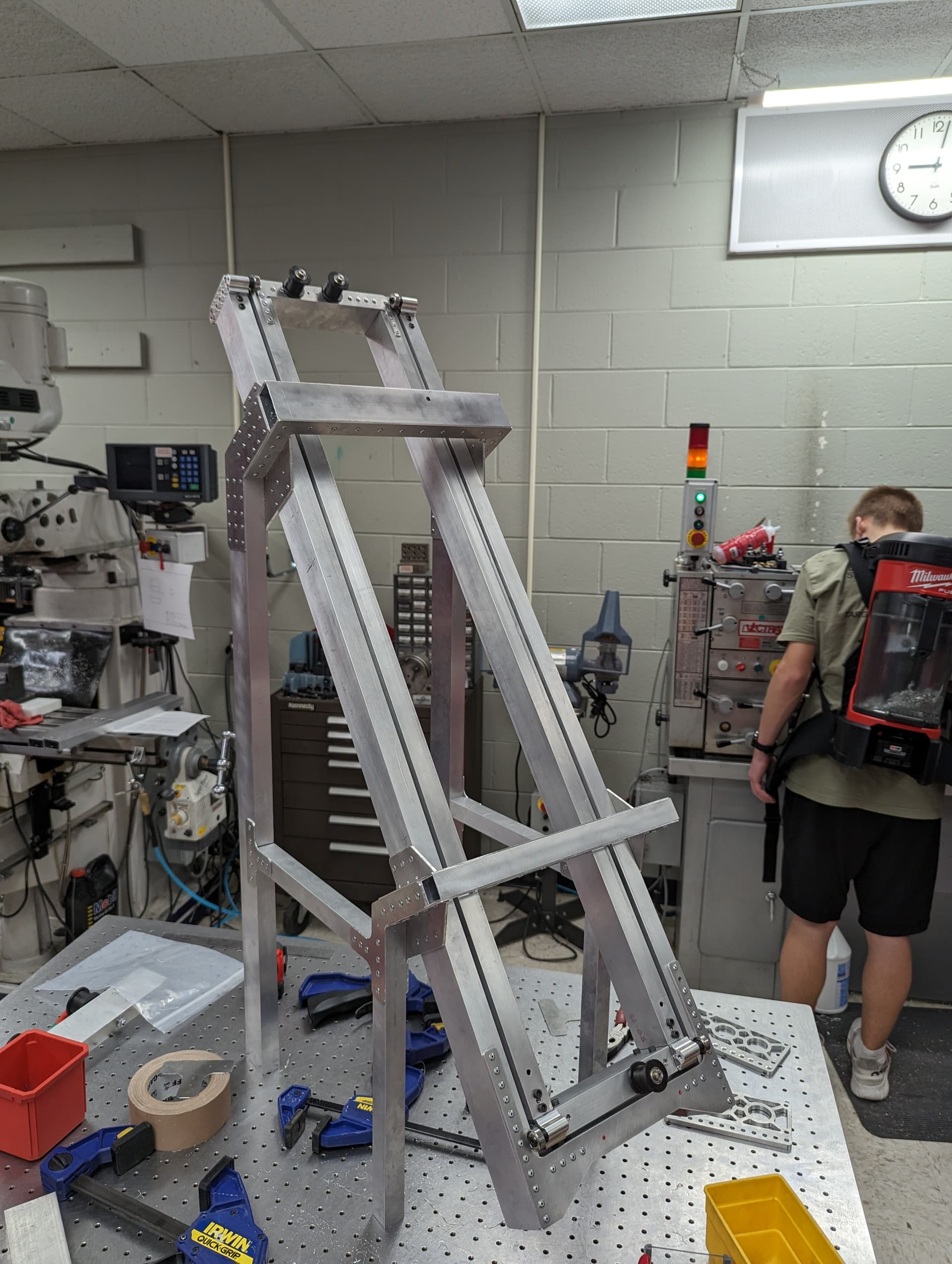

I get best results with rivets by adding one bolt per fixed member of a riveted joint. So every corner gusset gets filled with rivets, and then I add 1 screw through each tube the corner gusset is connecting. This ensures that the screw helps take up shock loads while the rivets drive most of the strength of the joint. I used to have rivets loosen up all the time, and now it seldom happens.

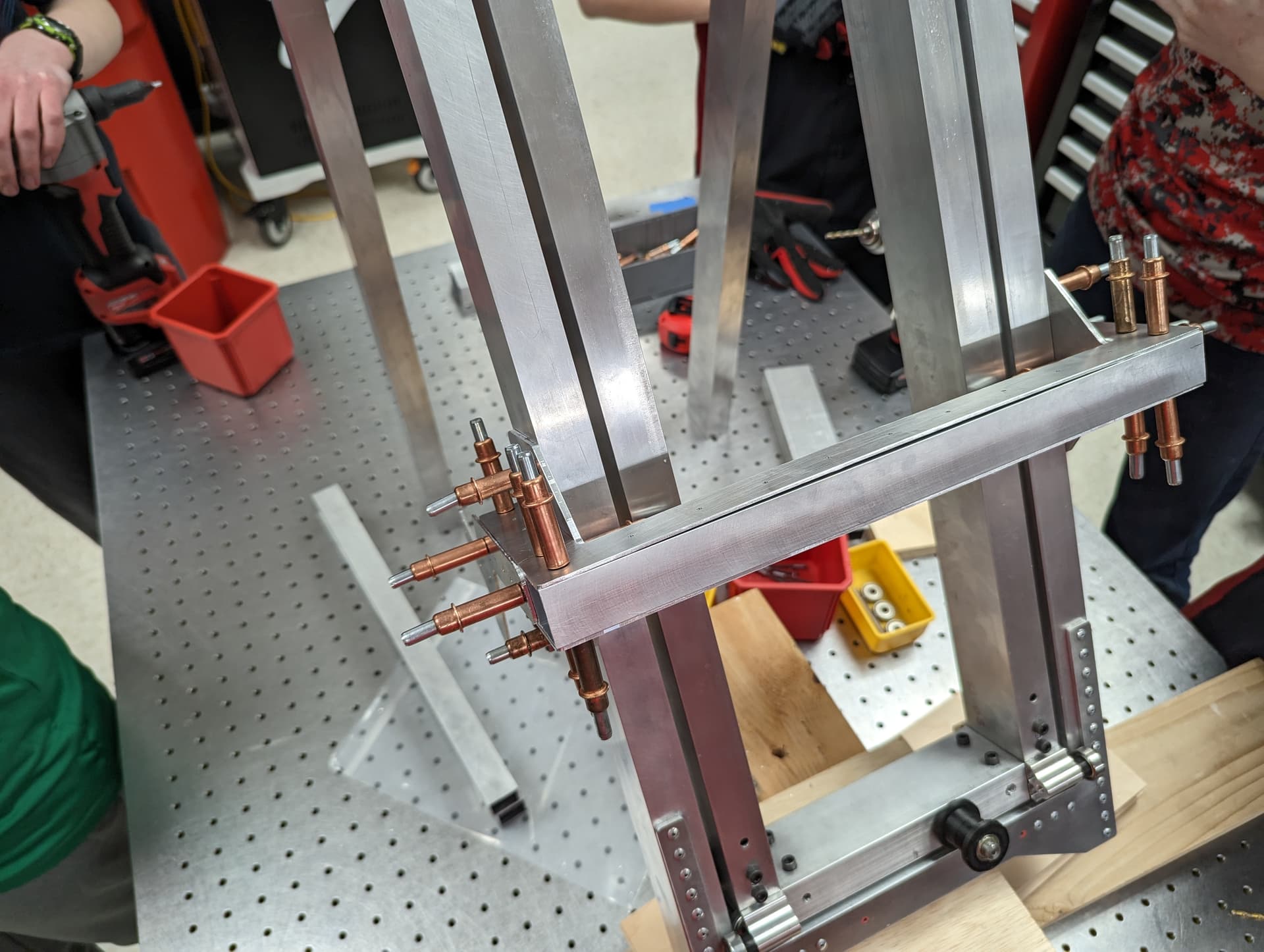

The Milwaukee rivet gun is possibly our best purchase as a team. Most of the time we match drill all our riveted plates to the tubes. We undersize the gusset holes to 3/32, line everything up and clamp it down to a fixture table, and drill and rivet as we go.
A few of our assemblies we pulled out the Clecos to rough assemble everything before we riveted. We got a set similar to this on Amazon a couple years ago, also a great pick up depending on your workflow.
