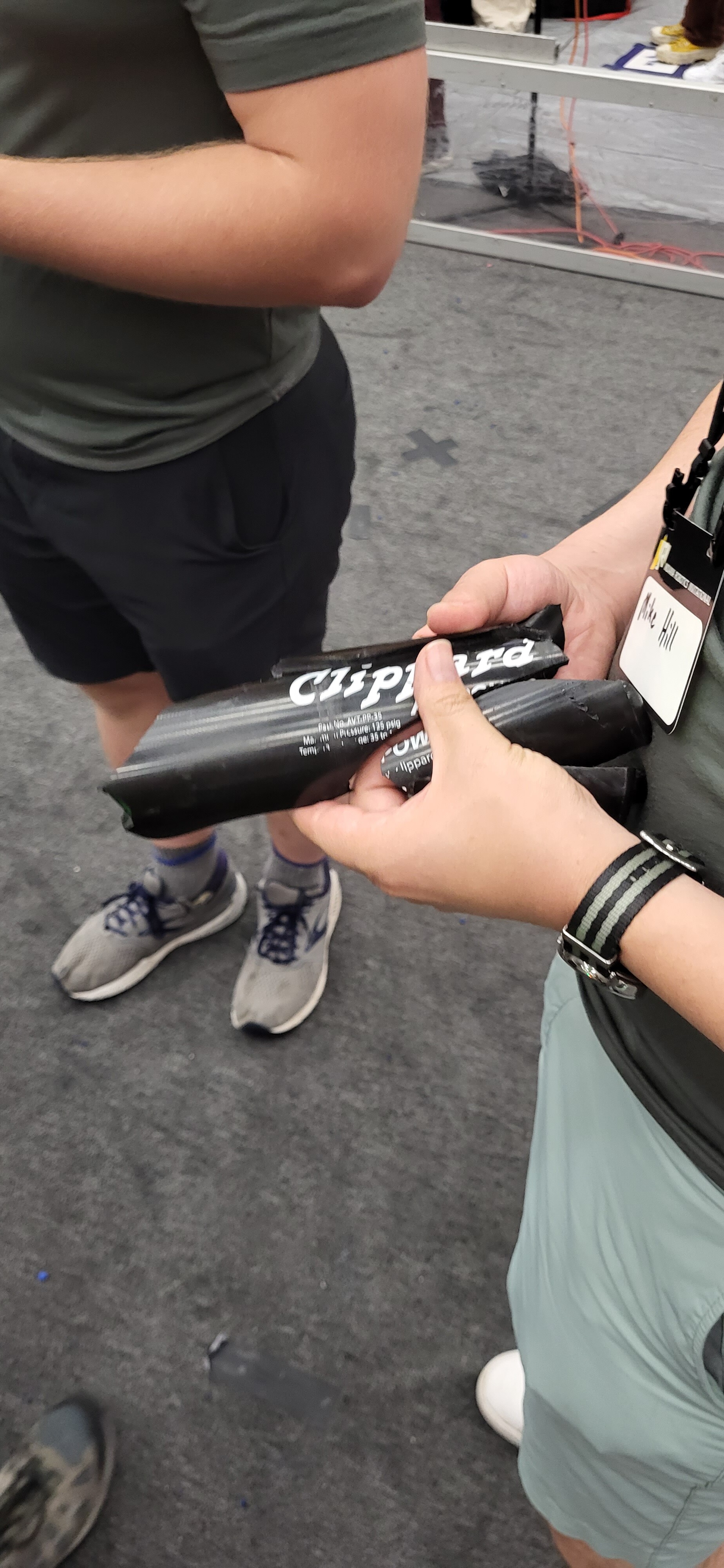

1023 Clippard Tank Explosion at IRI
Trying to track down the fieldside video of this. I was about 8ft from it. Was quite the time.
Will follow up if I find the video.

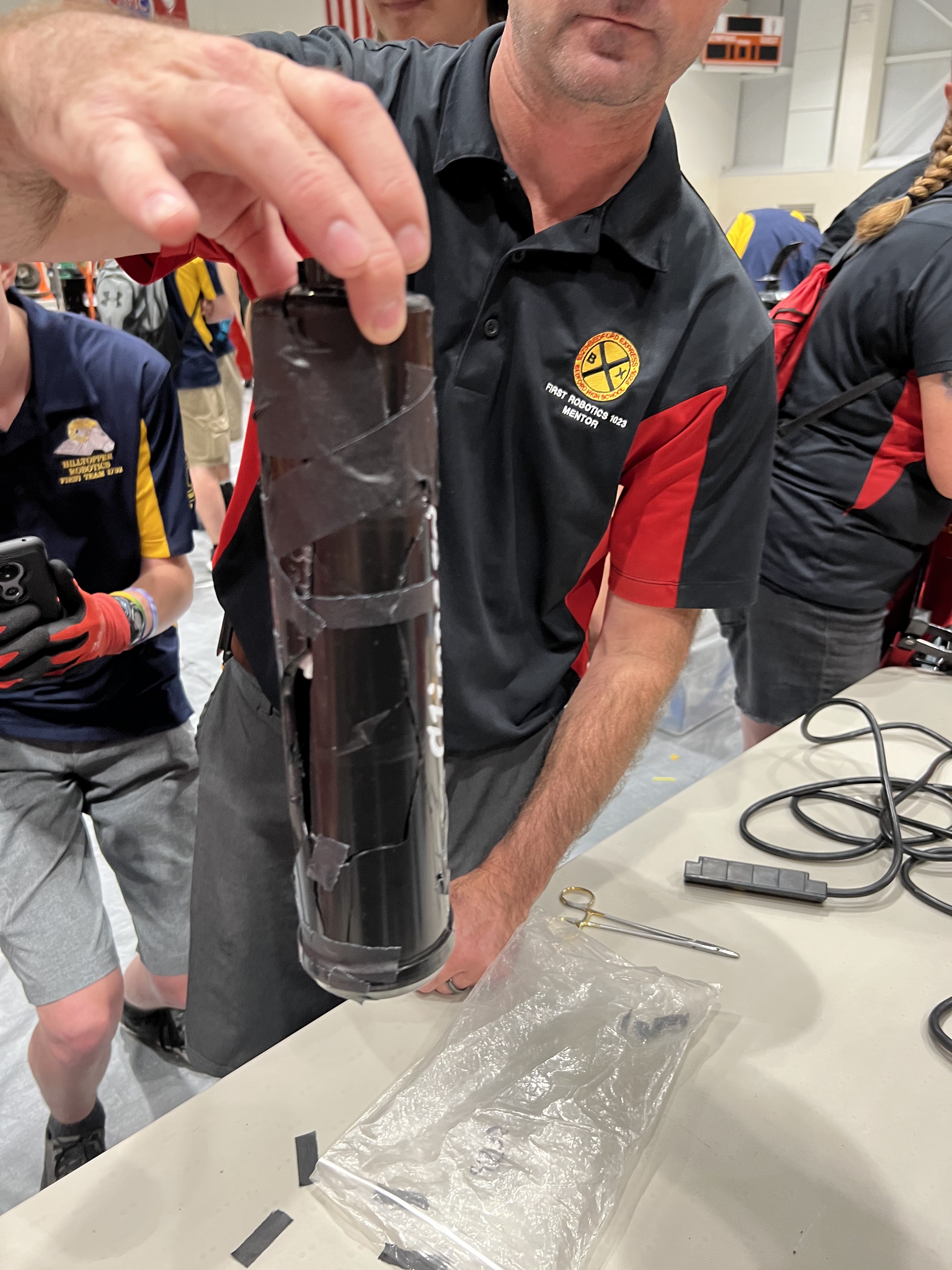

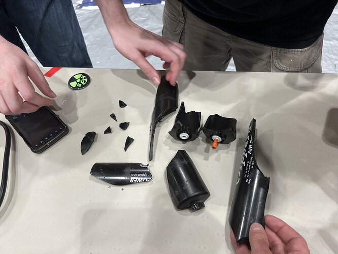

I did field reset during this match. Here’s what we know:
Another robots intake hit 1023’s air tank. Afterwards, the air tank exploded and there were multiple pieces across the field. Most of the pieces have been returned to 1023, the rest of which we have been looking for. Here’s another picture of some pieces.
I’ll see if I can get more information
Supposedly, 1023 also hit the wall and there was aluminum on the plastic.
Frankly, we don’t need rules about air tank placement - we need rules about air tanks. Only plastic air tanks have this explosive failure mode. The stainless steel air tanks that were standard in FRC for years would not fail explosively.
Rather than trying to make an unsafe product safer with subjective rules about robot construction, let’s just go back to only allowing metal air tanks. Sure it’s a weight penalty, but plastic isn’t worth the risk.

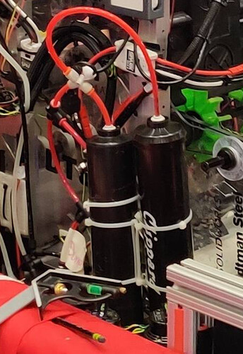

Is this (taken from their TBA page) a good representation of the setup?

Yes it is! The one on the right is the one that blew up

I have to disagree. The rules do warn teams not to place tanks in areas where they will be vulnerable and that should be sufficient. Looking at the pictures and the response from @percussionette, it’s pretty apparent that this was not good tank placement. It put the tank in question low on the robot, close to the frame perimeter, exposed to the outside, and backed by a solid frame element of the robot. In other words, it was in a perfect position to be sandwiched between the support it was attached to and extended parts of other robots in a collision with nowhere to flex or move out of the way. Looking at the video, you can see where the extended intake frame on 5712 (an aluminum 1x2 tube) spears straight into it with both robots moving at speed. That might well pierce an aluminum tank too. Robot inspectors need to be more careful of things like tank placement for this reason. Tanks need to either be behind protective elements of the robot or mounted in positions where they can move and/or flex away from the force of impacts. The fact that this kind of rupture is a rare occurrence should tell you that forcing everyone to go back to only metal tanks is overkill as a solution.

This is what is known as a leak-before-burst or leak-before-break pressure vessel design. I’ve done design and testing of pressure vessels for this criteria in the past and, in general, you need a fairly thick wall vessel and high fracture toughness material to meet this criteria. In crack growth mechanics, there is a quantity known as a critical crack size. Before a crack reaches this size, it will grow using fatigue mechanisms (each stress cycle causes the crack to grow a little bit and it takes many cyclic loadings to lead to failure). However, once the crack grows to the critical crack size, then the crack will grow from that point due to overload stresses and will generally propagate to failure in a single stress cycle. The key to designing a vessel that can leak before burst is that you want the crack to be able to grow completely through the wall thickness before it reaches its critical crack size. Thus, the vessel will leak through the crack relieving the pressure (or allowing detection of the leak) before the crack grows to the size necessary for catastrophic overload failure or burst.
I’m not saying that the stainless steel tanks do not meet this criteria, but I would be a little surprised if they did. The pressure in our applications are quite low, so the wall stresses are a lot lower than what we typically think of for high pressure vessels. But even at that low pressure if the wall is thin, a crack in the vessel can still propagate catastrophically once it has been initiated.
In this case, it appears that the tank was punctured during a collision. There is another criteria for pressure vessels which is referred to as non-fragmenting design. This is harder to design for, but there are ways to test a vessel for this. The military has a test for pressurized vessels used in various aircraft where they shoot the vessel with a relevant projectile (typically a 50 cal high powered rifle). This is a very dangerous test and is done in a very fortified test facility with a high level of safety precautions by trained individuals. But if the vessel can be punctured by a bullet without fragmenting explosively, then it is considered a non-fragmenting vessel.

The tank in question is held on by being ziptied to another ziptie around the other tank, it’s not against the aluminum. There is 3/16ths lexan behind it but if i recall correctly there’s a decent amount of space between them.

I am not saying stainless steel tanks will all leak before burst. When stainless steel tanks burst, they don’t shatter into dozens of tiny pieces that launch in all directions. A crack generally forms which ruptures, tearing some of the metal apart, but generally not launching fractured pieces of that metal away. This failure mode is basically inevitable with plastic tanks, and it is not inevitable with steel tanks. I’m not saying stainless tanks will never fragment, but plastic tanks will more or less always fragment on failure.
