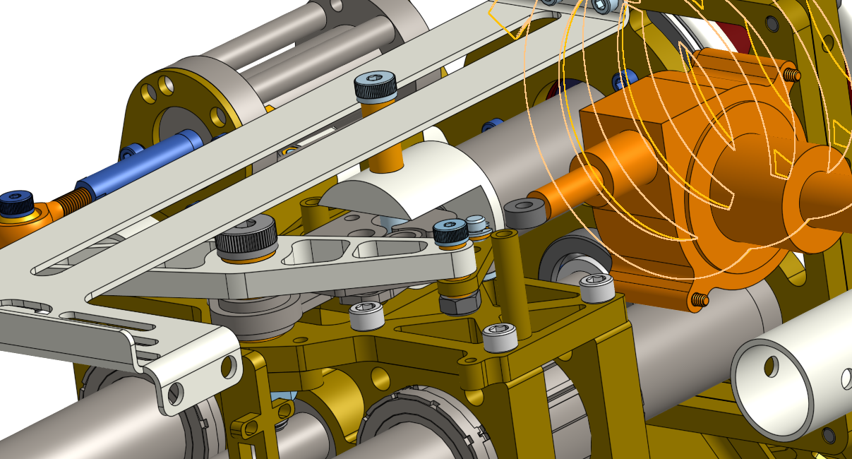

I have been looking at past robots for fun recently and I came across this robot, The one thing that intrigued me was the linear punch and how it was actually actuated. It looks like it might be a ball screw or something along that line but how would that be able to release in such a quick amount of time. If anyone had pictures or explanitions that would be awesome. Thanks!! - Justin

We use Constant force springs for the motion, Chain drive for the retraction and a car door latch for the release. Very similar to a locking elevator from the 2018-2019 games.

How did you relatch the springs so you could pull them back again, was it on a pneumatic and the latch just grabbed a bar or something?
It was a servo powering a latch, we had a 3d printed trigger for the car door latch.

Thank you ill look at it when I can. I understand how the punch part works im just confused about the pull back and release on 118 and I cant tell from their video
I don’t know specifically how 118 did it, but a lot of teams would build shifters into the winch or screw that pulled back their punch, firing by shifting into neutral. This is easier with a ball shifter than a dog shifter, though there are durability and shifting force concerns.

So I figured out I think, they have this locking linkage that is used. I dont fully know what type of linkage this is but its cool. I wonder how strong their spring was.
A Sea Catch over center linkage is used to grab the spring and pull it back, compressing it. The Sea Catch is attached to a carriage driven by a ball screw. A string pot measures the carriage position and allows for varying the shot power. There is a pneumatic cylinder that can be seen in @NustinJewton’s post that releases the Sea Catch. The whole shooter head is mounted on an arm that has a few preset positions that a pneumatic cylinder locks into to control the shot angle. I’m not sure specifically what spring was used but it was several hundred lbs/in.
Thank you that is an awesome answer, Im guessing the over center linkage keeps it from overpowering the lock and coming undone early. It was an awesome bot and I loved the use of the linear punch I got the inspiration to look into it after the last cadathon when someone had a similar design on there robot.
