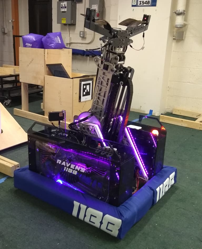

Better late than never: Team 1188, The Ravens from Royal Oak, MI are proud to present our 2023 robot, Eclipse. https://www.youtube.com/watch?v=XmsxBVldG4E
Eclipse features swerve drive, a belt-driven telescoping arm, and a pneumatic pinchyclaw.

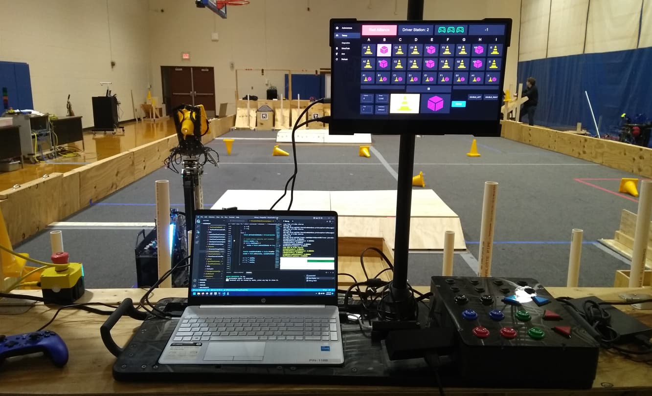

A lot of teams built this same archetype of robot. What makes Eclipse unique is the control scheme. Instead of having high-medium-low setpoints, the operator uses a touchscreen monitor running a custom network tables webapp to specify exactly which node they want to score on. Whenever the driver holds the left trigger on the controller, the robot automatically drives to the correct location on the field. The drive coach simply calls out a node, e.g. “F3”.
Mechanism actuation is handled autonomously based on the robot’s goal and location on the field, which is tracked with Limelights, AprilTags, and PoseEstimators. For example, whenever the robot has a game piece and enters the community (but not while on the charge station), the mechanisms will fire and extend the arm to the proper setpoint for that node. Likewise the arm will go to the proper substation setpoint as soon as the robot enters the loading zone. These can be overridden if auto-actuation would cause a problem.

I’d like to extend a VERY special thank you to team 818, The Steel Armadillos. Not only did they lend us critical spare parts both at our events and between them while our school was closed, but they let us set up shop in their work area for a whole week between events. Without this time we would not have been able to finish the robot. Their full field is incredible and shown in the picture above. Congratulations on your amazing run to the MSC finals and deep into Einstein; you earned it and it was a joy to watch. @rmfreichenbach @NolanV
