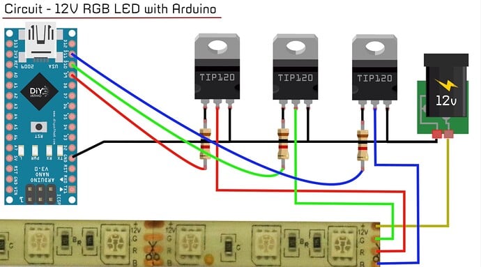

Hi we got the 12v leds from rev recently and they come with 4 cables: one for 12v and 3 for the rgb. We want to connect it to our roborio for control and to our vrm for power how can we do it?

The 12V ones are wired in parallel for R, G, and B, so the entire strip will be one color. You need to have a high current driver like the REV Blinkin to supply enough current for each color.
If you actually want individually addressable LEDs (so you can create patterns by controlling them from the Rio individually, with a single 5V supply), you will need a different strip—while REV is out of stock on those, they are readily available from other sources, search for WS2812 or WS2812B.
To expand on this answer, the LED strip you describe is not really what is commonly called an “addressable” strip.
You have one PWM control line that controls the intensity of all of the red, green, or blue LED elements. You can control the color of the entire strip, but every LED in the strip will be the same color.
As the above circuit diagram shows, these can be tricky to interface with a microcontroller because of the voltage and power mismatch. Your micro needs to be able to sink enough current into a digital pin to light all of the LEDs in the strip, or else you need a transistor or other driver to amplify the digital signal. You also have issues with voltage, because your LEDs want to run at 12V, but your digital GPIO pins want to be at 5V. (The circuit, above, takes care of the voltage mismatch through the driver transistors.)
It is much simpler to use actual addressable LEDs, and then you can run multicolor patterns. These have only 3 connections: ground, power (usually 5V) and data. The data line is a serial connection that can be wired directly to a Roborio GPIO pin, and the power lines connected through an appropriate voltage regulator to your power source. (Note, you also need the voltage regulator for the type of LED strips you already have.)
There is excellent support in WPILib for addressable strips. It should only take your programmers about 20 minutes to have it up and running.
The electrical interfacing is easier, and you get independent control over every LED in the string. I know you already purchased the other type of LED strip, but these strips are relatively inexpensive, and the benefits are great.
