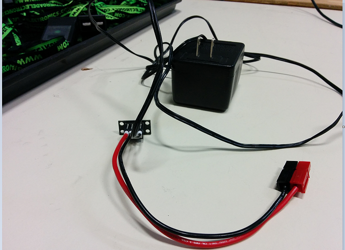

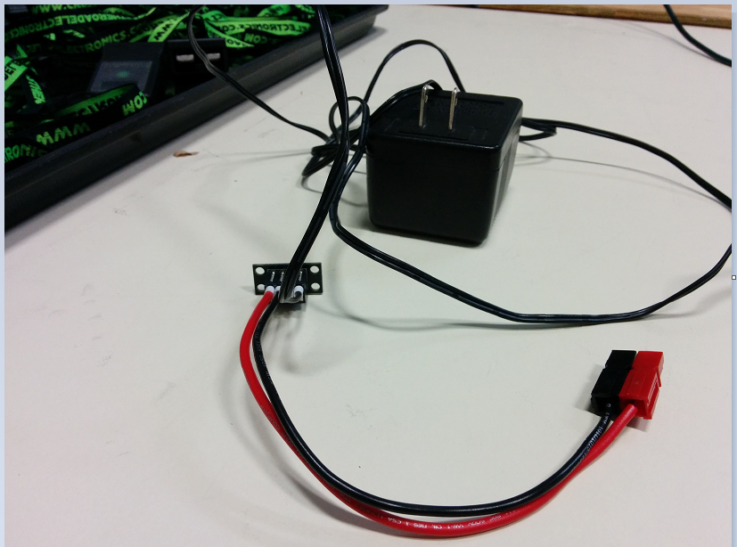

Has anyone ever powered a roboio (or cRio) using a plug-in 12 volt power supply? I was thinking that it would be convenient to power it that way instead of using the battery/PDP when testing out code to drive sensors, arduino, etc (anything with low current requirements).
I picture the 12 volt supply feeding directly into the PDB, or possibly right to the roborio (although that would bypass any over-voltage protection provided by the PDP).
I use a 12v 2A wallwart directly into my roboRIO (but I’m not trying to run anything else). The only protection the PDP provides is a fuse.
We regularly power a robot control system with a 12v linear power supply. The one I have wired to an SB50 connector is capable of only a few amps, so we can’t run any motors, but everything else works okay.
(Trying to use a switching power supply on the older PDB, with its own internal switching power supplies, was not a consistent success.)
I’ve also used a 12v, 2A supply directly wired into the roboRIO. Something like this.
Also have used an old ATX computer power supply with the cRIO and roboRIO with no issues.
In a pinch I used a CAN Connector to connect a 12V wall supply to andersons, and have been using it ever since [hey it works for power too :slight_smile: ]
