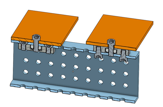

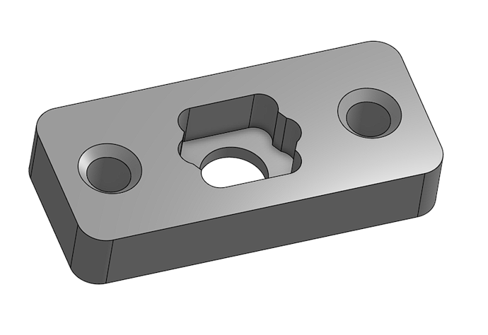

Unfortunately, these were a mid-season upgrade to the robot, so the CAD was “Just good enough”. To help with the explanation, I have made this Part Studio:
We created these aluminum blocks called “Nut Holders” or “Pocket Nut Holders”. They have holes at 0.5" spacing between the 3 holes. For most applications 1" would work better so it aligns with the COTS tubing spacing, but we were space constrained.
The Middle hole has a receptacle for a #10-32 lock nut. The endmill reliefs are selected to allow some lateral motion in the nut to help with assembly tolerances. This was designed to be made with a 1/8" endmill. The outer holes are tapped for #10-32 Screws.

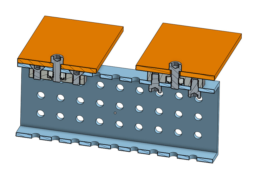

Here is an example in use. There are two basic configurations that may make sense depending on the use-case
The one we use last year was the flush-mount with the plate inside the tubing. This allowed belly plan to sit against the tubing and is more appropriate for high-load instances where a stabilizing effect between the two pieces is important. In this configuration the clamping force does not go through the Pocket Nut Holder, which probably has an advantage on longevity.
The other option is the stand-off configuration where the block is between the tubing and the removable component. This configuration is easier to install. If I were to implement this option, I would probably make the Pocket Nut Holder a touch thicker. (5/16" or 3/6" total thickness rather than 1/4")
In both cases, the threaded portion of the lock nut should point towards the removable component.
We used these for most of the season including a boat-load of offseason events. We had them on the bot for our 2nd event.
-Dan
