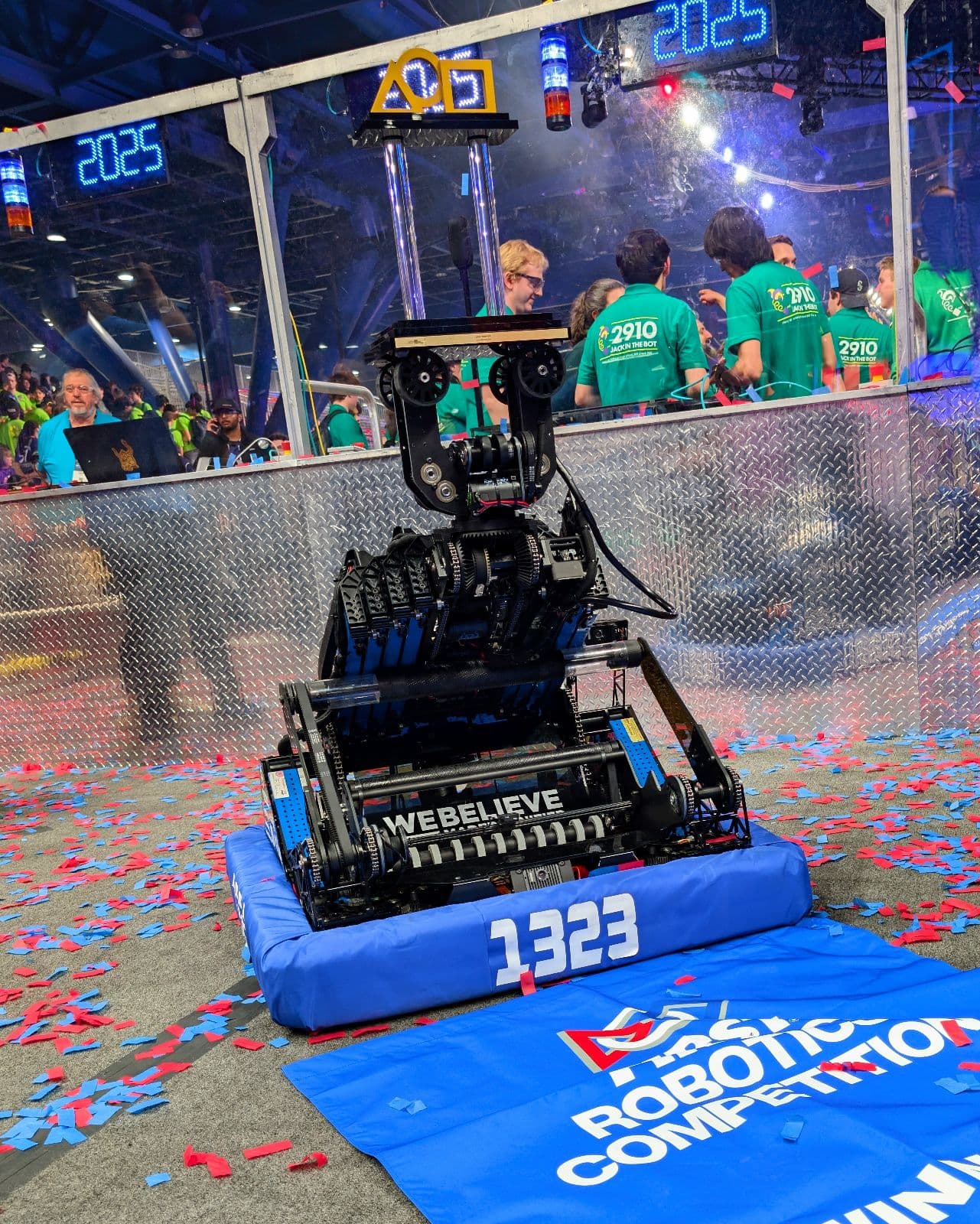

At 28"x28" is this considered your smallest robot?
Every single year, I think my mind can’t be blown again from the amazing work you guys do, and every year you prove me wrong. Congrats on the well deserved win!
I didn’t see a lot about the automation of your bot in the tech binder, can you go into how much of your intake to scoring process for algae and coral is automated?
Amazing robot. Congrats on winning worlds!
Our 2017 was the smallest frame size in most recent years. ~107" frame perimeter vs 112" this year

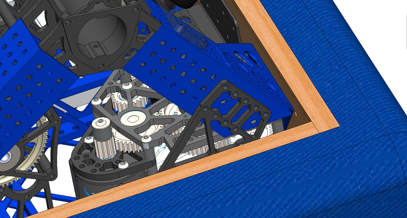

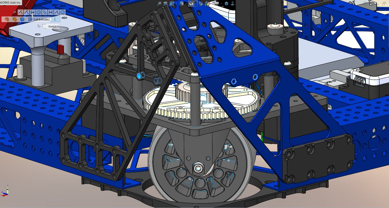

Would it be possible to share a little more what’s going on here? I gather that that’s supporting the A-frame tube, but I can’t tell what’s going on with what appears to be a bent piece in there? Or is that 4 pieces and the internal one is just a nut plate basically?
If those are inside the a-frame tubes, did y’all do anything special to hold it in place? Or did you assemble the a-frame tube to the supports and then attach to the base rails?
Is the blue brace bent? It’s hard to gauge the thickness, but from the tech binder, all those plates look 1/4" to me
The practice robot was fully printed in PETG HF on the bambu printers. The competition robot is fully onyx on the markforged.
Hoping this image helps the black large plate is 3/16" AL with custom made nut plates that go inside of the 2x2" structure box tube. The outside blue bent plate is .090" AL.
We’ve copied 4414 and now use the top portion of the swerve plate for structure. The 4 highlighted holes were bolted to a nut strip that was bolted to the swerve plate. Also the team recently picked up at a Titan 25T brake press after following along Spectrum’s journey. But the better place to get bent parts IMHO is always fabworks.com
This image should give a better picture of the thing assembled.
