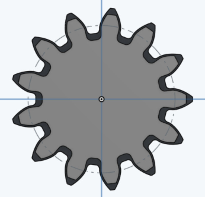

It’s the 13T that uses profile shifting. In the image below, the gray profile is standard 13T 20DP 14.5 deg PA. The black profile is the 217-6921 13T with 14T c-c spacing.
They aren’t the same. The pitch-shifted 13T can be dropped in to an existing gearbox designed for a 14T pinion and instantly get about 7% additional gear reduction. Maybe you thought you wanted that L3 ratio SDS swerve module, but it turns out to be too hot. Swapping in the pitch-shifted 13T pinion drops you back close to the L2 gearing with just one gear replacement rather than two.

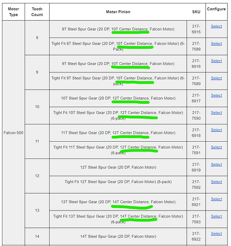

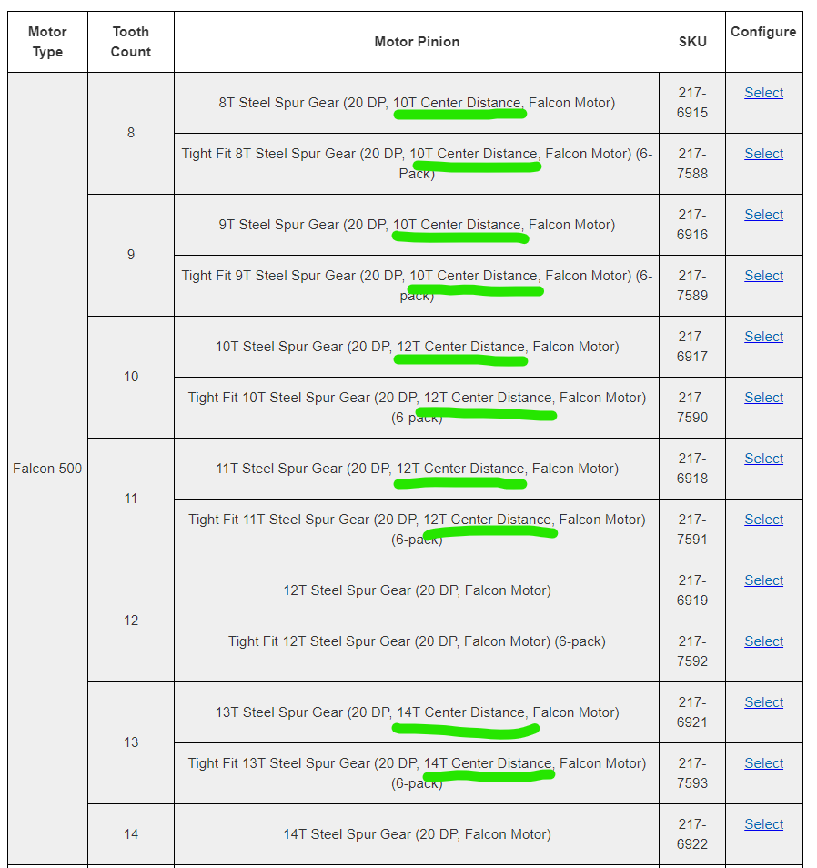

Also for reference the 8T, 9T, 10T, 11T, and 13T are all shifted so make sure you pay attention to the table on Vex/WCP’s site!

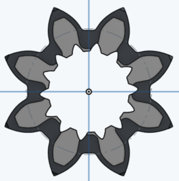

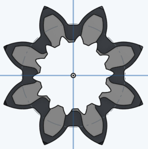

Here is an image of an 8T 20DP pinion with 10T pitch diameter (black profile) compared to a what would be a standard 8T 20DP pinion if it could handle the size of the motor shaft (gray profile).
Making the pitch shifted 8T gives you all the reduction goodness of the 8T, but it can fit on a Falcon spline. Also, look at how beefy the pitch shifted teeth are. All the undercut is gone. Those pitch-shifted teeth should be much more robust.
