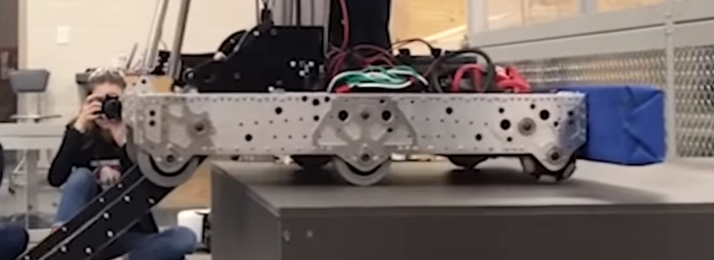

I want to say 4’’ westcoast front omni, just guessing but it appears that way
West coast drive is characterized by having cantilevered wheels. That photo shows a traditional tank drive.

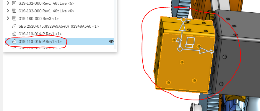

In your drive train there is a block (G19-110-015-P Rev1) that appears to be used to mount the different parts of the drive train together. What is the material that you used to make this? Are the holes threaded?

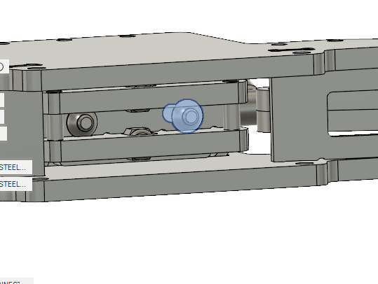

I was taking a look at the CAD for your hatch panel mech, and I saw you have, what I assume to be based off numbering, a 10-32 half inch long bolt going into the shaft of the piston. How does this work, I don’t see how you can make that connection. image
Also on this, how do you keep your pivot shafts on this mech from just falling out?
Thanks
Ian Jensen
If you take a look through the documents for the VexPro 1/2’’ stroke 3/4" bore air cylinder (commonly used for drivetrain gearbox shifting) or have one in your hand, you might notice that the 10-32 thread is a short threaded rod, and the end of the piston rod is actually female threaded for a 10-32 screw. It’s a bit of a pain to actually get that threaded rod out sometimes, but it lets you do neat stuff like this.
