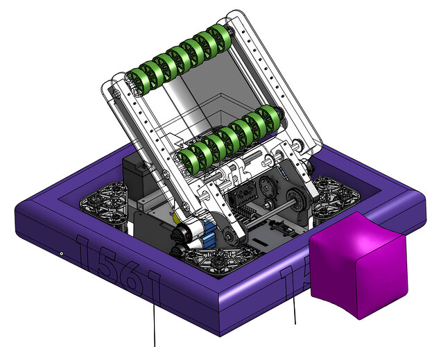

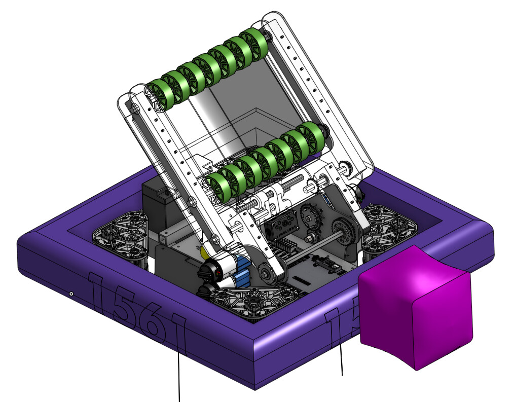

We knew we wanted to be low to the ground so we could make fast cycles. This lead us to a pivoting arm with a shooter/intake. We were not able to CAD it in time so the entire robot was jankily put together in 2 long nights. We scrapped the tower and only used the drivetrain from Arkansas.
Duck N’ Cover
|720px;x540px;
Using a peice of poly carb and two aluminum rods, we were able to make the bulk of our shooter arm. Falcons were attached directly to the shooter and everything was manually driven with joysticks. The robot had issues with popping cubes and breaking chain. This gave us a lot of tech fowls that hurt us in alliance selection.

Now with much more time, a viable strategy, and a working prototype, we got to work on making a final design that would hopefully take us to worlds. This robot would be very similar to week 2 but with more refinement and a smaller drivebase. Even with all this time, we still had to rush coding in the end and we weren’t able to get any driver practice. Luckily, we were able to go into Tulsa with a working balance auto (finally) and preset positions for our arm. This would hopefully increase our reliability and speed.
With pre-scouting from our team, we were very nervous going into the competition. Previous winners 4613, 1339, and 6424 would all be at the event and were fierce competitors.
Duck N’ Cover V2
|540px;x540px;
Version two of our cube design proved very reliable. We ended up ranking 2nd at Tulsa which is the highest rank our team has ever acheived. We were happy with our rank and decided that any of the top three alliance partners would give us a good chance at winning the competition. 4613 had incredible speed and cycle times, 1339 had an amazing auto and amazing precision and 6424 never seemed to miss and was incredibly reliable at getting cone after cone.

What gear ratios are you using for the falcons in the intake and in the arm?
Thanks
I believe that the arm is a 20:1 Andy mark gear box and the shooter is very close to 1:1 but @1561Mentor would know for sure.
Thank you
First thing first, I love your robot design (especially “cannon mode”). We are making another robot for an off season event which is slightly inspired by your cube shooter bot. I was wondering how you guys were able to zip down the field so fast (11 cycles!). Do you guys use a L3 gear ratio for your swerve drive or did you attempt to make your bot as light as possible? Thanks again!
We used L2 SDS Mk4i modules. We thought about using L3s but it wasn’t feasible for the time we had in the season.
The reason we were able to accelerate so quickly is because our robot weighed around 85lbs with battery and bumpers included. This extremely light design made is incredibly fun to drive. Surprisingly, defense wasn’t hindered too much except with the extremely heavy robots. Look to our game when we played 2056- they have an incredibly talented driver that was able to knock our robot around a lot.
