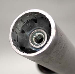

Love the robot this year - I noticed you’re using round tube on your wrist but I can’t see how you connect it to the plates it’s mounted to. Do you use some sort of plug?
Thank you! We use tube connecting nuts from mcmaster that push into the tube and have a threaded inner part, allowing us to send a bolt throught the outside plates. Here’s the part link: https://www.mcmaster.com/94290A550

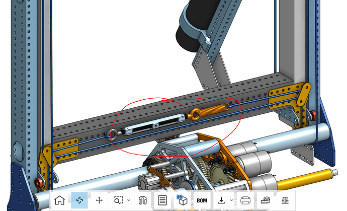

Nice robot! Is this part to tension the rope?

Yes, that is correct. The looped bolts that the string connects to thread in from either side.

Thank you for the response. I’m still slightly confused on how these parts are used. Do you cap the flower-part on both ends of the tube? I feel like that doesn’t make sense given the length of the part. I fear I may be missing something.
What type of string?

There is one of the nuts on either side of the tube, yes. They sit about a half inch in from each end of the tube.
We use spectra cable for the elevator. It’s actually a type of fishing cable, but it has worked great for us!

Here is a picture of them installed.

We use 94290A550 a lot since we got a lot of 1" thin wall tube donated and love em. They grip really well in aluminum tube and haven’t had one slip or come loose even when cranking down the fastener.
