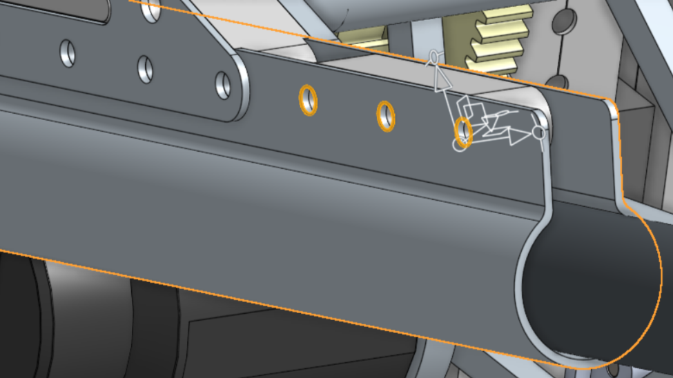

Can you explain your dead axle setup for the intake rollers? As far as I understand, you used square nuts to connect the rollers to the printed pulleys. On your BtB video, I am seeing regular bolts that go into the side plates. Were these bolts going into a bearing then got connected to a long spacer that went left to right? If there was a spacer as I assumed, what was your order of assembly, and how did you prevent friction between the spacer and the printed parts? If my assumptions were all wrong, how did you fasten the intake rollers to your side plates? Great bot all around as always!

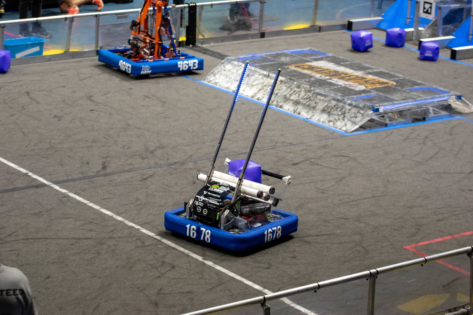

Were there pictures taken of the broken intakes during champs?
It’s crazy when Citrus can score more game pieces (8) with a broken intake than most of the teams in your state (Indiana) can fully functional.
Galileo Finals 2
Like seriously. What’s going on in the drive team’s heads?
Broken intake, big deal!
There was 0 hesitation to move from point of contact to substation.

I haven’t inspected the CAD myself but I wouldn’t be surprised if it’s the same deadaxle method that we did last year and BJC talked about here.
Other than your needed assembly order, I am a big fan of it. Nice solution.
You assemble the printed pulley with the deadaxle spacer shaft and bearings onto the polycarb sideplate with screw+locknut. Do the same with a hub on the other side. Bend the polycarb plates apart and slip the tube over the pulley and hub. The flexibility of the polycarb plate is what enables assembling them and swapping rollers without needing to unmount the plates themselves.
