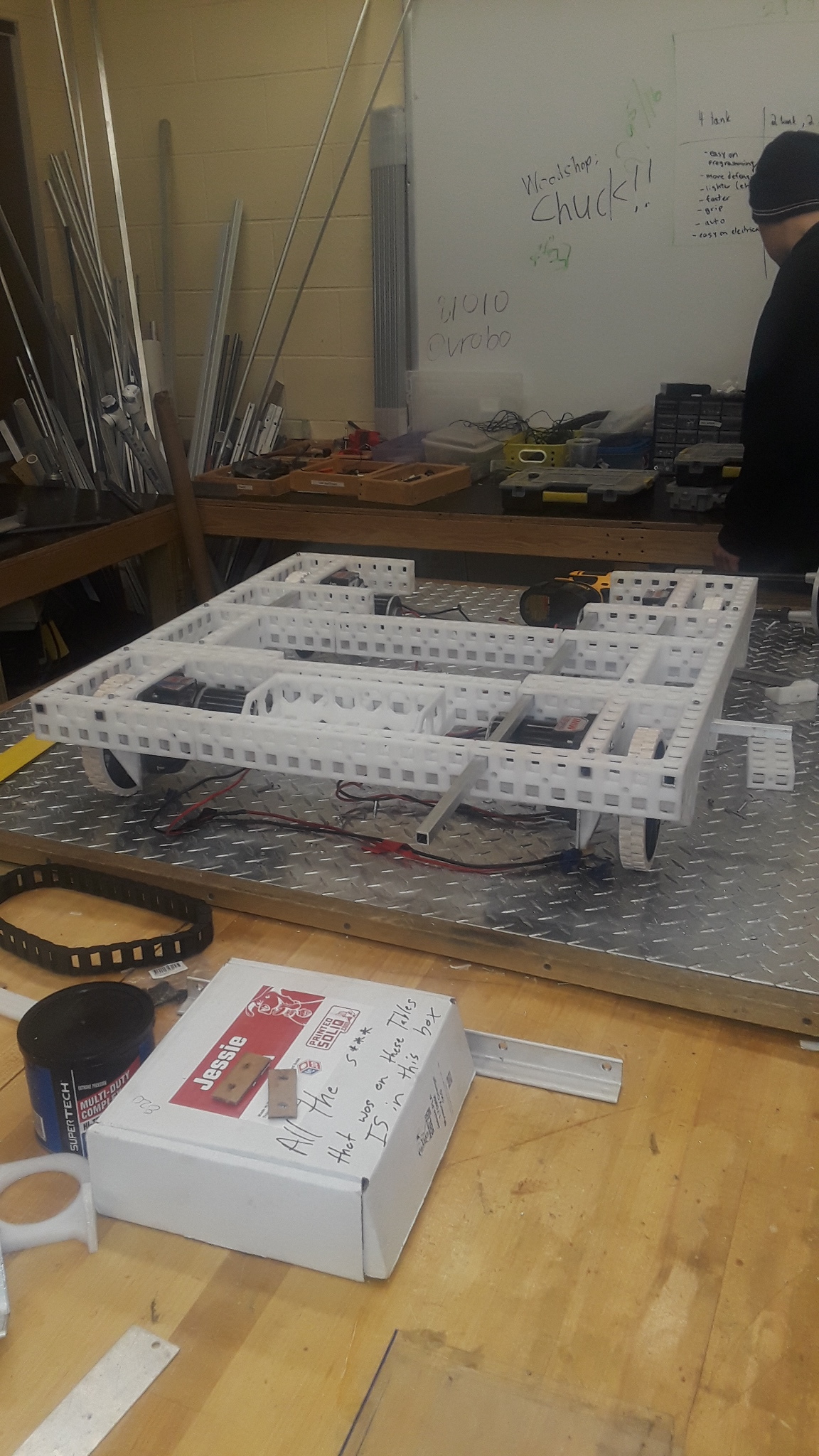

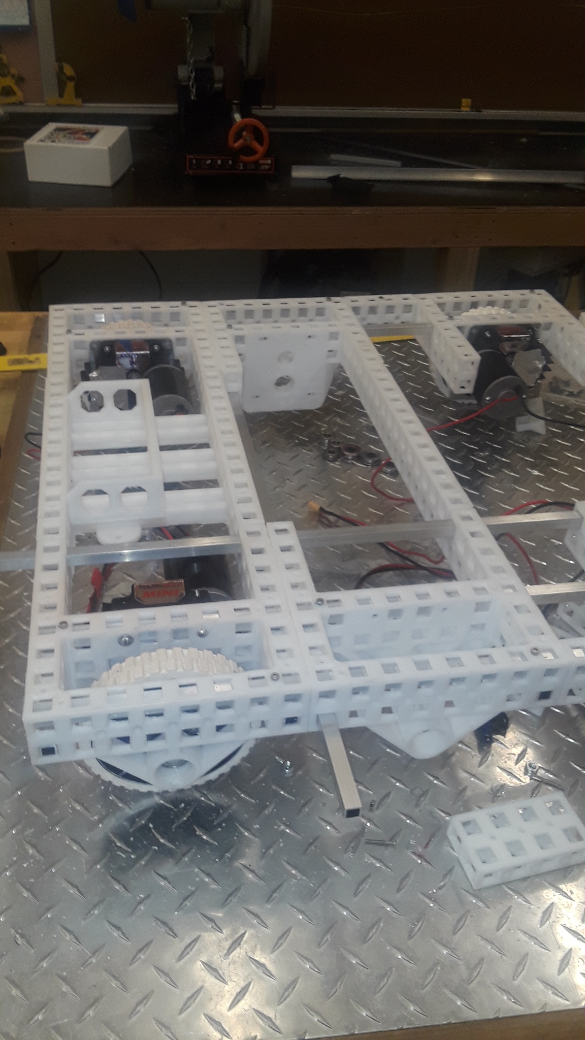

Frame overview
Rear with Battery Holder in center. The things that look like there could be wheel 5 and 6 be mounted will get a toughbox mini with a winch to lift us up

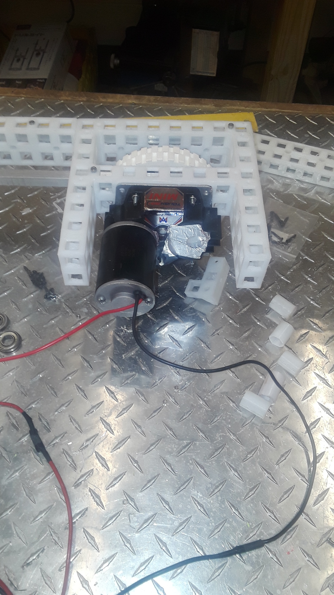

Closer view of toughbox mini with mini Cim and wheel mount
Frame dimensions 29.46x29.46 in. The square holes hold some 1/2in 16 gauge square aluminum tubing. Its held in place to the frame with 8-32 bolts and lock nuts. All Inventor and STL files at
Are the KOP wheels going to be switched to mecanum wheels?
Right now the team wants tank drive. But the holders will fit Mecanum too and omnis will fit too it just takes the 4 bolts of the toughbox mini to pull the wheel off and put another one in so that is something that could be done between matches if we wanted too. (of course with the necessary change in code)
Sorry for asking so many questions but how much does that weigh with wheels and gearboxes?
Can you elaborate / explain the construction technique here? What is the white boxy stuff? Why is it boxes not triangles? Is the intent to reinforce it with aluminum box tube inside? If so what does the white framing accomplish?
No problem we did not weigh it with wheels and gearboxes yet Without wheels and gearboxes it weighs 9 lb about 6.5 lb of plastic the rest is the 1/2in aluminum tubing. We went to the 1/2in 16 gauge square cause its much stiffer than a hex churro and much lighter and its easier to mount it the COP Wheels are 0.6lb so add 2.5 that makes 11.5 4 mini CIM are about 8 lb so that makes 19 and I have no idea what a toughbox mini weighs but I guess 2-3 lb so probably close to 30ish lb
Why not 3d printed wheels.
The white boxy stuff is HIPS Plastic its 3d Printed. Its boxy cause it gets 1 square tube shoved into it. So now you have a compound plastic/aluminum frame the reason we did it is cause we have 3d printers not much else but hand tools. 3DP is accurate and tough if done right. The aluminum is there to reinforce and cut down printing time You are looking at about 60-70 hours printing time (we got 2 printers) so you can print it in about 2 days (or longer or shorter depending how many printers you have)

Looking at this model, it looks like you’re planning on driving with 6 CIMs, each with their own separate gearbox. Is that right?
Are your wheels not chained together? If you get in a pushing match and one side of your drivetrain lifts off the ground, you’re essentially losing half of your drivetrain power, making you extremely susceptible to being pushed and not making you a very efficient defender.
It was considered. But this way we can mount something pretty much anywhere and right now the printing is not the bottle neck the bottle neck is the “comitte meetings” with the team trying to make up their mind how to make the shooter etc
No it always was intended 4 wheels Version one had a straight piece in where gearbox 5 and 6 mounts are then it was decided to make 2 winches so we can shift the center of gravity to balance the beam so as we have already printed spares it was found that we could 3DP a winch that fits into the wheel holder and use one of those so we pulled the frame apart and put those gearbox holders in and the winch/climber mount is going to get done as soon as my designers finish the mono-myth paper and get back onto inventor
Instead of being chained together we opted to give each wheel its own motor. even with them being chained if one side lifts up you loose that side. Now one mini cim with a wheel has enough torque that the wheel will spin out before the motor will get in a range where it pops a fuse So each wheel touching the ground will always have more potential power than it can need. IOW the limited factor will be the grip the wheel has on the floor
