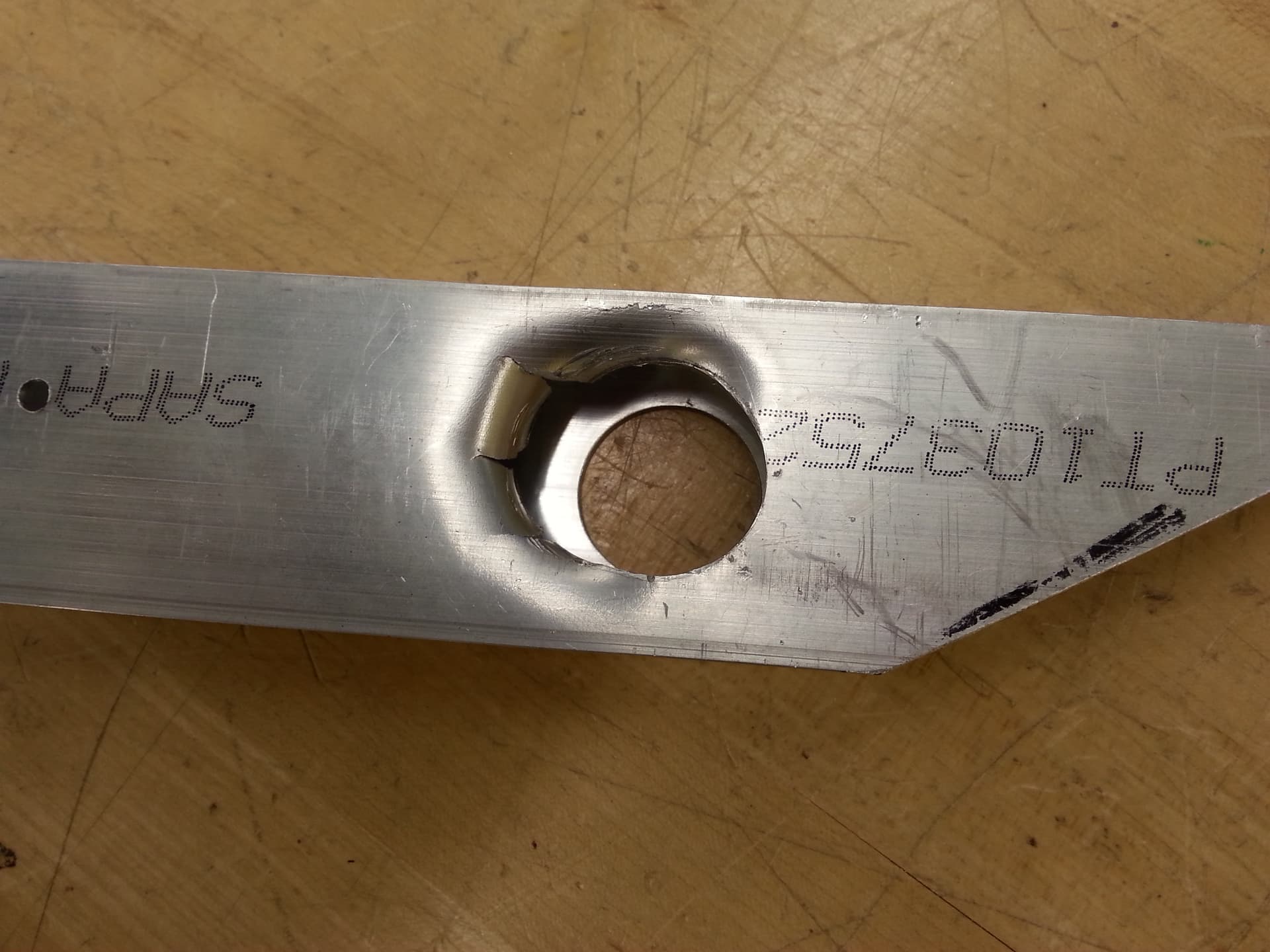

Here is an example of what can happen to 1.6mm wall 6061-T6 tubing in a robot drive base:
what caused that? Looks like that hole was used as a bearing seat maybe, which isn’t relevant to my use case with the SDS modules.
It’s relevant to any drive base taking a hard hit, which is what tore the shaft out of the tube.
The failure occurred during the semi-finals of our first event of 2016. The same robot made it through 4 more events with the only change being swapping out the 0.062" wall thickness longitudinal frame rails for 0.125" wall thickness tube of the same alloy.
It’s your robot. Do you feel lucky?
