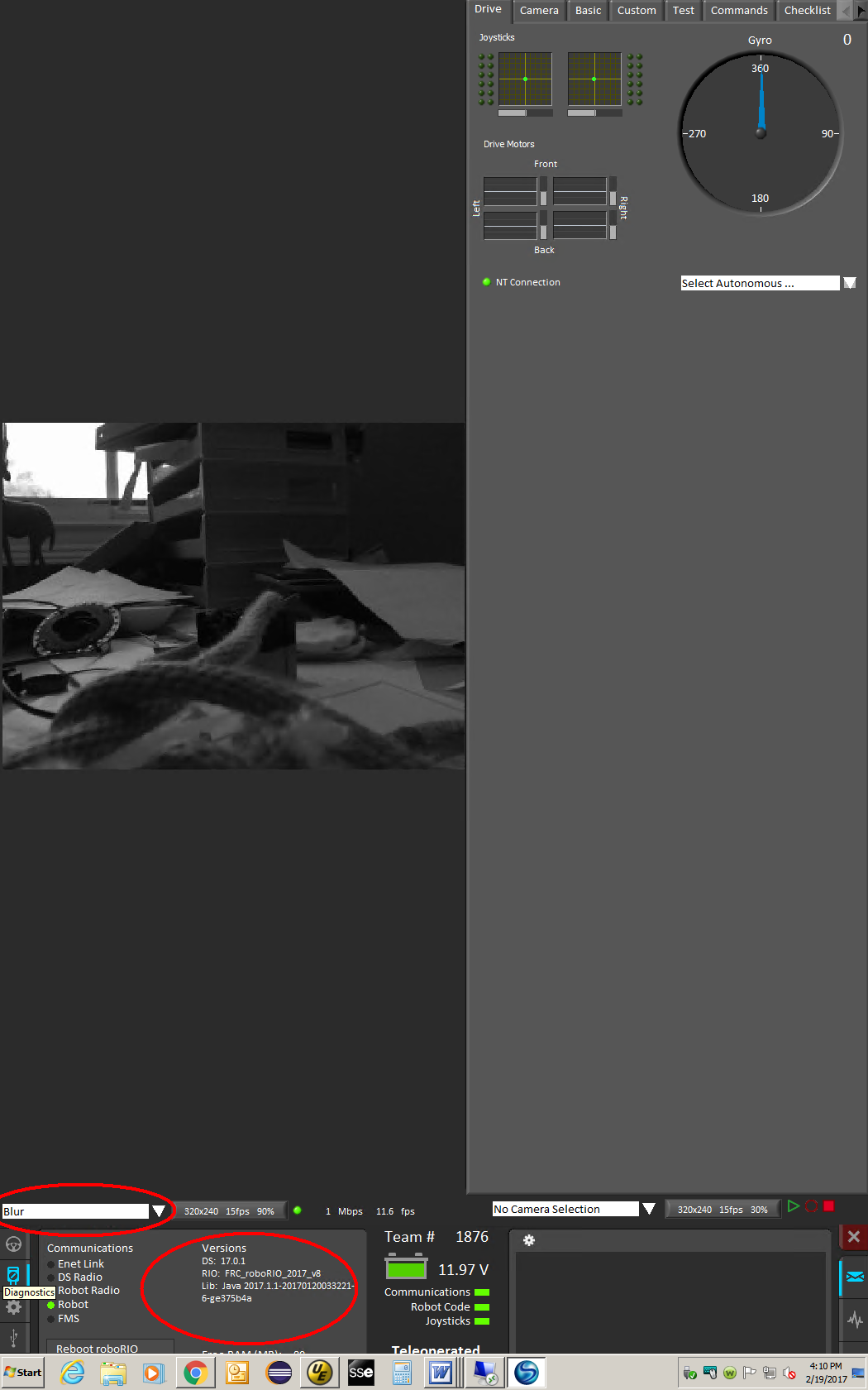

I downloaded the most recent WPILib library (2017.3.1), and the vision test sample no longer works. I rolled back the version, and it works. I have not been able to get any code using Sink/Source combination to work with the new Libraries, but they all work fine with the old. I am stumped, and if anyone notices something in the screen captures that would be appreciated:
Test Code (as deployed, based on sample posted)
http://wpilib.screenstepslive.com/s/4485/m/24194/l/669166-using-the-camera-server-on-the-roborio-2017
Works fine (displays gray scale image) under 2017.1.1, but not 2017.3.1 Screen captures attached.

Found the problem. In the sample code, the following line will sometimes return an empty image. Adding a check corrects the problem (this only seems to affect library 2017.3.1
//From the sample code
//Note that source may be empty
cvSink.grabFrame(source);
//Add this line to prevent exception errors:
if (source.empty()) continue;
cvSink.grabFrame was changed in this release to time out if there is no frame in 225ms. There is another version of the function called: grabFrameNoTimeout that has the old behavior. It sounds like that’s what your seeing.
See the release notes here:
http://wpilib.screenstepslive.com/s/4485/m/13503/l/685689-issues-and-faqs-for-2017
Huge thanks, Brad, that explains the issue I am currently seeing.
