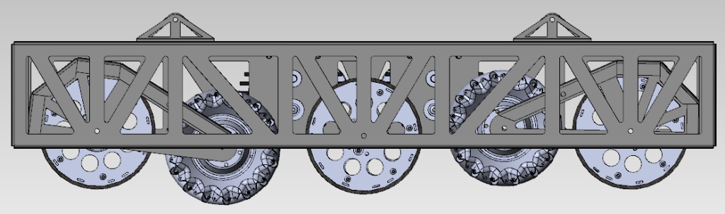

I have been making chassis this year for my team alot. These are my 6th and 7th chassis’s i have designed.
First Chassis (6th)
  • 1/8 aluminum sheet metal
  • tank drive 6in IFI wheels
  • Andymark 2nd Gen 2 speed transmissions
  • Flanges on the side are 0.75in
  • ~30 lbs without electrical components
Second Chassis (7th)
  • Tank Drive 6in IFI Wheels
  • Mecanum drive 6in Wheels
  • Pneumatic pistons to change drive (tank drive/mecanum drive)
  • 4 Toughbox Mini’s
  • flanges on side are 0.75in
    Note: I still need to insert Pneumatic Pistons on second chassis
