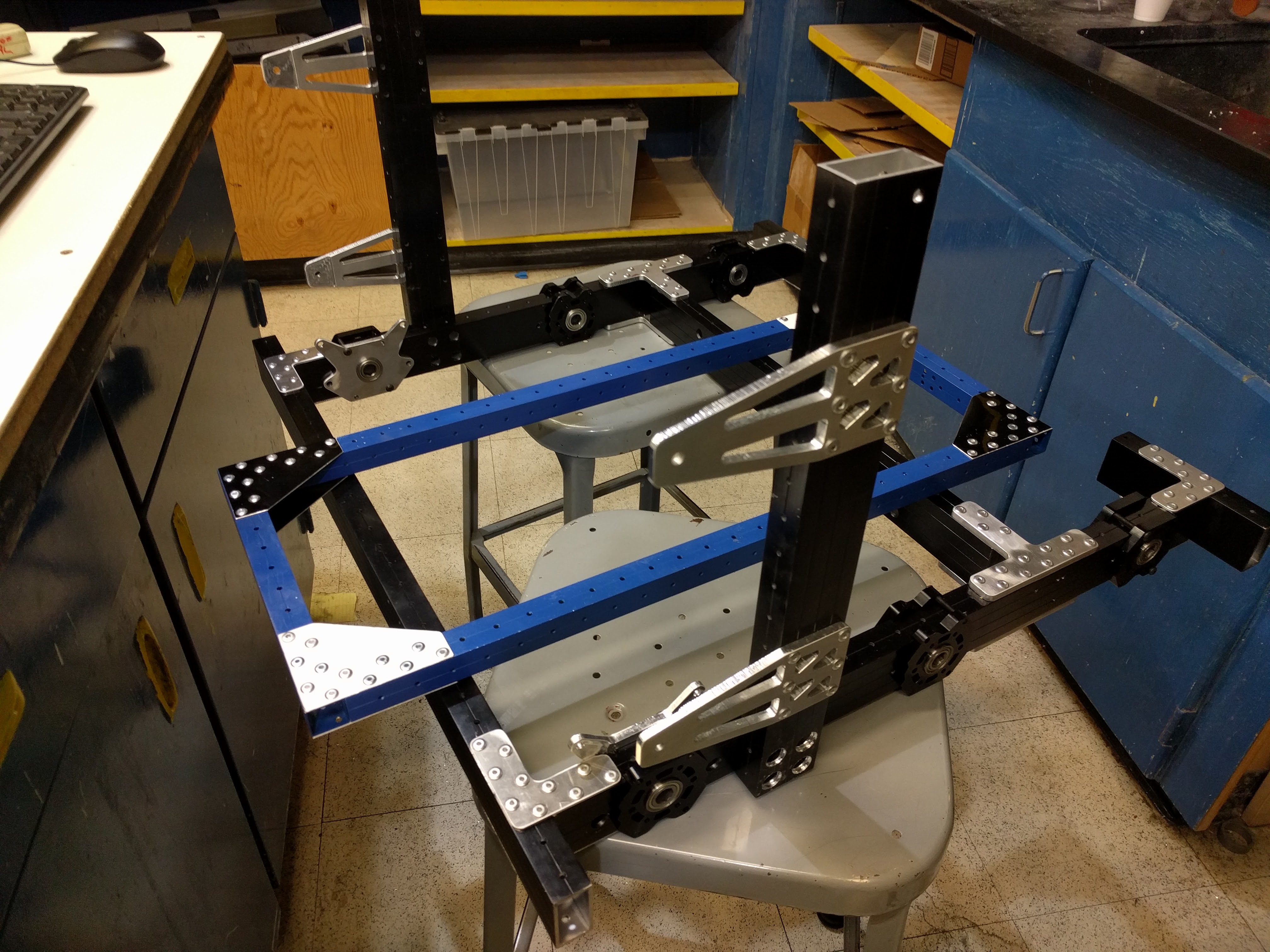

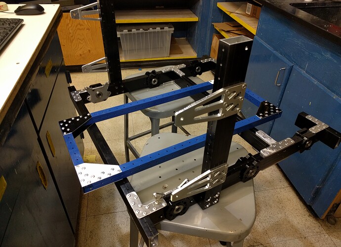

We used these in 2017, and took the “make a complex part” route. We built a bracket that interfaces with the versablocks and has moved standoff locations. We ended up drilling two holes in the plastic case for two of the new standoffs. It worked fine. We used the 2CIM gearbox instead of the 3CIM gearbox because of the odd size rules in 2017, I’d prefer to use the 3CIM gearbox with just 2 CIMs mounted, it’s easier to interface to.

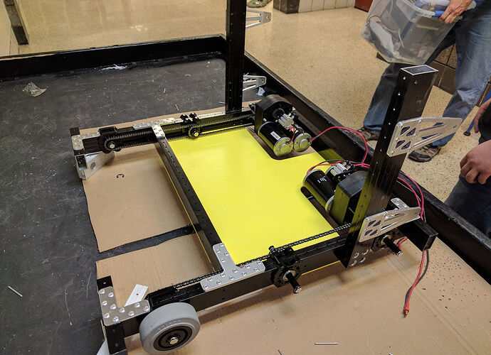

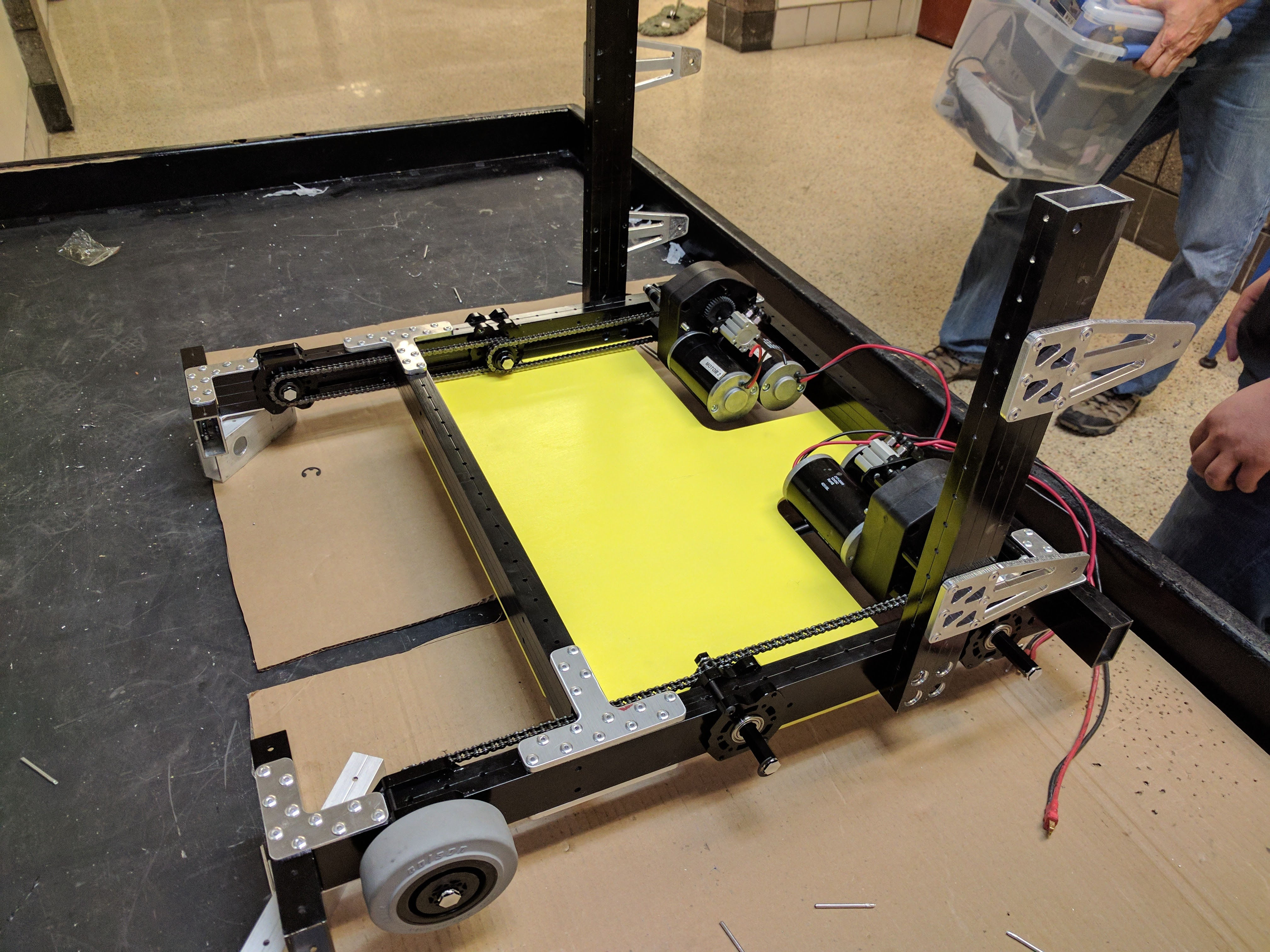

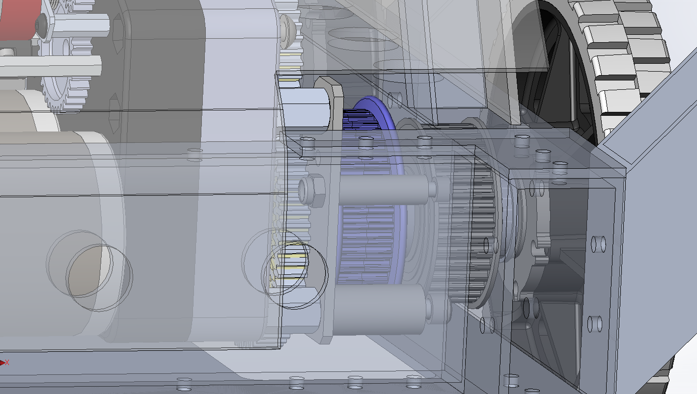

What we did is cantilever the whole gearbox, off the third stage plate, to make room for our pulley and the other pulley is in the tube for the far front wheel. It was really simple, but the only problem we ran into the whole season with the set-up was putting the gearbox assemblies in the robot because the thing was so long, the motors had about 2-3 inches in between them.
Also, if you want to look closer, here is the GrabCAD link to the whole robot CAD.
Edit: Second attachment shows what holes we used to mount it. The bottom bolts just tap into the hex shaft spacer.
