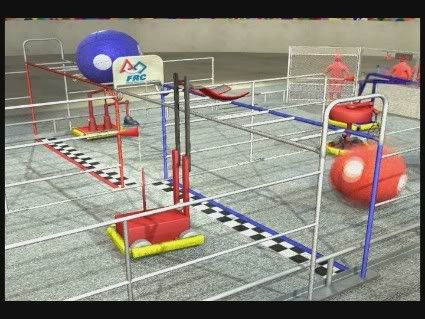

http://img.photobucket.com/albums/v291/matthew2c4u/OverdriveLrg_1__0002.jpg
Enjoy!
These are the stills of the rule being broken in the animation which violates G20<>G36
http://img.photobucket.com/albums/v291/matthew2c4u/OverdriveLrg_0001.jpg
http://img.photobucket.com/albums/v291/matthew2c4u/OverdriveLrg_1__0001.jpg
but why would they violate the rules in the animation.
Because im thinking, the rule is not valid or the data from the animation was not valid:eek:
<G36> HOME STRETCH Height Restriction – ROBOTS in the HOME STRETCH of the opposing ALLIANCE can not be more than 6 feet tall. A PENALTY will be assigned for each infraction.
Because the red forklift bot is above the 6ft limit in the opponent’s home stretch (the quarter of the arena right before the finish lines).
I think he was refering to the fact of why did they mess up (did they?) in the animation, and not how did they mess up in the animation.
