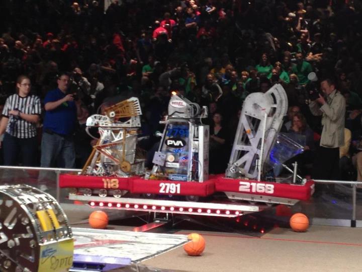

I have uploaded a photo of us (447) stacked triple balancing. Not demonstrated in the photo is the ability to overhang. No stinger or brakes, but we do also have auto-balance unfortunately there is not anyway to reference these attributes so I guess we are:
447 …Long…Overhang…stacker…autobalance
We never have officially measured our overhang at competition. On the practice field we have measured overhang in excess of 12 inches depending on the weight distribution of the two other robots we placed on the ramp. Here is a picture of our overhang at the Hartford, CT regional earlier this year.
