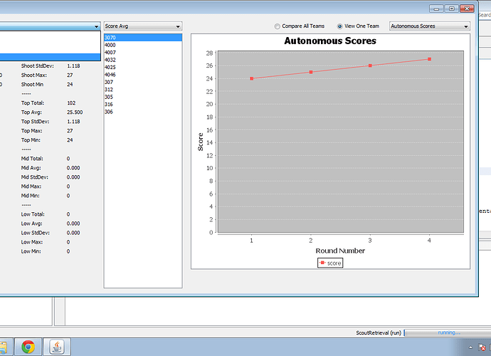

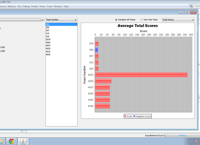

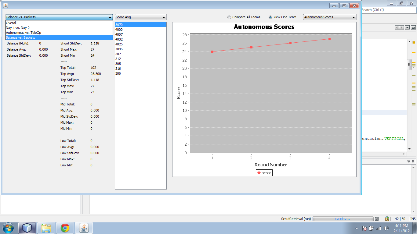

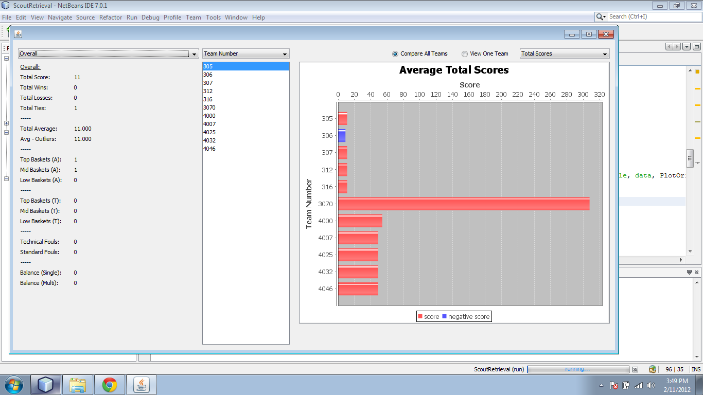

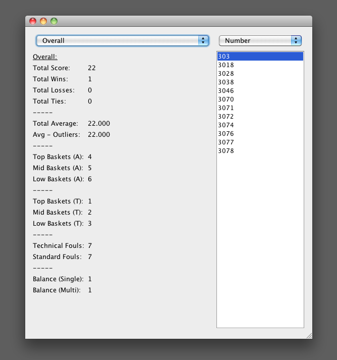

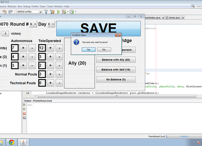

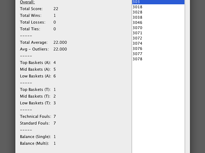

We made a program for this. Attached screenshot.
Left dropdown box for allowing comparison of a team’s autonomous vs. teleop / day 1 vs. day 2 / balance vs. shooting statistics. Right dropdown box allows sorting teams by 1 of the 23 possible options that we’ve implemented (Best middle basket shooter, best single balancer, most average points, most consistent team, best autonomous mode scorer…etc)
The current version (not on my computer) also has a grapher on the right that compares all the teams OR graphs a specific team’s performance (also, another dropdown box to select from a number of options to compare by).
There will be a team of scouts (aka freshman and sophomores) going around and recording this stuff at the match. The recording sheet is very subjective and only about match data (which basket scored in which mode, total score, balancing…etc). (Our team’s scouts subscribe to the belief that performance is key; a good looking robot in the pits =/= a good looking robot in the arena)
May release before competitions when we clean it up.

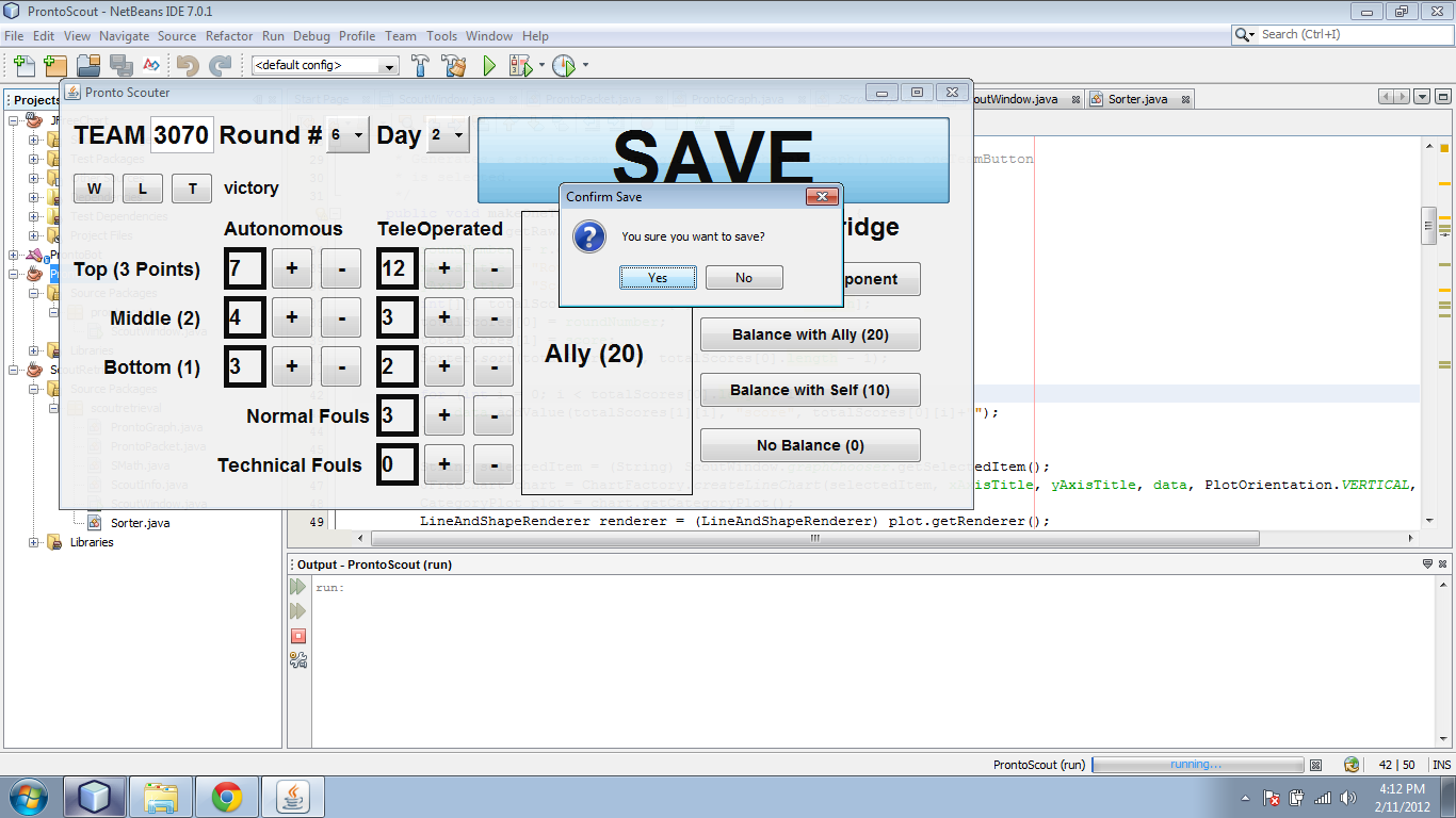

Attached is latest version working on Windows 7. We’re still working on cleaning it up. 3rd attachment shows the input form. I hope no one here is on team 306… :smiley: No offense intended, it’s just bogus data.
Yes. It doesn’t use any platform-specific calls.
See, we have 6+ people watching each game and it will be fairly easy for them to record the baskets scored with our scouting program. It’s not like they’re going to be doing anything more important anyway.
Also, if you just calculated points, you would have to make the scouts do “*3” and “*2” or “*3+3” for baskets scored in upper baskets or in autonomous. Much easier if they can just click a button.
