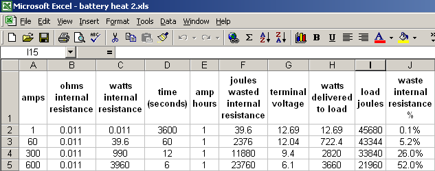

I guess I still don’t fully understand why we wouldn’t be able to easily calculate Eavailable assuming we account for the internal resistance of the battery. We should be able to integrate the power over time to get the energy. Something like Eavailable(t) = Emax-(time integral of (V(t’)I(t’) + I(t’)^2Rinternal) from t’=0 through t’=t) where V(t) is the terminal voltage of the battery at time t, I(t) is the current supplied by the battery at time t, and Rinternal is the internal resistance of the battery.
This should be all we need to calculate Eavailable, since the initial energy of the battery either has to turn into electric energy that moves through the circuit or turn into heat due to the internal resistance of the battery. I don’t see anywhere else that the energy of the battery can go. The only thing I might not be considering here would be that Rinternal might not be a constant, but a function of current and/or temperature. Does anyone know if this is the case? Because if so, that could explain why the battery loses charge more quickly than expected at higher currents.
Check out the datasheet. The capacity of the battery is much different when the current is different. The battery is rated for 18 amp hours, which it can achieve when used in low current situations, but when used in FRC situations, the capacity is likely closer to 7 amp hours.
I don’t know exactly why this is true, but I’d be willing to bet that the chemical reaction isn’t quite as effective/efficient when it happens really quickly.
I have looked at the datasheet, and I can see that the capacity is different, but I can’t think of a good reason for this besides internal resistance of the battery. A fully charged battery has some energy associated with it, and a discharged battery has some energy associated with it. No matter how you get from this charged state to the discharged state, the energy change must be the same, correct? As far as I can tell, this energy can only turn into either heat or electrical energy.
You are correct. When the battery goes from charged to discharged slowly, most of the energy is released as electricity, and a small part is released as heat. When the battery is discharged quickly, a much larger part is released as heat.
*Using a simple model of the battery as a fixed internal resistance of 0.011 ohms in series with a constant 12.7v voltage source, it’s straightforward to compare the energy wasted across the internal resistance for the same ampere-hours at different currents.
But it’s even worse than that. A close look at the battery discharge curves suggests that the internal resistance is not constant, but rather increases substantially with current.
battery_wasted_energy.xls (14.5 KB)
Remember that the battery resistance is a simplistic model of complex chemical reactions in the battery. It is a measure of the battery to pass current, not necessarily the number of electrons in the battery.
