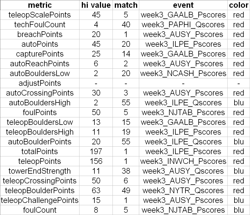

EDIT: attached is a compilation of hi component scores for week3.

In the high scores for towerEndStrength, the smallest number might be more interesting then the largest, which is just who got the most technical fouls without weakening the tower. It would also be interesting to see how many times a high score was acheived. For example, breach of 20 and capture of 25 has probably been obtained hundreds, while teleopBoulder points of 76 has probably only happened once.
Thanks Joe. Done. (revA posted)
