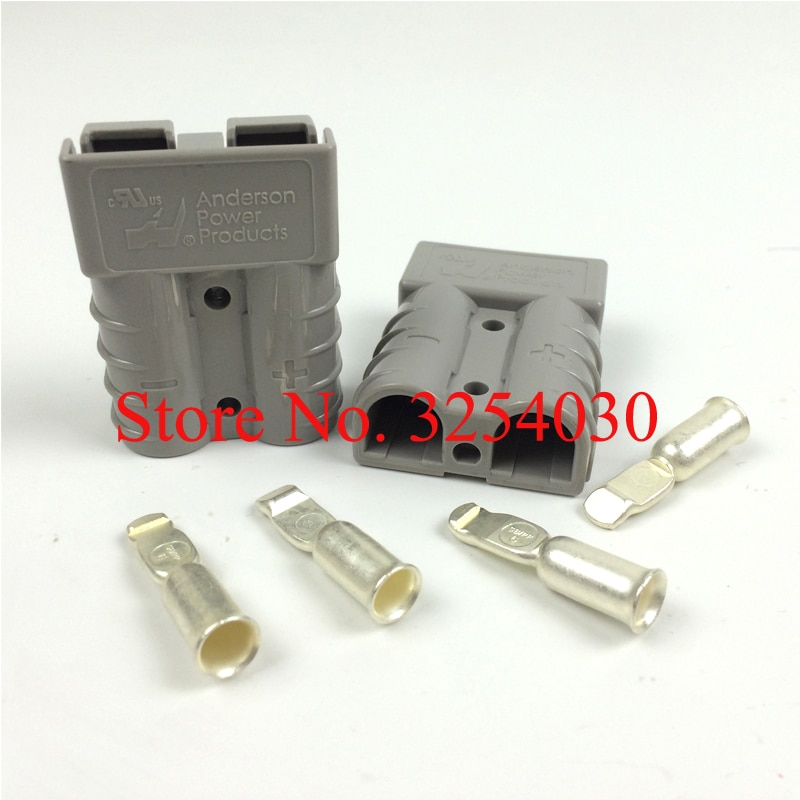

There are, as far as I’ve seen, gray and pink connectors (which don’t connect to eachother, so we’ve been using a “dongle” of sorts).
Here are the “old” ones:

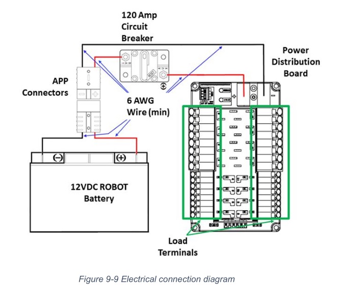

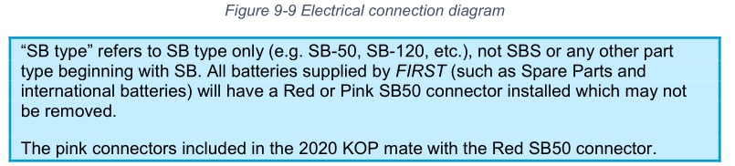

They are all the same connector standard, but different colors (generally) aren’t supposed to fit together (I think pink and red do). They are all acceptable, but it is advised to use pink or red ones because they will be compatible with what everyone else uses. The grey ones should be legal though.

Oops, I should have included the blue box! There does not seem to be any rule preventing you using the grey connectors, but if you need to borrow a battery from another team, or Spare Parts, it could be inconvenient.
Where have you been using this dongle? If it’s on the robot, then you’ve got a problem, as your power pathway wouldn’t match the picture @MrForbes posted - you can only have a single pair of Anderson Connectors as shown in the picture. Having a dongle to convert from an SB120 to an SB50, or between two different styles of SB50 would not be legal.
As @Joh_Stratis said, you can’t use the dongle on the robot, but you also can’t use it on the battery (which is part of the robot when installed), and you can’t use it on your charger either due to R34. You’re ok for practice, but you need to get your robot, batteries, and charger all on the same size/color SB connector before your first competition.
