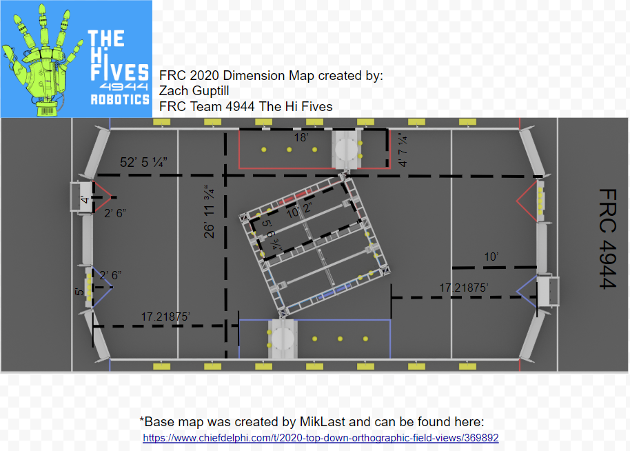

In looking for dimensions of the 2020 field and the sections encompassed on the map, I discovered there was no full field drawing with dimensions within the manual. In order to solve this problem I created the following FRC 2020 map with dimensions of major points on the field. I am open to suggestions as to how I could improve this map.
Here is a Link to The file within a google drive: [FRC 2020 Field Map - Google Drawings]
Final Field Map|690x493
The Base Map I used was created by MikLast and can be found Here
Not all Lines are straight/ square with the field due to my limits when making this map however all the dimensions are correct to the manual
