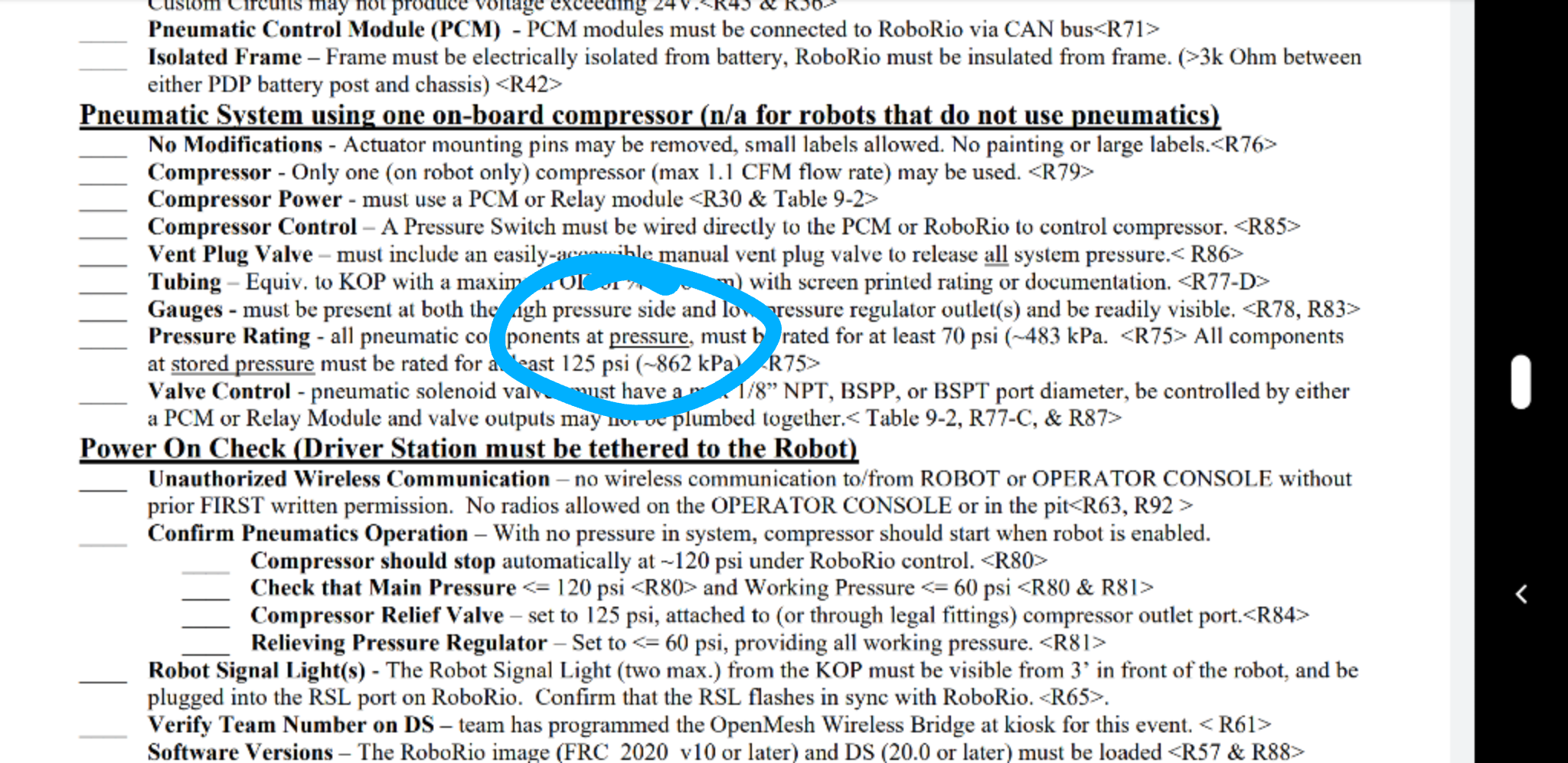

Should be “working pressure”

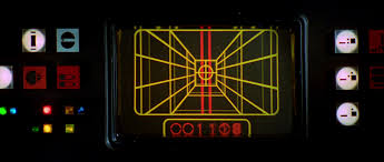

Maybe this will be the screen:
Edit: I hope someone is planning to overlay this on their drive station camera display

Oh man, I just submitted our avatar. This would have been perfect!!!
As an avatar it’d likely fall afoul of their rule against using Star Wars IP. (It’d probably be under Fair Use in general, but as FIRST has a specific agreement with Disney to use only certain IP they’d probably not allow it just to try to keep that relationship up.)
I do, however, fully expect that any teams that have a vision-tracking mode or a manually-targeting mode for something like a turret to call their Operator Console switch “turning off the targeting computer”.
