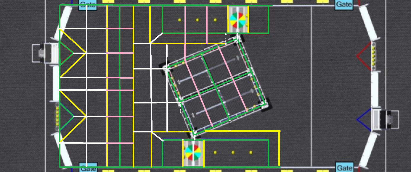

With all that out of the way, here is my first pass at what I believe would be a good zone splitting for 2020. Note that I’ve only marked a half field, the other half would be symmetrical to this.
Let me explain the colors and their meanings:
Level 1 (Green): Green is for the very obvious field markings and structures. This includes the edges of the field, target zone markings, loading zone markings, initiation line, trench run markings, and shield generator boundaries
Level 2 (Yellow): Yellow is for the effective areas associated with penalties and/or zone-specific scoring. Since G10 applies to any robot who’s bumpers even cross the target zone, trench run, or loading zone, I made yellow lines to bound those areas. Since G3 says a robot may not have it’s bumpers break the plane of it’s own sector, I put a yellow line on the side of the initiation line near to the field center. Since G9 says robots must break the plane of it’s own sector, I added a yellow line on the side of the initiation line away from field center. These lines together will also be useful for tracking auto mobility points off of the initiation line. I also put yellow lines on both sides of the control panel (these could have been green as well).
Level 3 (White): White zones are for connecting corners of green/yellow lines to each other. This is where things start to become more artistic and less formally defined. Green and yellow lines arise from pretty clear principles, but there are many ways to connect corners. I have a strong personal preference for rectangular zones that are parallel to field walls when possible, so I used the white lines to build these, with the exception of the connection between the trench run corners and the yellow lines surrounding the trench run.
Level 4 (Pink): Pink zones are used to split zones that would be too large without additional splits. These are the lines that are most up to personal preference, and as such I am most interested in feedback on these, as I think there can be good arguments for many options. I chose to split the zones near the initiation line into 7 parts each, in line with the zones near the alliance wall. A reasonable alternative would have been to split these zones into 5 parts each, in line with the zones near the center of the field. I opted for more zones because I believe this area will be a common shooting area, and as such tracking which zone a robot is in with higher granularity will be important. I also chose to split the quadrants of the shield generator in half perpendicular to the switches. I think this is a more natural split than to go parallel to the switches as robots will swing some while hanging. I could have split each quadrant into 3 zones instead of 2, but that was starting to get small. I can see an argument for 3 though as it would better mark endgame locations for robots. I also split the long side of the trench run and adjacent penalty effective area into 3 zones. This comfortably puts one ball in each zone for potential auto tracking, and makes each zone around the same size as the other trench run zone on the far side of the trench. I could see splitting this area into 2 or 4 zones though.
Let me know what you think of any of my guiding principles or zone designations! Particularly if you have ideas for use cases of these zones that I haven’t thought of.

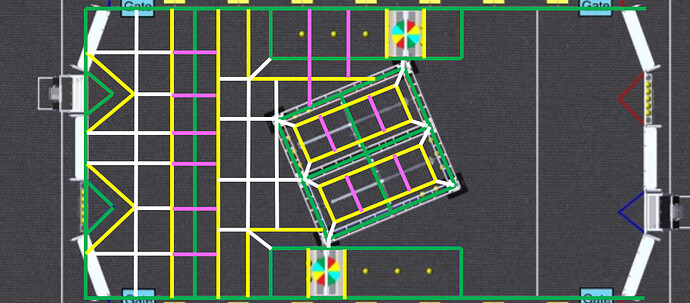

After re-reading the G15 rules, I realized that the above zones in the shield generator won’t be able to identify this penalty very well. Here’s my new suggestion for the shield generator (pink/white lines in other areas stay the same as above):
This is getting to be smaller zones then I tend to be comfortable with, but I think it’s pretty important to be able to track penalties as well as possible. The small white lines connecting the support beam centers to the yellow penalty area corners could be placed parallel to the other lines, I have no strong preference as they are so small and close to field structures. This also gives a little bit more granularity to hang positions, which seems useful.

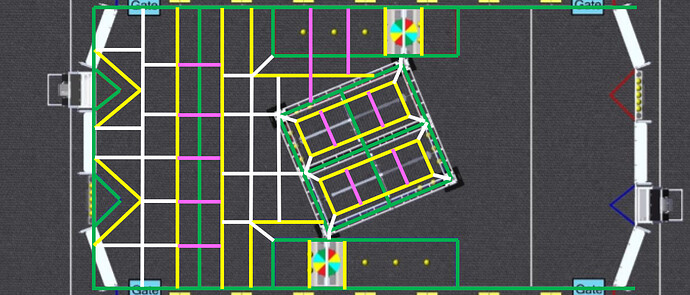

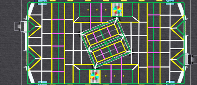

Just my two cents… I think we’re going to see a significant number of teams lining up “straight” in front of the goal to shoot. The way the white/pink zones in front of the goal are set up (up to the yellow line past the INITIATION LINE), those robots could end up splitting between zones right next to each other, depending on which side of their robot the tracker is on.
The data might come out a little better if you set up your lines to match the outer edges of the high goal - that would split the robots into “center shooter” and “angled shooter” profiles, which could be more valuable data.
Option 1:
Option 2:
Share preferences, I’m leaning toward option 2.
I’d lean toward option 2 as well.
I like option 2 as well for the reasons Jon stated

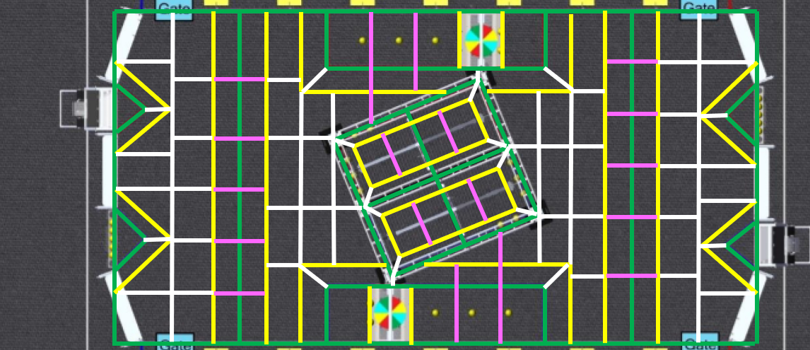

Alright, I’m locking in the following zones:
Only change was making a zone on the center side of the initiation line line up with the shooting zones instead of the center zones, this will make the further shots more comparable with the close shots. @typeusernamehere if you want to print something to hang on your wall this is the one I’d recommend :wink:. If I ever start selling merch I’ll be sure to make a t-shirt with this on it.

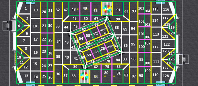

Here are the zone IDs I’m assigning. Tried to keep zones adjacent to each other and crisscross the field. Zones 65-128 were defined to mirror zones 1-64, that will make definitions easier as I can mirror the coordinates for those as well. Also, 128 is 2^7 which is a sweet number of zones to have, completely unintentional, but cool.
Equivalent zones will be defined using the same IDs for zones 1-64, and be paired with the zone on the opposite side with ID 129 - (near ID).
