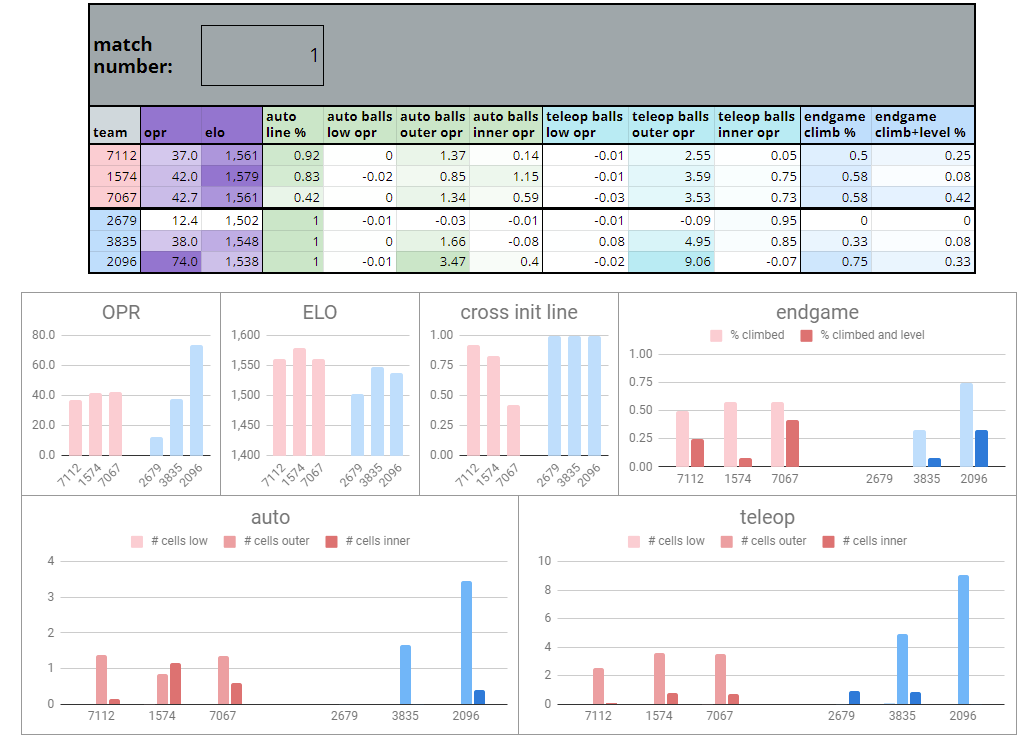

2021 Google Sheets Component OPR calculator
A slightly modified 2021 version of my google sheets match breakdown / component OPR calculator is linked here:
tinyurl.com/2021oprcalc
This is the same as the 2020 version, with the addition of a match lookup sheet that pulls component OPRs for the teams in that match, along with all the score breakdowns from the matches the 6 teams played in. If you don’t want the team lookup or match lookup tabs, you can delete them after adding an event to make the sheet smaller.
The sheet will only work on events that publish component breakdowns. I’ve tested on isjo but only after the event completion, so if you find any issues please let me know.

For the match breakdown tab, I include all TBA provided breakdowns, including any they add. For COPRs, since I publish only selected averages/OPRs to include to keep it more readable, I can start on that once I know what FIRST plans to publish. Generally this list includes:
  • Event rank, ranking score, ELO, OPR
  • Averages for anything tracked per robot – auto movement, endgame status, etc.
  • COPRs for anything high priority in scouting (e.g. for 2020 low vs high vs inner balls)
  • Other fields that would be a high priority for match strat or alliance selection
Things I have dropped over the years:
  • Calculations that are inherently statistically misleading (DPR, CCWM)
  • Fields that trend too close to 0 to be statistically significant (foul OPRs, ranking point OPRs)
  • Avoiding alliance averages, since they can be misleading especially partway through events
If there are particular fields that you/your team find useful, please reach out to me and I’ll consider including them. The vast majority of the sheet doesn’t change year to year, I just reformat the match breakdown tab, pick the averages/OPRs, and adjust the team/event lookups as needed.
