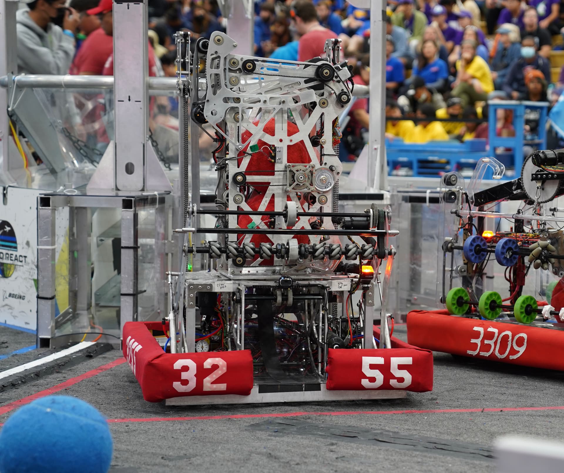

FRC team 3255’s robot “Venom”
Produced for the 2022 challenge, Rapid React

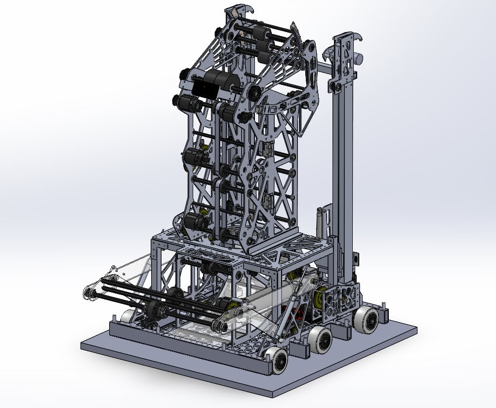

Shooter
  • 2" Ball Compression
  • Dual Falcon 500 shooter
  • Vision tracking shooter hood and turret
  • Variable angle hood
  • 360 degree shooter turret
  • Able to shoot from anywhere past launch pad
Intake
  • 2" mecanum wheel intake
  • Single Falcon 500
Climber
  • 12 second Traversal Climber
  • Chain driven elevator
  • Single Falcon 500
Drivetrain
  • 4" Wheels all colsons
  • Dual Falcon 500
  • Chain driven
