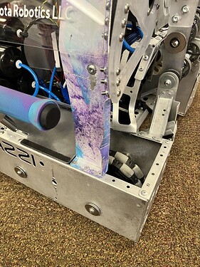

Of course, we take responsibility for all damage that is our fault, as covered by the exceptions in part B of G205. Much of the damage to our frame itself can be attributed to collisions with other robots that were playing fair and legal defense. And we take full ownership of the many dents in our frame in gaps between our bumpers. We had polycarbonate parts snapped while they were inside our frame, but these were near enough to an opening in our bumpers to almost certainly qualify for an exception. So these damages are all our responsibility. We have learned and hope to improve much of this in future seasons, eliminating unnecessary gaps in our bumpers. (We now see that even though such gaps may be legal, they might also be disadvantageous.)
But what about sheet metal warped or folded nearly ninety degrees on parts that never came close to leaving our frame perimeter? Or metal brackets torn as could only have been the result of a direct hit? Or the numerous dents and sheet metal tears in our robot’s interior that indicate further illegal contact? (See pictures below.) And not one card or tech foul. Instead, only fouls under G204. But at the end of the day, we don’t really care about yellow cards, tech fouls, or even the damage to our robot; we care most about discouraging illegally aggressive gameplay that goes against the spirit of FRC.
We recognize that off-season events are quite casual (and are team- and volunteer-run). Nearly all the teams and other stakeholders we meet at such competitions are kind, patient, and Graciously Professional. But, in full support of the spirit of these events, we fault a culture of competition that sometimes plagues them. This culture is infectious, spreading between teams and affecting new members, and is made far worse when the rules that separate FRC from combat robotics are not enforced. We feel that a public forum is the best way for us to share our concerns from last weekend.
Here is a selection of photos … there are many more of other parts of our robot, as well.
A nylon SLS-printed part that cracked in two from a hit. This part is as close to the center of our robot as it gets.
An aluminum sheet metal bracket well inside our frame perimeter that was hit and significantly bent:
and finally …

Adding to PJ’s point, any damage caused which would result in a G205 call would have to be apparent to the referee(s). Since G204 was being called, perhaps the refs could not see the damage from where they made the calls.

I’d take this opportunity to use this as a great design learning experience. Robots are only becoming more powerful over time. If you’re relying on the referees to make the correct call 100% of the time, you’re only going to be disappointed.
Anything going outside the frame perimeter that can run into the field or another robot needs to be built to withstand impacts - it’s why we use as much polycarbonate as possible on those parts of the robot and try to make polycarbonate shields to prevent robots from entering our frame perimeter. It bends nicely but rarely breaks and if it does usually you can repair it with more polycarbonate or a flat piece of aluminum in a pinch.

I have been doing this for a long time, been to lots of tournaments. This is the most damage I have ever seen on one of our robots. We build fairly robust machines, but at the same time this isn’t battlebots and so we aren’t designing these bots with that in mind. The pictures my student posted don’t do the damage inflicted justice.

We have plenty of experience with reinforcing mechanisms that leave our frame perimeter. And the damage we are talking about was inside our frame perimeter. Our robot was very robust (we have been very careful to build structurally strong robots for the past many years), and survived two regionals and our first offseason comp with no structural issues. We do have polycarbonate shields, yet we had what I can only describe as a “tear” in a sheet metal bracket that was a) very strong, and b) behind a polycarbonate shield. But there is a gap where another robot’s part would have had to extend 9 or so inches inside our frame perimeter to impact it.
