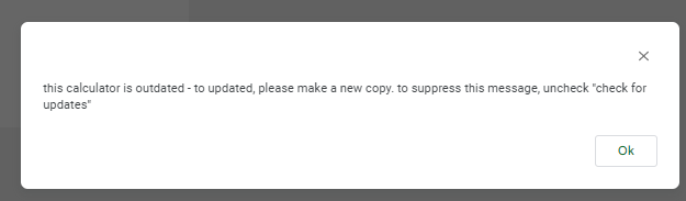

I just made a fresh copy and received this error:
Looks like the Match data tab is populating but the OPR one is not.
Excited to use your sheet as it looks like it’s going to be the best resource to get end game data again.
Thanks! Fixed the popup message.
