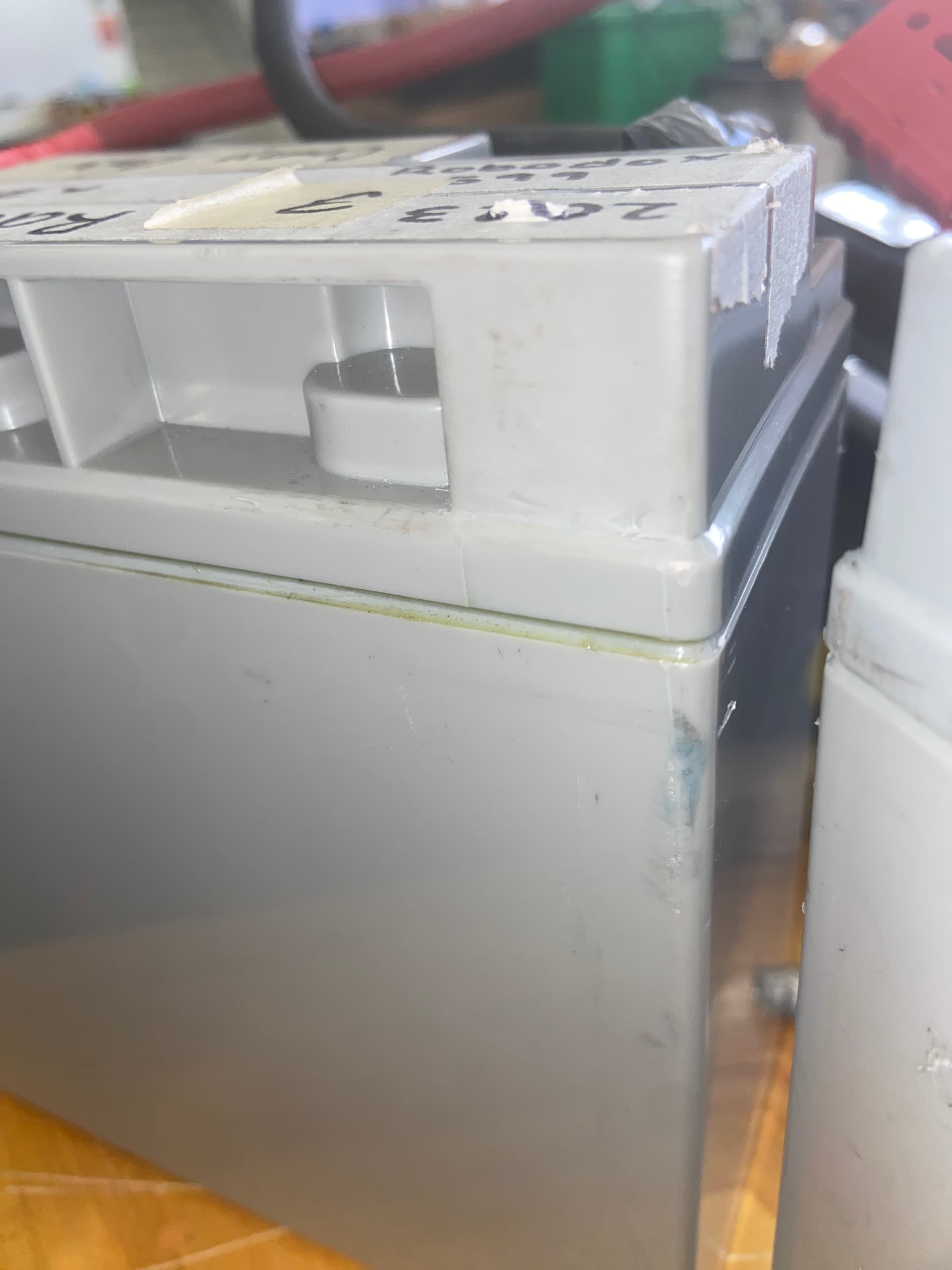

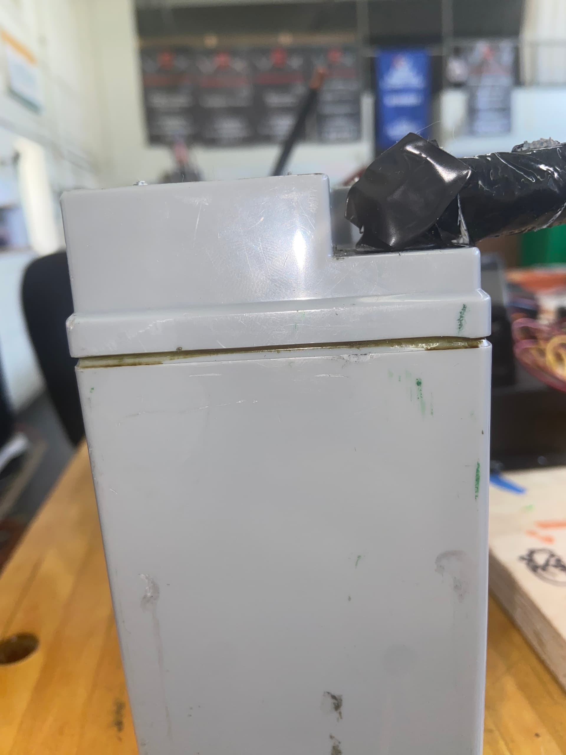

There is green stuff coming from the top seals of our MKs too, I’m not sure if its a leak but Ill edit with a photo around noon and hopefully someone can let me know.
Depends on the amount and color. If you’re seeing a small amount of something that’s yellow-green-clear IN the seam that’s likely the seal/glue holding that seam together. If there’s anything coming OUT of the seams that could be an issue.
