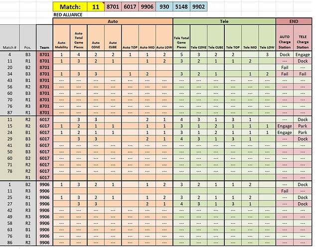

Team 2194 is happy to share our Scouting Analysis Spreadsheet. We’ve been using this format for many years, and it has helped us analyze scouting data to make decisions for match strategy and making pick lists.
This year we’ve formatted it to work with PWNAGE ScoutingPASS, but it could work with any system if you format your data to work with our “Match Input” Tab. There are many macros, so you’ll need to enable macros to use the file. There’s an instruction tab that should (hopefully) explain everything.

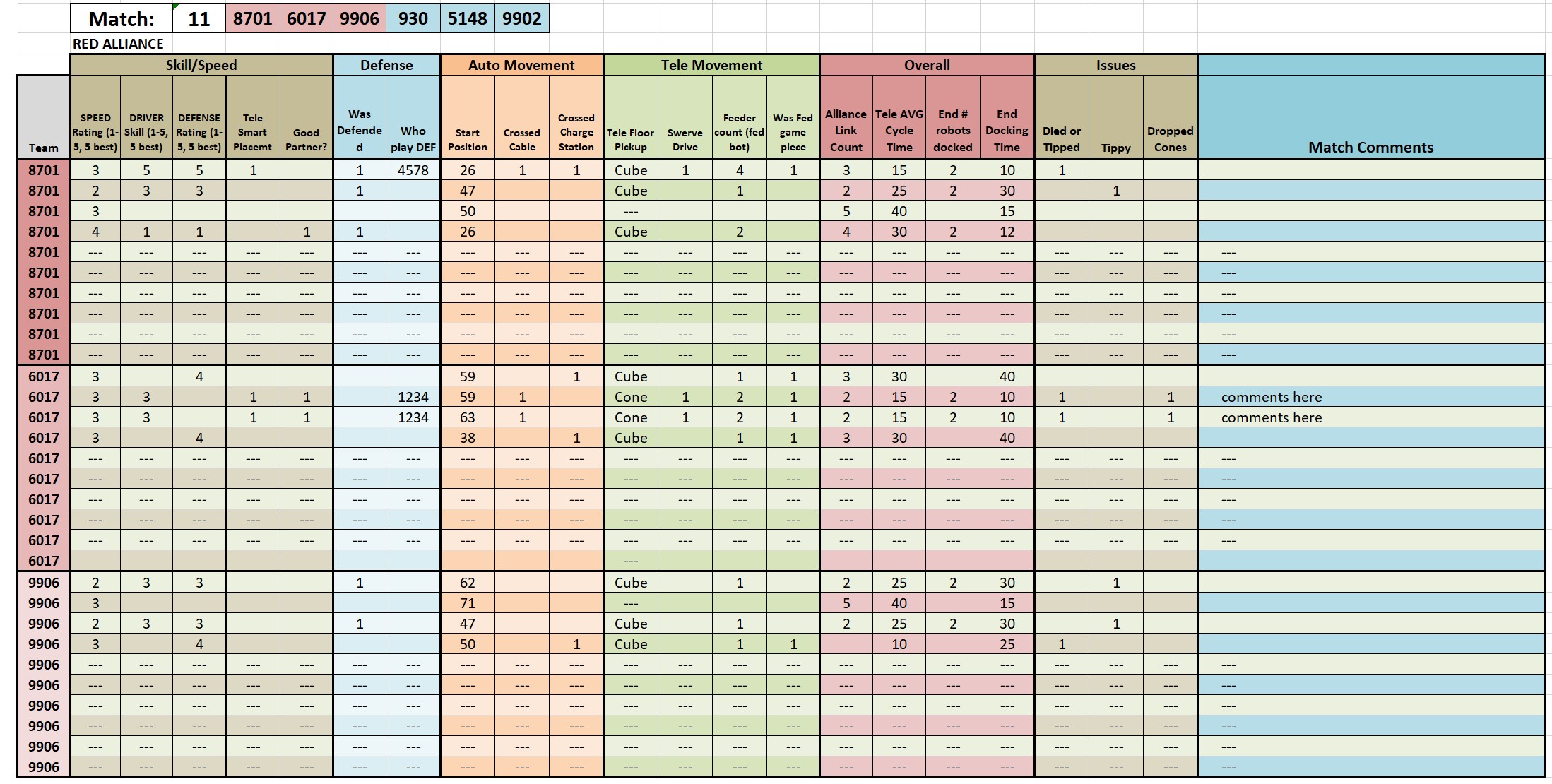

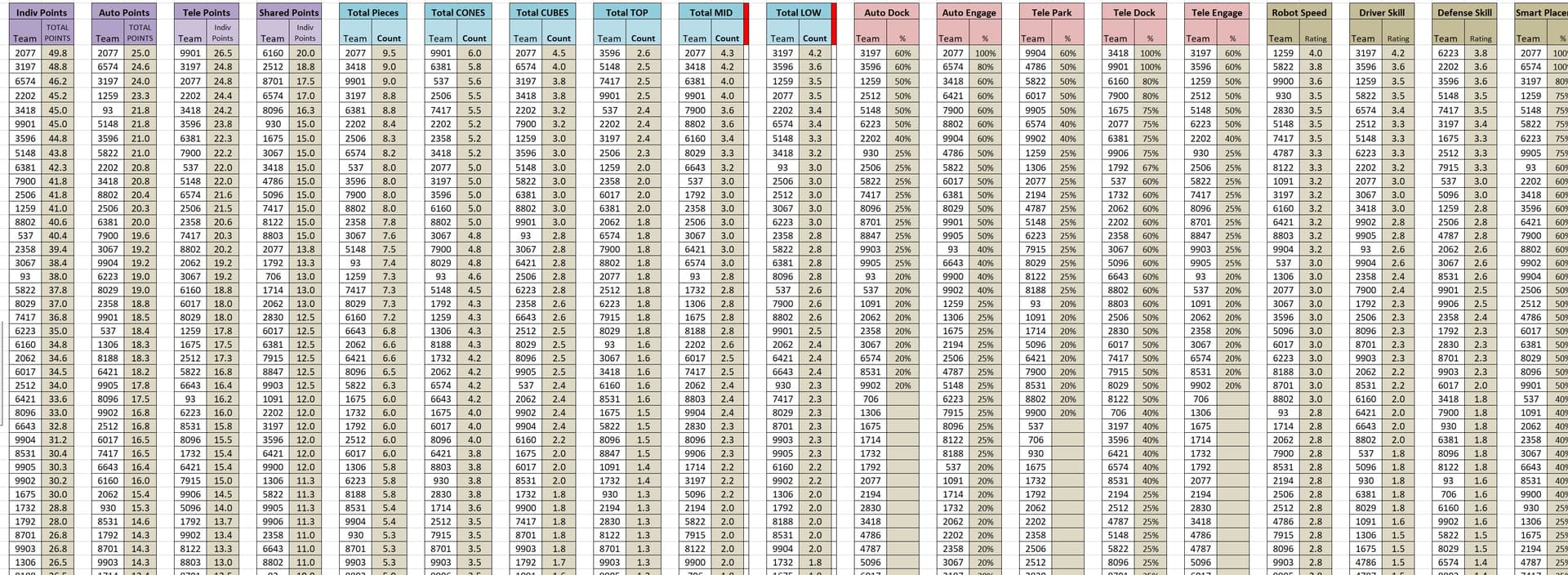

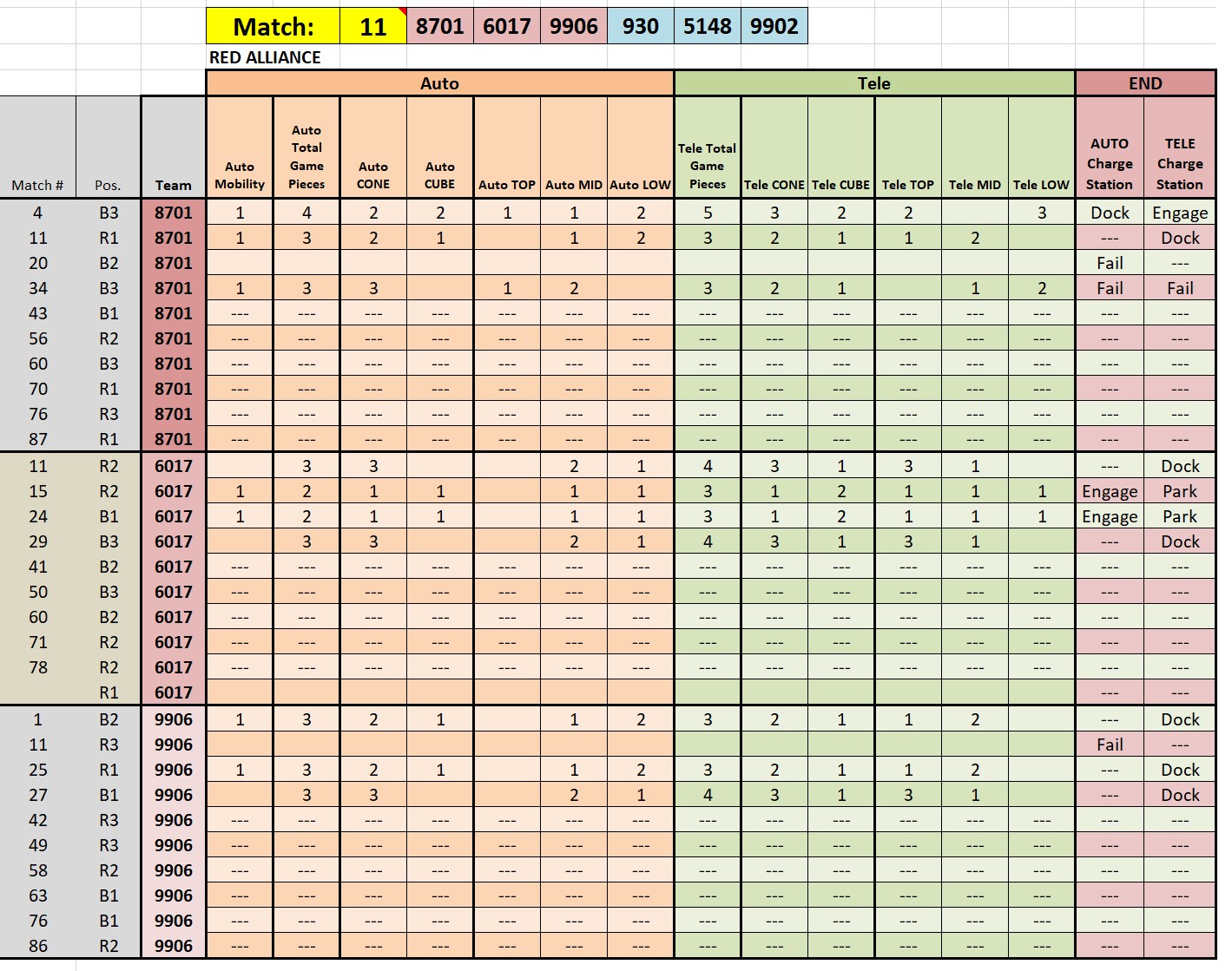

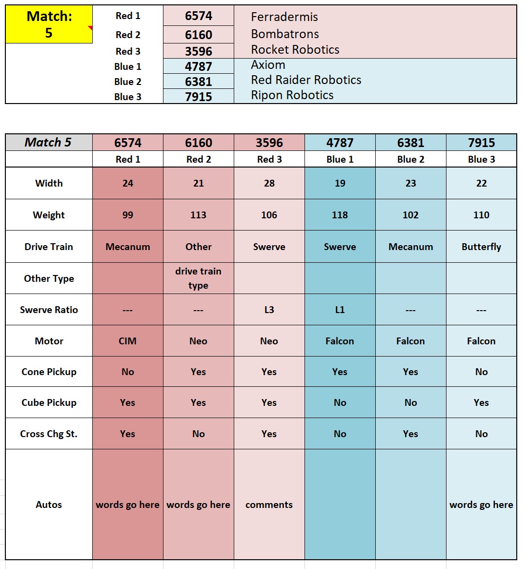

Below are sample pictures of the output (the data is fictitious).

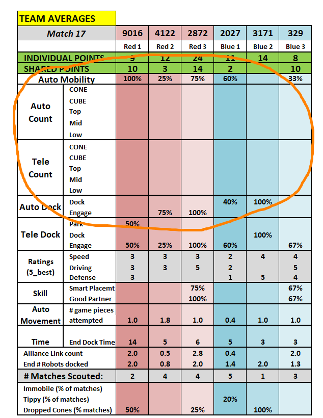

Thanks so much for making this available to all teams! We had a blast using it to look at data from our most recent regional, but I wanted to point out that the count for game pieces wasn’t working.
Is the change described in the post I’m replying to have to do with this? Looking forward to using it again next week.
It seems the issue might be on the PWNAGE side of things, because upon import these values are not present.
We’ve re-setup the repo for scouting a few times. If you have any suggestions please let me know!
Thanks for reaching out. I’m glad the analysis spreadsheet worked for you. The recent update to the analysis spreadsheet was to incorporate changes PWNAGE made to their ScoutingPASS app (they added some additional fields).
The issue you are having is not related to this. From the second image you posted (PWNAGE’s Excel Skeleton file), it appears the Excel Skeleton spreadsheet didn’t calculate those fields properly. The same thing happened to me a few times when I was testing it. I noticed that the “Match Scouting Data” tab acted differently depending on how I removed the row of sample data in the original file (row 2). To remove the row of sample data, I initially highlighted the data and hit the delete key. By that, I mean, I didn’t actually delete the row, but instead just deleted the data in that row. When I ran the macro, some columns were blank (same ones you show as blank). I then downloaded the file again to start over. This time, I deleted the entire row of sample data and ran the macro. It then ran just fine. You might want to try that.
