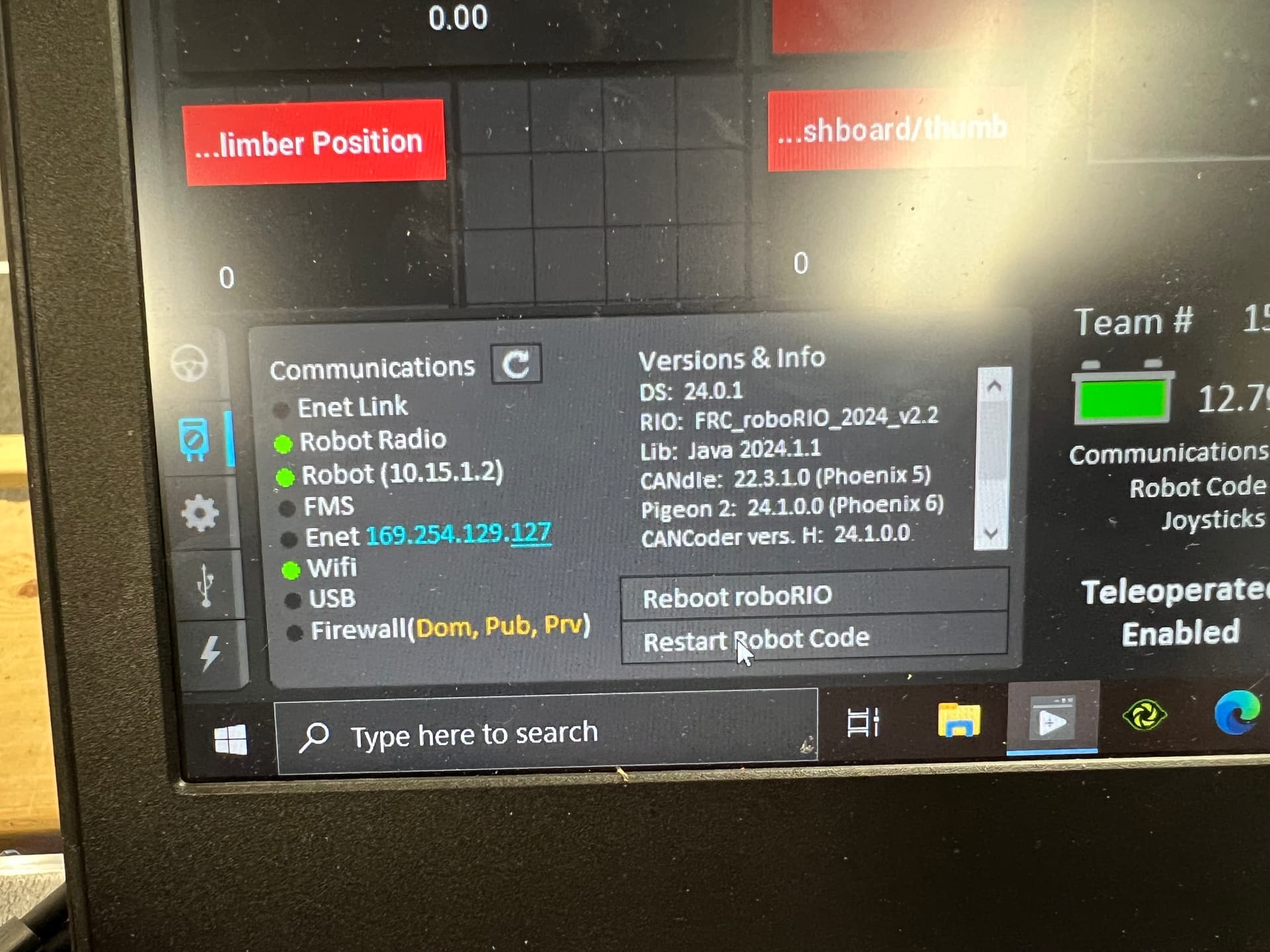

I encountered this today. Strangely enough I could swear it was fine yesterday but maybe I am imagining it
Same setup.
RIO 1
DS: 24.0.1
Firmware 2024 2.2
Restart Robot Code, DOES NOT work.
