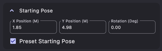

If your robot odom is not being reset when you run the auto then you probably don’t have a starting pose in the auto.
Also, your current setup would not react to the current alliance. It will always flip the path to the red side since your “should flip path” supplier is always returning true. You’d want to change this to return true only if the current alliance is red.

The auto resets odom for you, you don’t need to get it yourself. If you just want the pose for some reason there is a method to get it: Path Groups | PathPlanner Docs
You need to have a starting pose in the auto.
If it’s not working even with a starting pose in the auto then your “setPose” method is not resetting odometry.
Thank you, I found that I checked that off, so will try that tomorrow!
