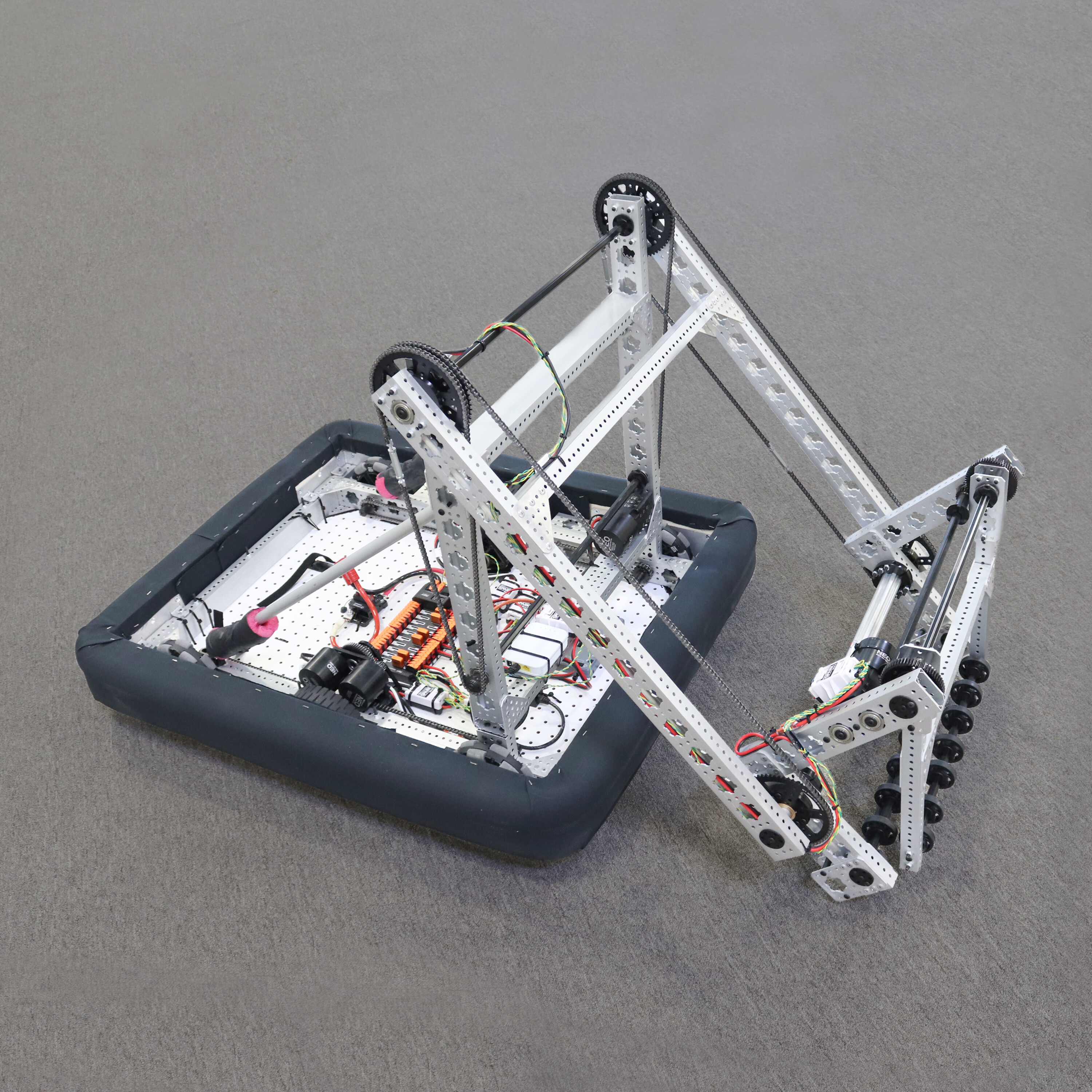

2024 REV ION FRC Starterbot
Meet the 2024 REV ION FRC Starter Bot! Using all REV ION parts, the Starter Bot is the culmination of analyzing the game, prototyping, and technical documentation. The 2024 REV ION FRC Starter Bot is designed to give teams a starting point for building their robot, while leaving room for iteration, revision, and adaptation to the game’s challenges. Read more about the 2024 REV ION FRC Starter Bot on our website: REV ION - 2024 REV ION FRC Starter Bot - Page 1 - REV Robotics
Visit our technical resource series, FRC Kickoff Concepts for CAD, build guides, and more: 2024 REV ION FRC Starter Bot - FRC Kickoff Concepts

Is it possible to intake directly from the source in the starting config with the shooter side? It looks to about line up.
Yes it does. Looks like we missed adding the clip to the video

@Greg_Needel My team was considering this as a starting point for our robot. Compared to the 2024 kitbot, what are the advantages and disadvantages of the Rev Ion starter bot?
This may come off a bit harsh or antagonistic, and that is not my intention–your question isn’t easy to answer because of how large in scope it is. It is not really a question someone from REV can answer without writing quite a bit.
What sorts of thoughts and observations have you or your team noticed when comparing the two? With those observations, what specifics can you identify to better inform more detailed questions?
My team has already started building the kitbot. And we have several ideas to make it better. What I am asking is: what is the value of the Rev Ion? What can it do that the kitbot can’t, and more importantly, how can we improve it? If we just buy a robot kit and follow the instructions, that isn’t really the spirit of FIRST. Its like building a Lego set.
For our team, it’s really helpful to see the kitbot, all of the Ri3D bots and the REV Starterbot. They’re all sources of good ideas. But it’s really up to you to decide whether you find this valuable.
But also recognize that this offering is intended to showcase a lot of the REV products in a way that allows teams to see interesting uses of those components. In that way, yeah, of course, it’s a bit lego-ish. No custom parts on that robot at all – the point is to show how you can build an entire robot using only REV components.
It’s also interesting to look at and ask “why did they do that?” For example – you see that one piece of aluminum with orange tape on it. Why? Why is there a separate angled piece of aluminum for the motor that drives the intake? (Why does the CAD have Vortexs on the swerves, but NEOs in the photo? Was it so they could ship four more Vortexes to their customers?)
Rev put together a really sweet building system for making robot designs faster. There are a ton of holes everywhere so teams can build and iterate faster. I think a lot of teams should consider using the Rev ion system generally.
Now what I think you wanted to know is “why should you use the REV starter bot? - which uses REV ion parts”.
They showed from the reveal it has more features that the kitbot. it already has a simple climb, ground intake, speaker shooter, and amp mechanism.
Now what can you do with it. Let’s say your team is programming heavy. Your team could build this, add some sensors/cameras/etc and make some crazy autonomous routine.
If your team has more mechanical/design resources, maybe you can make it shorter? Maybe you can make the “harmony” points. make the shooter variable so you can shoot from multiple locations. Heck, figure out how to make it score in the trap. The ion system is neat, because there are holes everywhere. Adding a mechanism is pretty easy. I think your imagination, budget, and the 125lb weight limit are your only limitations.

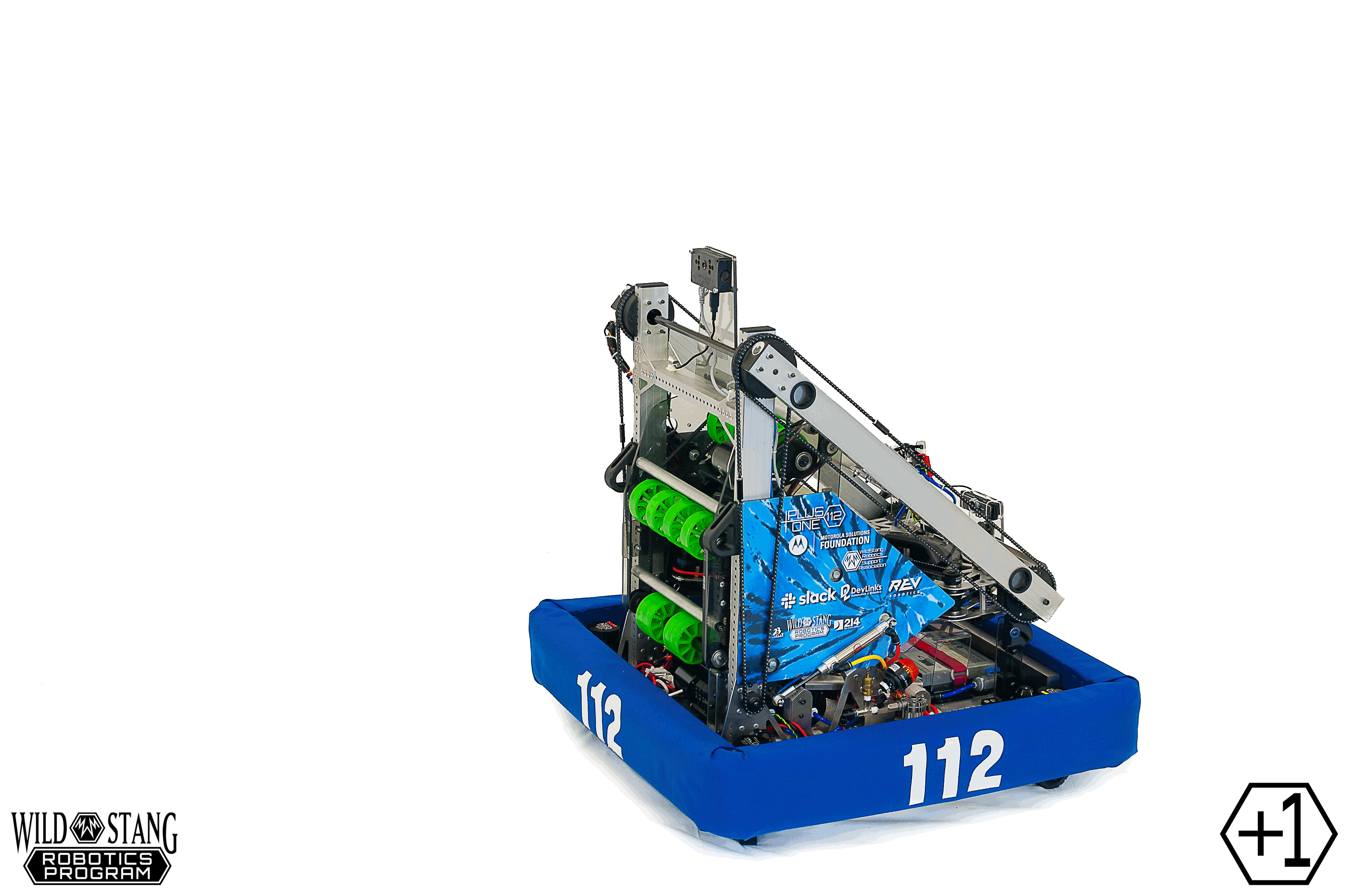

It looked like team 112 used the REV starter bot for inspiration 2023, and crafted it into a very capable machine.
There are a ton of resources this season. It’s a pretty fun time to be involved in FIRST.
Edit: better clarified 112’s use of the starter bot.
While we were inspired by the REV Ion bot, and made a very similar bot, and used a lot of rev ion components, we didn’t make the REV Ion bot.
Side to side:
f7e37ed8a168e07dbddf2a56e069d0bbbdca80c4
Extra links
Link to robot reveal:
WildStang and Plus One 2023 Robot Reveals
Link to build blog:
WildStang Robotics Program: Team 111 and 112 Build Blog - 2023

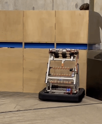

Great design, the intake looks awesome!
How consistently are you able to score in the Amp?
What drove the decision to use NEOs and not Vortex?
The AMP scoring was a bit of a happy accident after thought. We were able to do it consistently, but it isn’t perfect and is something I would probably work on to improve with this robot. I think mainly this is something we could improve with software as we didn’t spend much time on different modes or tuning speeds for all the situations
We decided to build the physical robot out of NEO because they are in the KOP and have been for several years. Our goal with the the Starter bot is to give people ideas on ways to approach things, and you don’t always need the new thing to build a robot. Both the NEO 1.1 and Vortex can be used interchangeably in this design and that shows in our Onshape release. The NEO + SPARK MAX is also a lower cost option for teams.
Additionally since the Vortex has not become available yet (only pre-orders have been delivered), we wanted to show a robot that could be built right now with things that are available to everyone right now. Building a robot that is made with motors that are not available right now to every team didn’t feel right or responsible.
