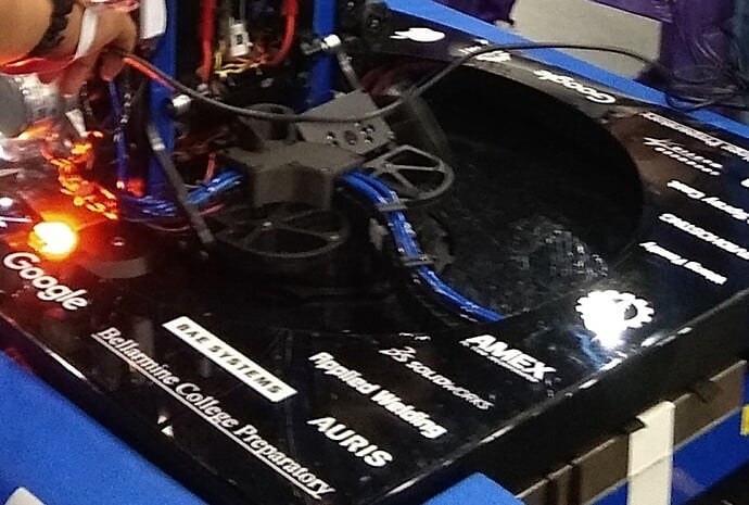

However, I couldn’t help but notice the design of 254’s robot with its independent rotating multi-purposed arm. How does the arm rotate independently of the drive base? What’s stopping the wires connecting to the intake from bundling up when you rotate the whole way? Is there a CAD I can download with 254’s robot?

The arm is on a turret, probably custom designed. It probably can only rotate a limited number of times so the wires don’t get tangled.

Looks like they custom 3D printed a cable management system. That is fine if you have the skills and equipment. But just getting some Igus energy chain will get you most the same benefits. Just takes a bit more space. Learning what works and what does not, takes some study and or experience. Our Igus rep helped us out a lot with what to look out for. Surprisingly the most magical part of of our setup is the cable tray. We made a polycarbonate pie pan arrangement and could have stopped there. We could make over 720 degrees of motion.

Due to the limitations of the bi-directional IGUS (“Bigus”), the turret could only rotate +135deg and -310deg, the code told the turret which way to spin to point to the target, and sometimes if the drivetrain was quickly rotated the turret would have to whip around to keep pointing whilst not going past the hardstops. The Bigus was constrained above and below by a shelf and cover made of bent 1/16" polycarb that attached with velcro onto the bumper rails and could easily be removed to replace batteries/bumpers and service wiring.

The turret shaft (highlighted in blue) consists of a giant billet part which holds an upper, 6.5" ID, 7.25" OD, 0.375" WD Kaydon X-contact bearing we purchased from Ebay. This bearing outer race was held from below by a counterbore in the fixed 3/8" plate that was bolted to the 1x1x1/8" crossrails that were welded to the drivetrain. The outer race is clamped from above by clamp ring via screws into tapped holes in fixed 3/8" plate. The inner race of the bearing rotates with the turret and is held from below by a clamp ring via screw into tapped holes in the turret shaft, and above by a shoulder on the turret shaft.
Lower on the turret shaft a shoulder exists where a #25 72T vex sprocket with a milled-out center is attached (#10-32 screws clamp and transmit torque). This sprocket is driven by #25H chain from a 22T 1/2" hex sprocket that is the output of the turret gearbox. An SRX Mag Encoder counts rotations 1 gear reduction back from this output due to packaging issues. The gearbox is driven by 1 775pro.
On the bottom of the turret shaft another 1" ID, 2" OD, 0.5625" WD high load radial ball bearing is held from above and below by internal and external retaining clips, respectively. It is held radially in another billet piece that attaches down to the drivetrain weldment’s bellypan via standoffs (this billet piece just barely sits above the breakers on the PDP). This extra bearing greatly increases the moment capacity of the turret, giving it a second bearing point 1.75" away that can transmit load into the bellypan, which is very strong in inline tension.
