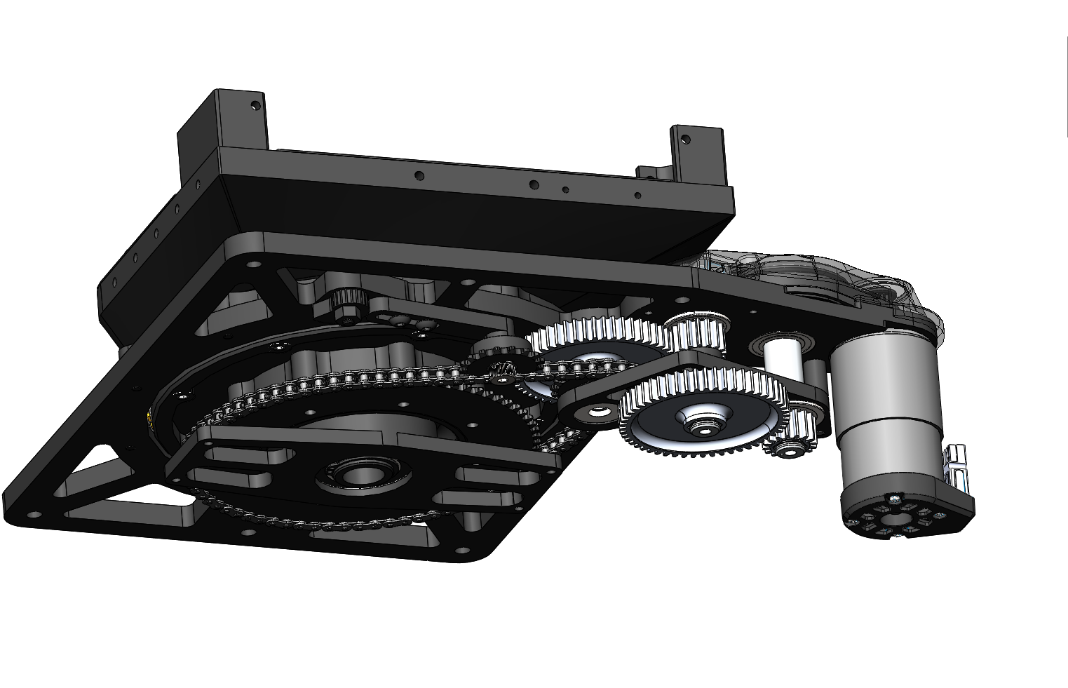

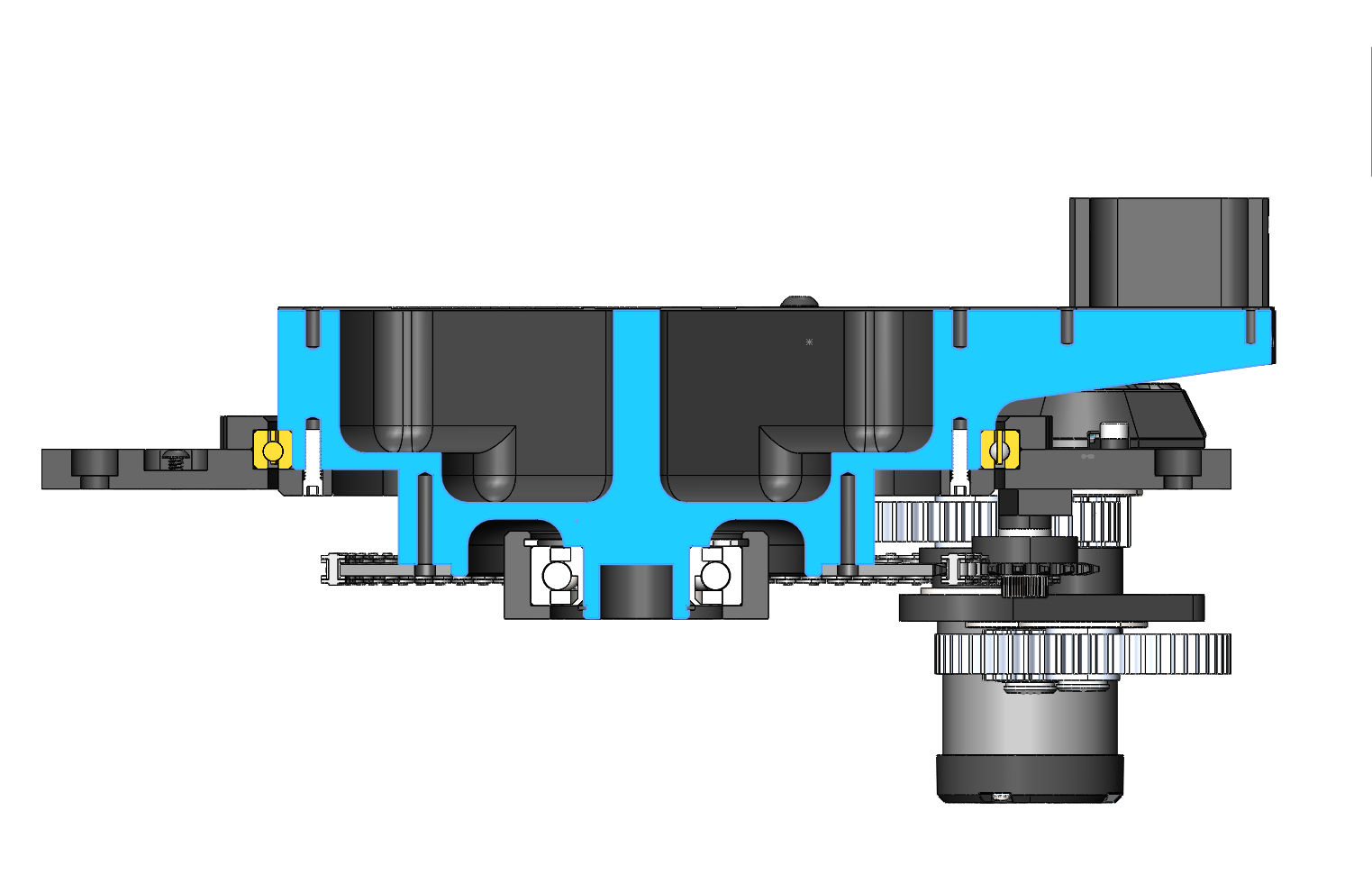

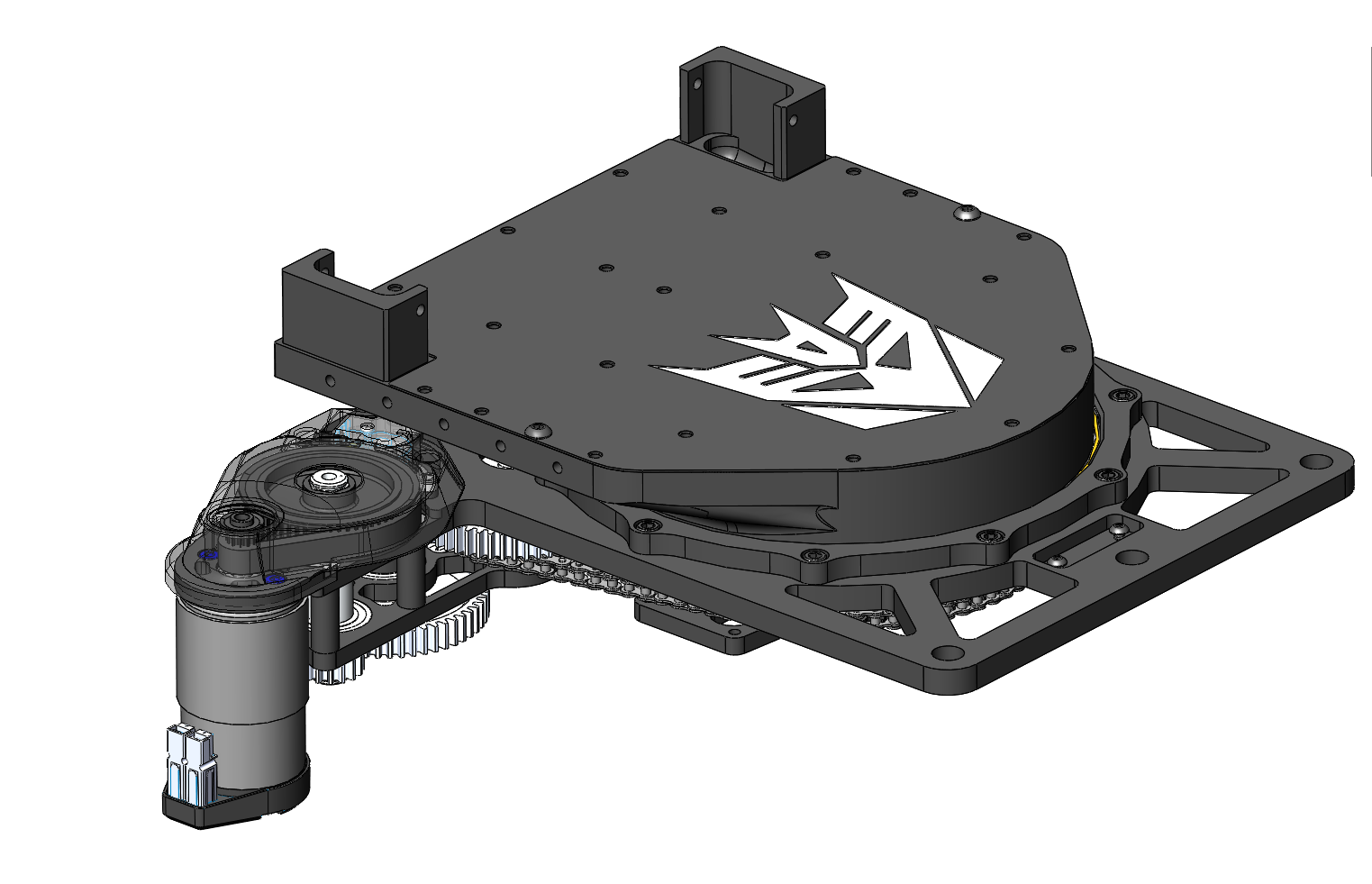

Turret Design:
The bearing design for the turret was done to maximize stiffness and strength. Making a turret that was strong enough to withstand the moment generated from our arm running into a rocket or other robot with the elevator at max travel and drivebase at full speed was the driving spec.
The turret shaft (highlighted in blue) consists of a giant billet part which holds an upper, 6.5" ID, 7.25" OD, 0.375" WD Kaydon X-contact bearing we purchased from Ebay. This bearing outer race was held from below by a counterbore in the fixed 3/8" plate that was bolted to the 1x1x1/8" crossrails that were welded to the drivetrain. The outer race is clamped from above by clamp ring via screws into tapped holes in fixed 3/8" plate. The inner race of the bearing rotates with the turret and is held from below by a clamp ring via screw into tapped holes in the turret shaft, and above by a shoulder on the turret shaft.
Lower on the turret shaft a shoulder exists where a 25 72T vex sprocket with a milled-out center is attached (#10-32 screws clamp and transmit torque). This sprocket is driven by #25H chain from a 22T 1/2" hex sprocket that is the output of the turret gearbox. An SRX Mag Encoder counts rotations 1 gear reduction back from this output due to packaging issues. The gearbox is driven by 1 775pro.
On the bottom of the turret shaft another 1" ID, 2" OD, 0.5625" WD high load radial ball bearing is held from above and below by internal and external retaining clips, respectively. It is held radially in another billet piece that attaches down to the drivetrain weldment’s bellypan via standoffs (this billet piece just barely sits above the breakers on the PDP). This extra bearing greatly increases the moment capacity of the turret, giving it a second bearing point 1.75" away that can transmit load into the bellypan, which is very strong in inline tension.

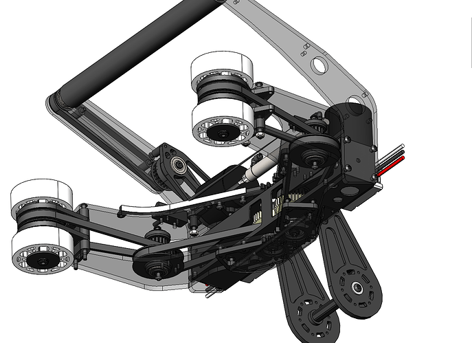

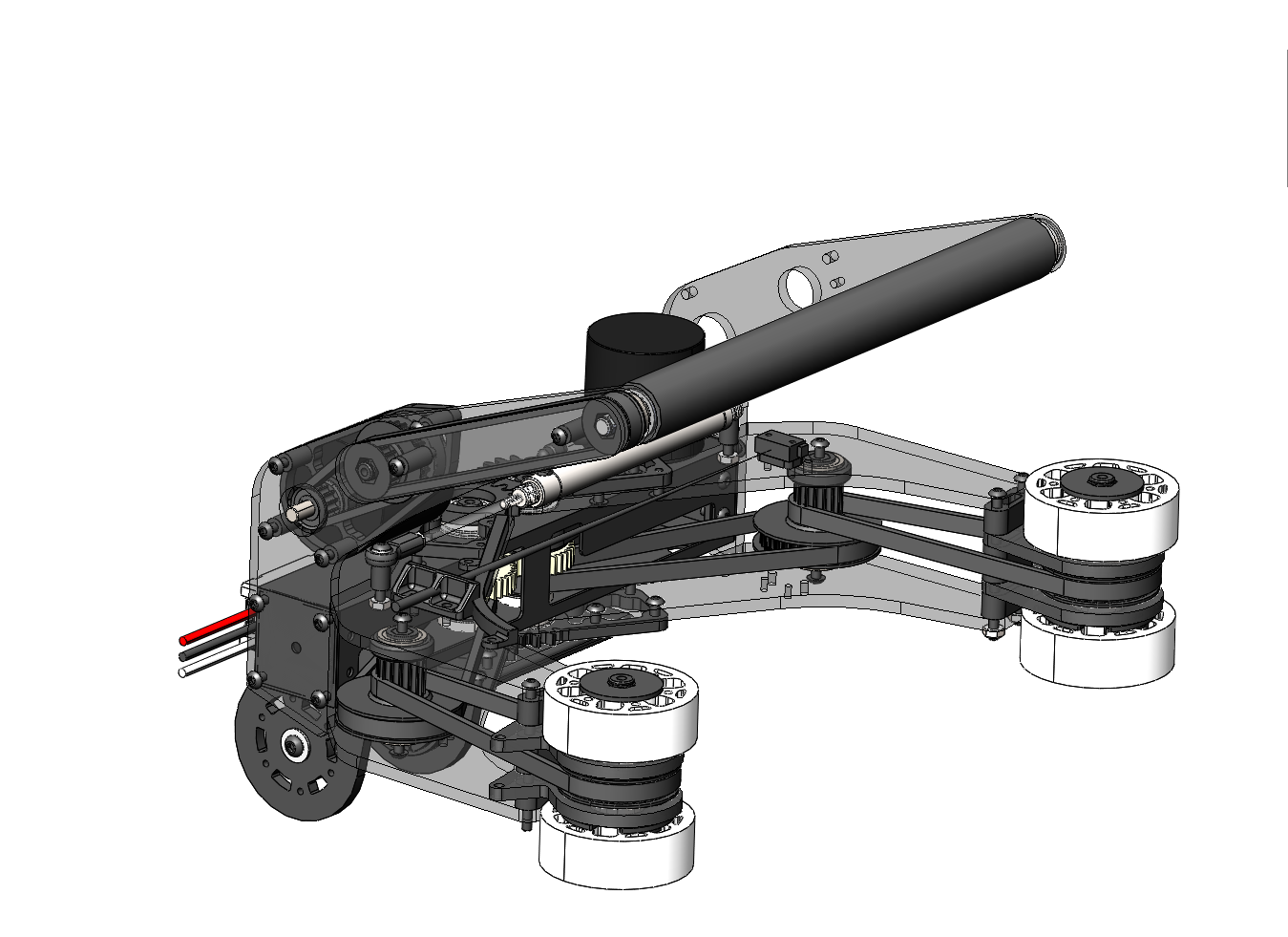

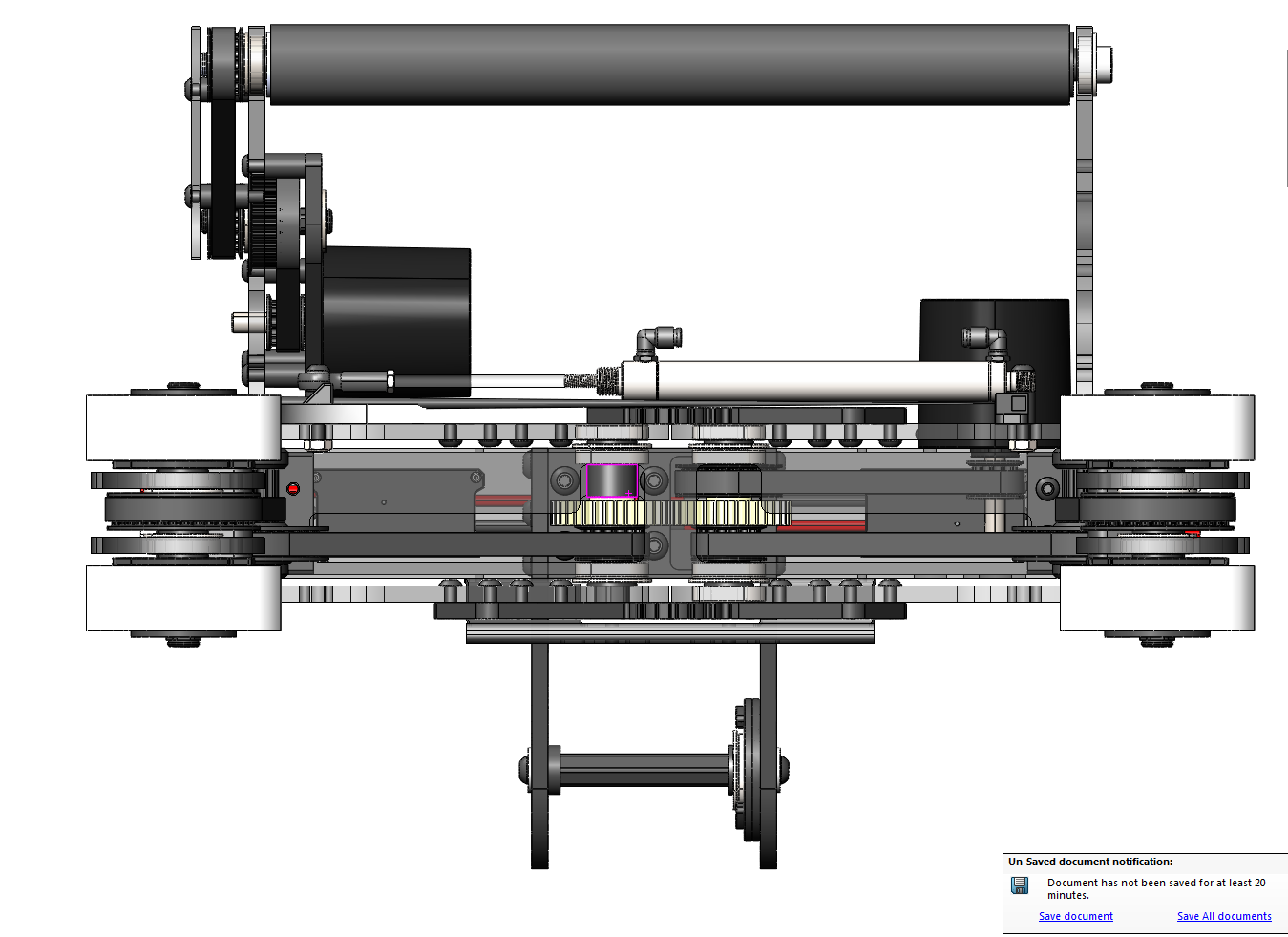

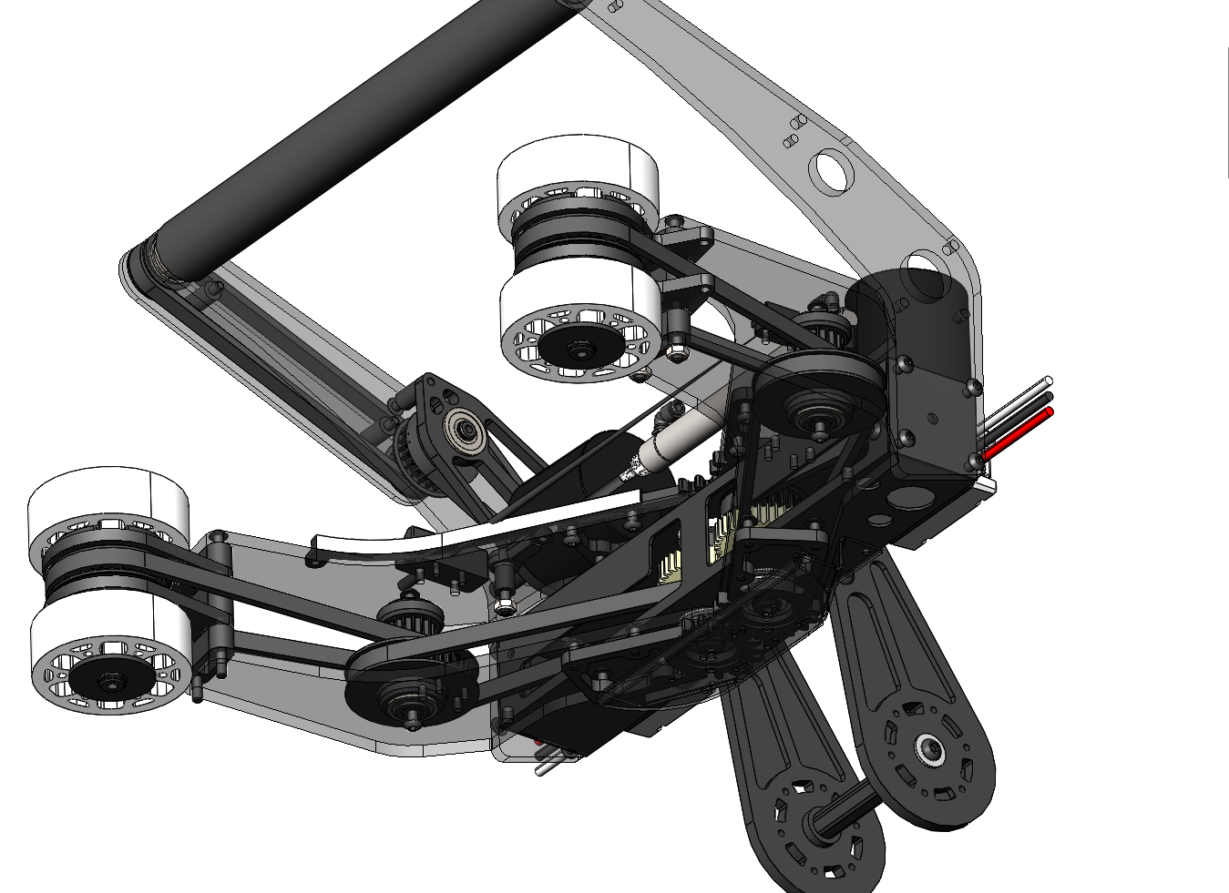

Claw Design
The claw (V7 in CAD, V3 of what was actually built) is designed to intake both discs and balls from all sides of the robot. The claw in the robot photo at bag’n’tag was bad, it popped balls and couldn’t pick-up discs, not even from the ground. We abandoned floor discs and focused on making a versatile intake that would be great at funneling balls and could still do discs. Thus, we took inspiration from others and redesigned the intake in time for SFR to feature 2 rollers to hold the ball and 4 3" flex wheels on arms that could actuate between a ball funneling state and a disc intaking state.
At SFR and SVR, the intake was massive and game object would sweep outside the bumper perimeter when turreting, requiring the drivers to carefully drive around the rocket and cargo ship. The new intake for champs was much shorter but required a longer (16.5" at SFR/SVR → 21" at Champs). It was also lighter (15.6 → 10.2 lbs) by removing the bottom roller (we determined the bottom roller was unnecessary after seeing others), one of the 2x2 and both 1x1 crossbars. These combined to result in a ~50% reduction in torque, allowing it to be counterbalanced by a lighter gas spring (90 → 40 lbs), accelerate faster, and not cook our wrist 775pro.
Neos were used to power the top roller (2:1 reduction) and side wheels (10.125:1 reduction). 3D printed pulleys via the Markforged were used all over to make deadaxle combined pulleys, 16T pulleys with built in spacer, etc. The Neos were certainly excessive in their power output, but allowed for less gearing than a 775pro would require and the brake mode allowed for the disc to be held with little current draw.
A retro-reflective banner sensor was used to detect when the ball was all the way in and automatically stow the arm and intake.
The arms of the side wheels were actuated by a single pneumatic cylinder. Routed 1/4" aluminum 10DP “gear plates” were attached to the polycarbonate plates to keep the arm from parallelogramming. 1/4" polycarbonate plates were used here and to hold the top roller due to their ability to absorb shock loads without permanently deforming.
The top roller is our standard 1" OD, 1/16" wall roller with surgical tubing stretched over it we’ve used for lots of intakes in the past. We made custom aluminum endplugs (one side counterbored for a 3/8" shoulder bolt, the other with a 3/8" thunderhex CNCd to drive the roller). This roller setup is lighter than using a 1/2" thunderhex with numerous flex or mecanum wheels.

Is the purpose of the initial belt run from the 775 to the first reduction just to reduce backlash?
We try to use a belt for the first reduction of 775’s wherever possible because they are quieter and don’t wear down like the 32DP gears spinning at thousands of RPM do. It’s also nice to be able to package the motor in a weird spot out of the way if needed (see our carriage gearbox). This belt run still has some backlash (there’s no tensioner in place).

I saw that you MF your pulleys. When cadding the pulley, where do u get your tooth profile from? VEX?
One more interesting thing that we might reconsider doing differently next time was our decision to make a single stage elevator and double jointed arm, as opposed to something like 3476’s architecture with a 2-stage elevator and linear extension, allowing for purely prismatic DOFs. Having the arm made for weird singularities and dexterous work-space limits, particularly with reaching rocket disc level 2, that drove a lot of the arm and intake geometry. The intake and arm for champs were designed use a massive top level master sketch that coupled all the driving parameters from the scoring and intaking states to determine all the dimensions.
Requirements such as size of ball, reaching a disc with a ball in the way, scoring on all 3 levels, etc, provided plenty of constraints for the sketch.
Yes. You can simply get the pulley profile from a VEX or McMaster pulley by opening it, cut extruding away a flange so you can see the profile, sketching on that surface and using “Convert Entities” to grab the contour, saving that sketch as a Sketch Block and importing that sketch block into your new part, where you can add you own extra thin flange, bore out for 1/2" hex, add nubs to ride on bearing inner races, etc.

Did you plan to only be a cargo-only bot when you designed the first intake?
I believe that 254 CADs in Solidworks.
They used a west coast drive train.
Of course not, we planned on having a two-roller ball intake with a disc system mounted above it. The bottom roller of the intake was to be Velcro and pickup the disc from the floor and then the low jaw of the intake would articulate up and handoff the disc from the Velcro roller to the disc system on top. However, we ran out of time and didn’t really build a full intake prototype with all the systems, so just had to send what we had for the robot photo and plan on redesigning for SFR.
