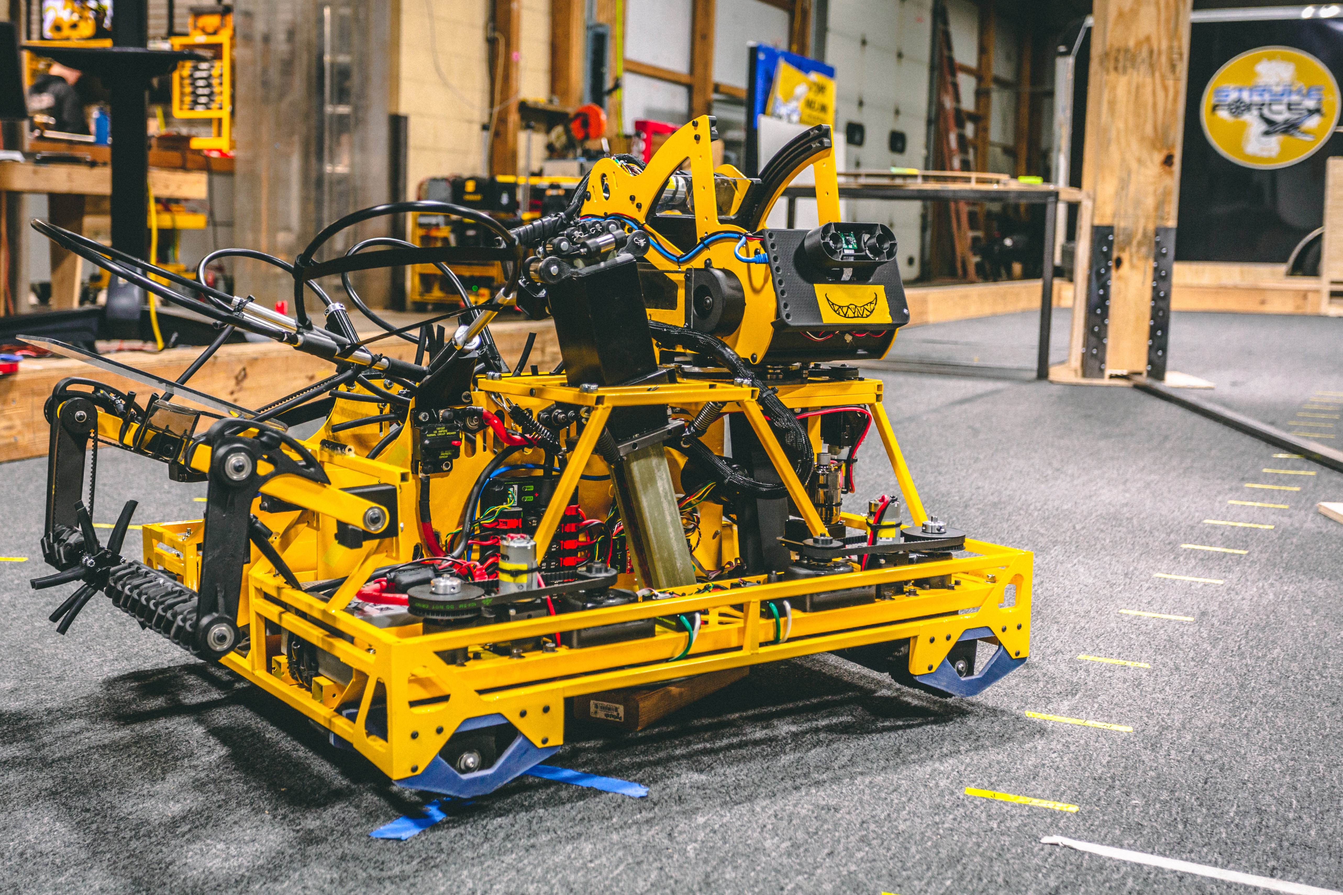

Team 2767 Stryke Force Proudly Presents: Tunnel Rat.

Is that steel or what kind of aluminum are you using? Usually when we buy aluminum it comes in shiny/ sliver (with a few exceptions :wink:)

swerve and a turret. that’s just beautiful in combination
Steel. 4130. Much easier to weld.
Steel tubing frames really are underutilized in FRC. I suppose the main disadvantage that jumps to mind is that the smaller tubing (in order to have comparable weight) has a lot less real estate for mounting holes and whatnot. The sheet metal work you guys have done beautifully circumvents that though, and you guys have probably ended up saving a lot of weight on fasteners and brackets no longer needed to hold the frame together.

Is that an IR camera?
Nope, regular Raspberry Pi v2 camera. No special sauce there. Not running a Limelight though.
What are the tubes above the magazine for?
Your horse is missing googly eyes
Let the poor thing see
Does your shooter hood roll up like a garage door?
What are all those black loops for? (above the hopper) I am thinking they are for catching rebounds?
Like a roll top desk.
They make up the hopper. Balls drop in on them and are ingested.
