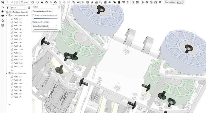

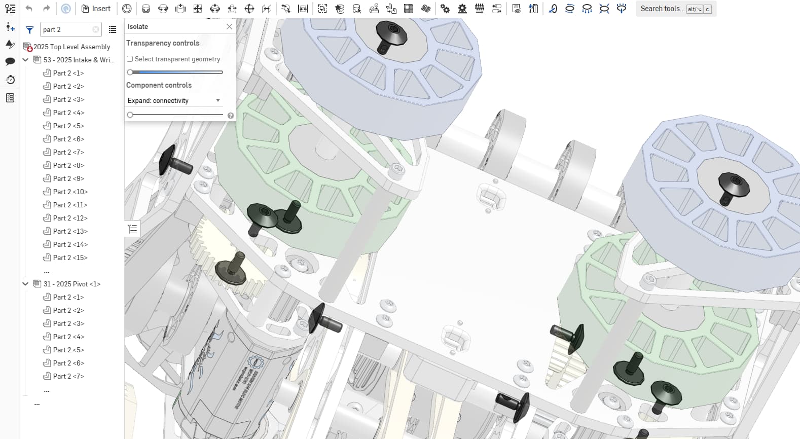

hello! these parts imported without a number in the cad. I was wondering what these were/where I could procure/make them.
Thank you!

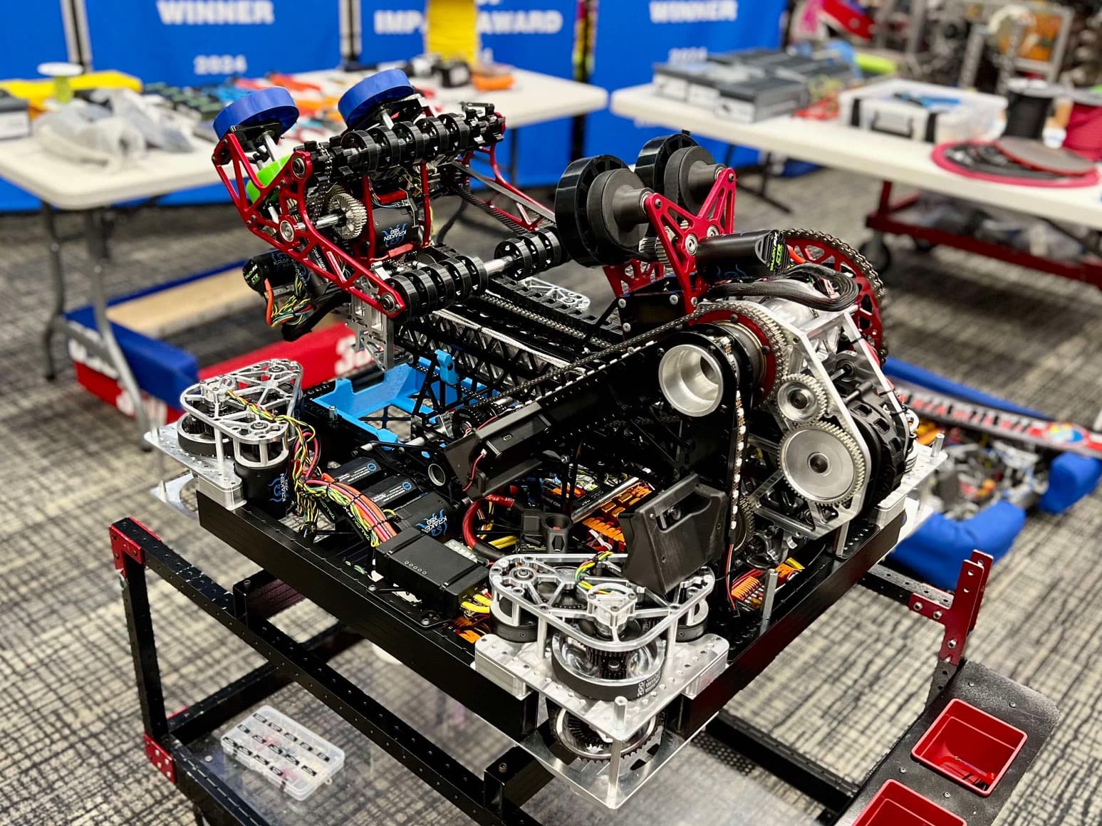

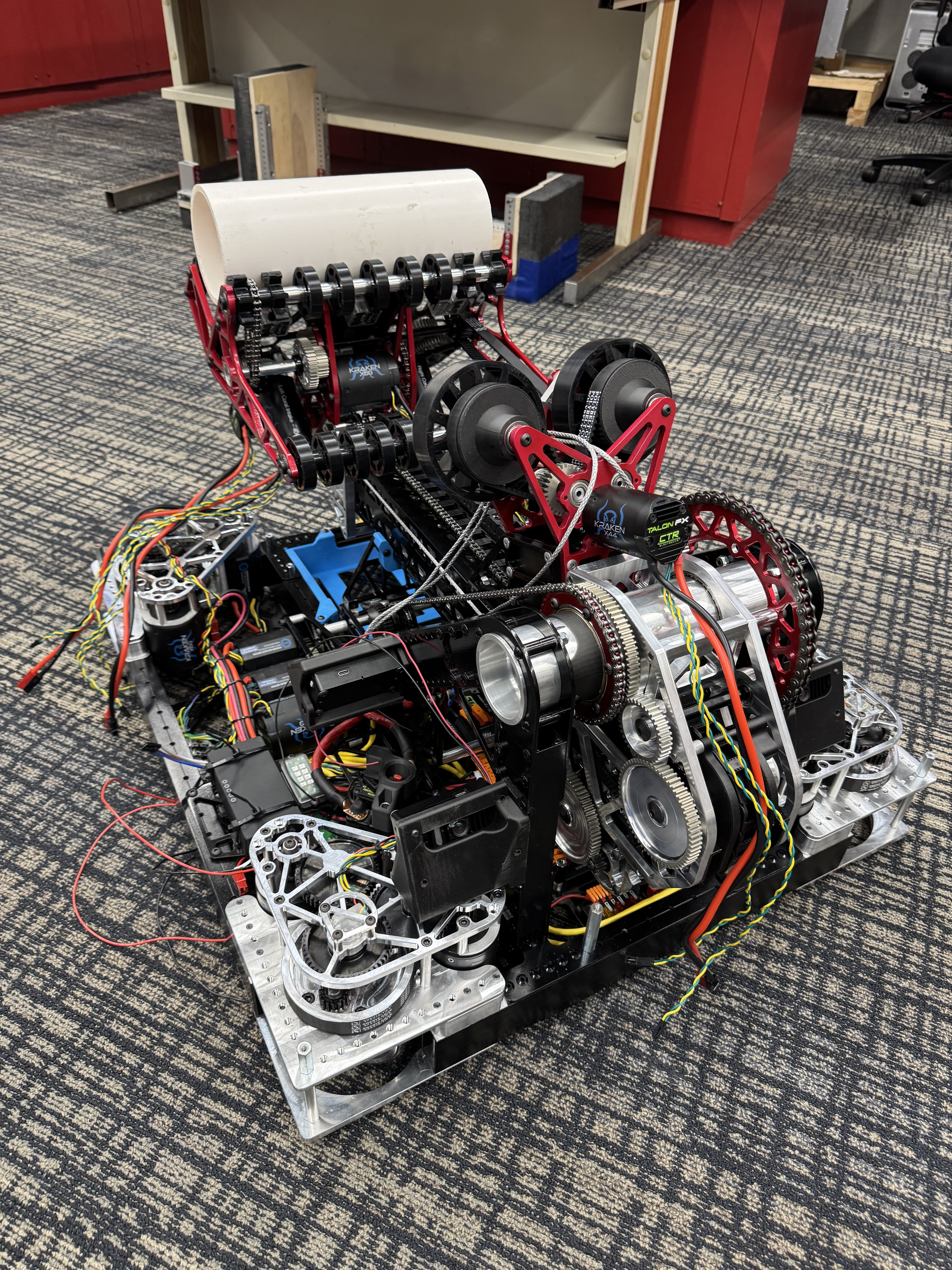

In the meantime, we are planning to put our completed subsystems on the base this weekend and wire it all up. We’ve been running the base getting new programmers up to speed, with the support of 2 new remote mentors from PNW.

The part number for those screws is REV-21-2805. From REV robotics.

Sunday is work on rest of wiring day🤙

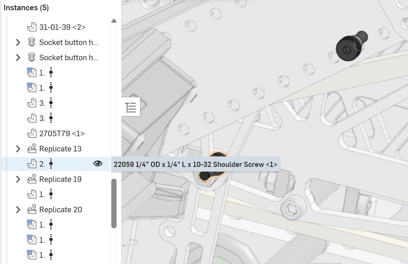

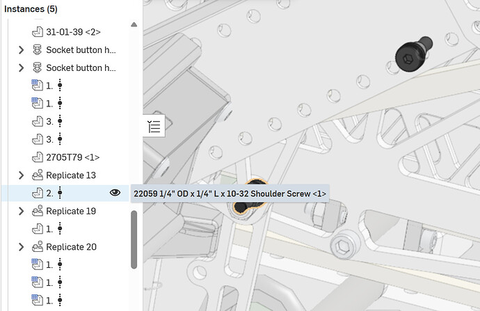

Where were these shoulder bolts sourced from?

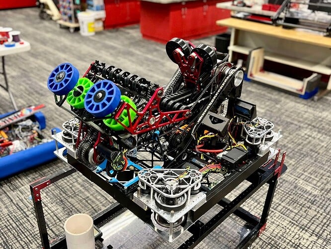

We just about finished everything (sponsor panels and bumpers last).
Thanks for all of the quick responses we had about this robot. There are many intricacies to making this robot, and the previous experiences definitely helped make this happen.
Now on to testing things out, programming with new student leads (with 2 remote mentors and a former student at WPI), and practice for the next 3 months before 3 events in 4 weeks. We did not have a Java mentor since switching to it in 2022. Chezy Champs would have been great to attend with 2910, but last year we weren’t ready and feel that we needed more time with a lot of new students. Our new operator just finished 7th grade.

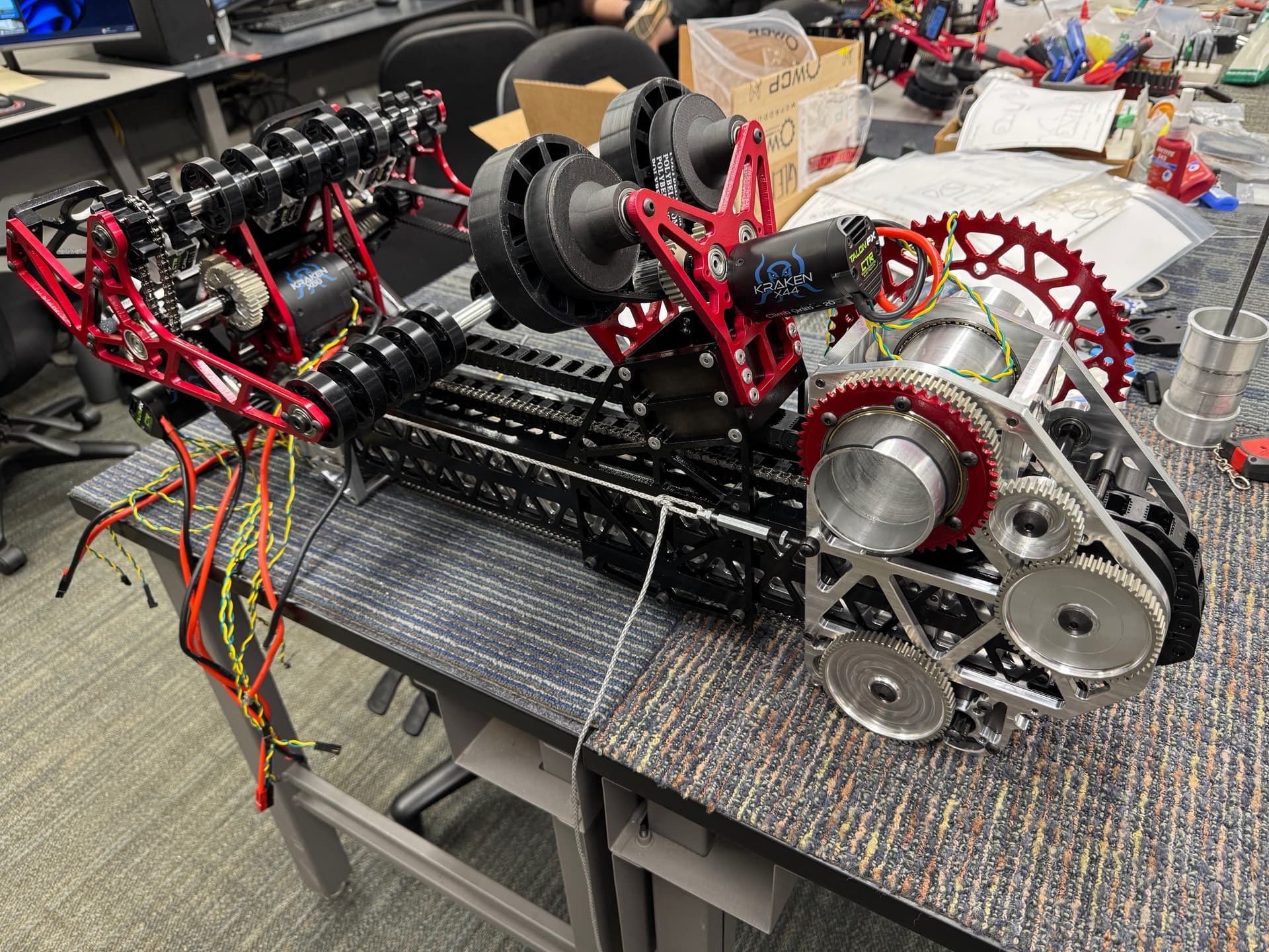

We’re currently running a cable carrier (drag chain) setup for our extension mechanism similar to yours but face serious durability issue, almost everytime we run the extension, our drag chain got snapped and cause massive repair to reattach or restring the wires.
We suspect this may be related to the wire gauge or flexibility. Would you be willing to share what gauge wires (and wire types, if possible) you run inside your drag chain for the wrist and intake?
Any tips would be hugely appreciated!
We used 14 gauge space saver wires from McMaster for the power wires inside the cable chain.
It’s very important that the wires in the cable chain are the correct length such that they are not preloading the chain in tension. We have also talked about (but have never actually implemented) putting a string inside the cable chain that is anchored at both ends to ensure the chain links don’t see tension.
What cable chain are you using? All cable chain is definitely not created equally.
We used igus 045-20-018. We were moderately happy it with it. We’re considering giving E2C-10-20-018 a try. Seems like it is more heavy duty despite being almost as compact.

Hi Patrick, thank you so much for sharing these details.
We’re from China, hence we metric-ized the entire robot. The cable chain is some 10-20 sized, radius 18 product. We also thought about using a string to share the load inside the chain, but found it somewhat difficult to implement cleanly.
Right now, our main issue is that the extension drive cable and the cable chain tend to fail together after just a few motion cycles. Based on our observations, it seems like the cable chain itself shouldn’t fail unless the string does first — which makes me wonder: is it possible that the real root cause is how the string is tensioned.
Would love to hear your thoughts on that.
We use Autodesk Inventor for CAD. Once we exploded the view we used Adobe to convert it to an eps file, to print it large on our Mimaki printer.
If the cascade string breaks than the cable chain will likely break immediately. We found that the extension string we were using increased in length considerably (probably about 3/4") until it was fully broken in. Some of this if from the knots getting tighter. When bringing up the arm we found it was important to tension the cascade stings often initially. If the cascade stings go slack they can get off of the pulleys and abrade on the bearings block edges. We used sand paper strips to floss the holes that the string goes through in the 3X3 tube and stage-0 front bearing blocks. In operation the sting does not move through those holes, but when tensioning it is pulled across them. Having those edges rounded helps a lot with the tensioning.
Thanks! We will have a try. It is a pain to repair this arm ngl.
Yeah agreed, the arm definitely has some failure modes that take a while to repair. This is why we always had a complete spare ready to use at competition. The entire arm is designed to be swapped very quicky. We are able to swap the arm in under 10 minutes comfortably.
