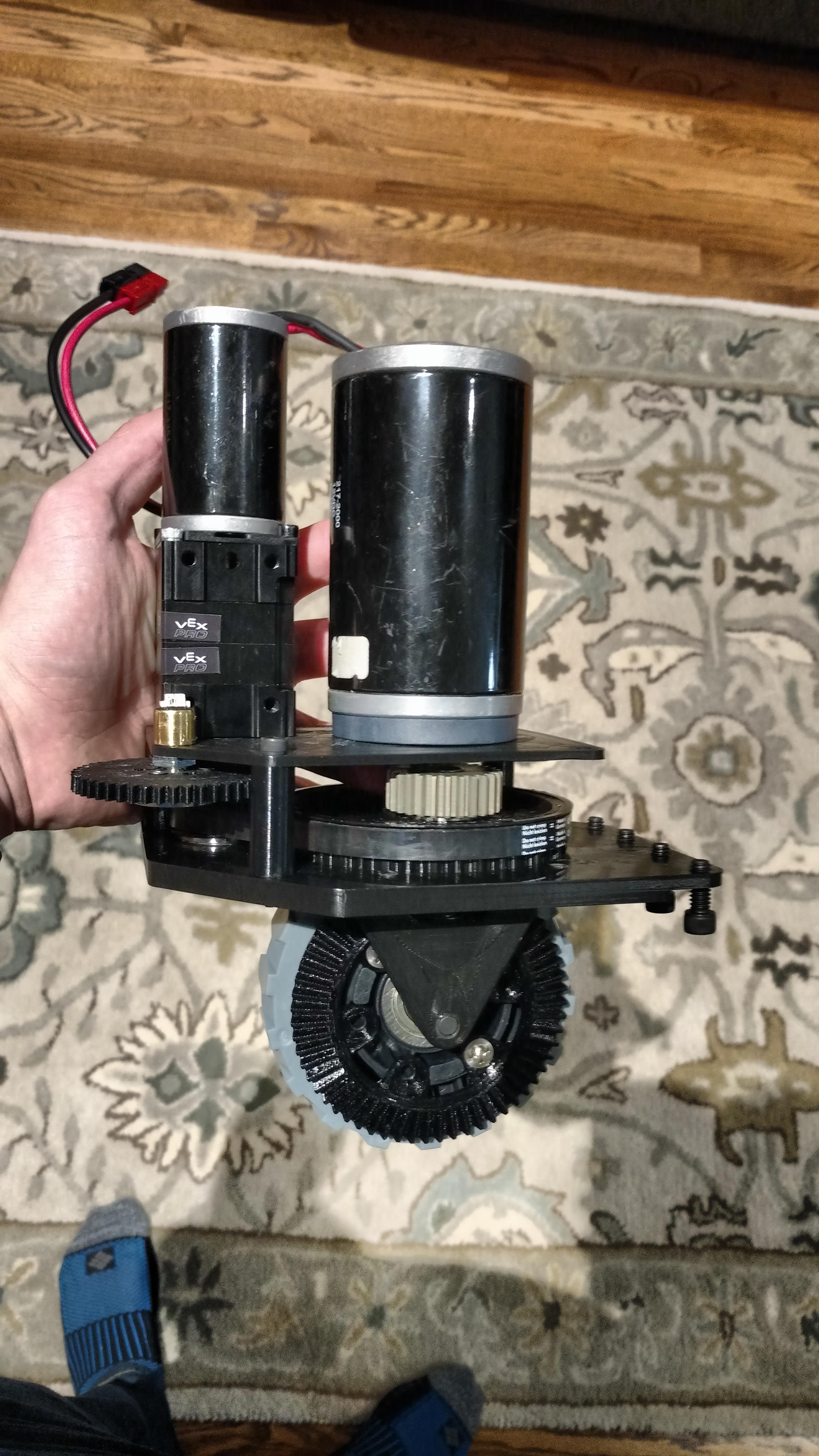

Speaking of 3D printed swerve modules… All parts except gears printed out of black PLA on a CR-10, 100% infill (slightly overkill, we’ve learned more about 3D printing since then. Still, nothing broke)

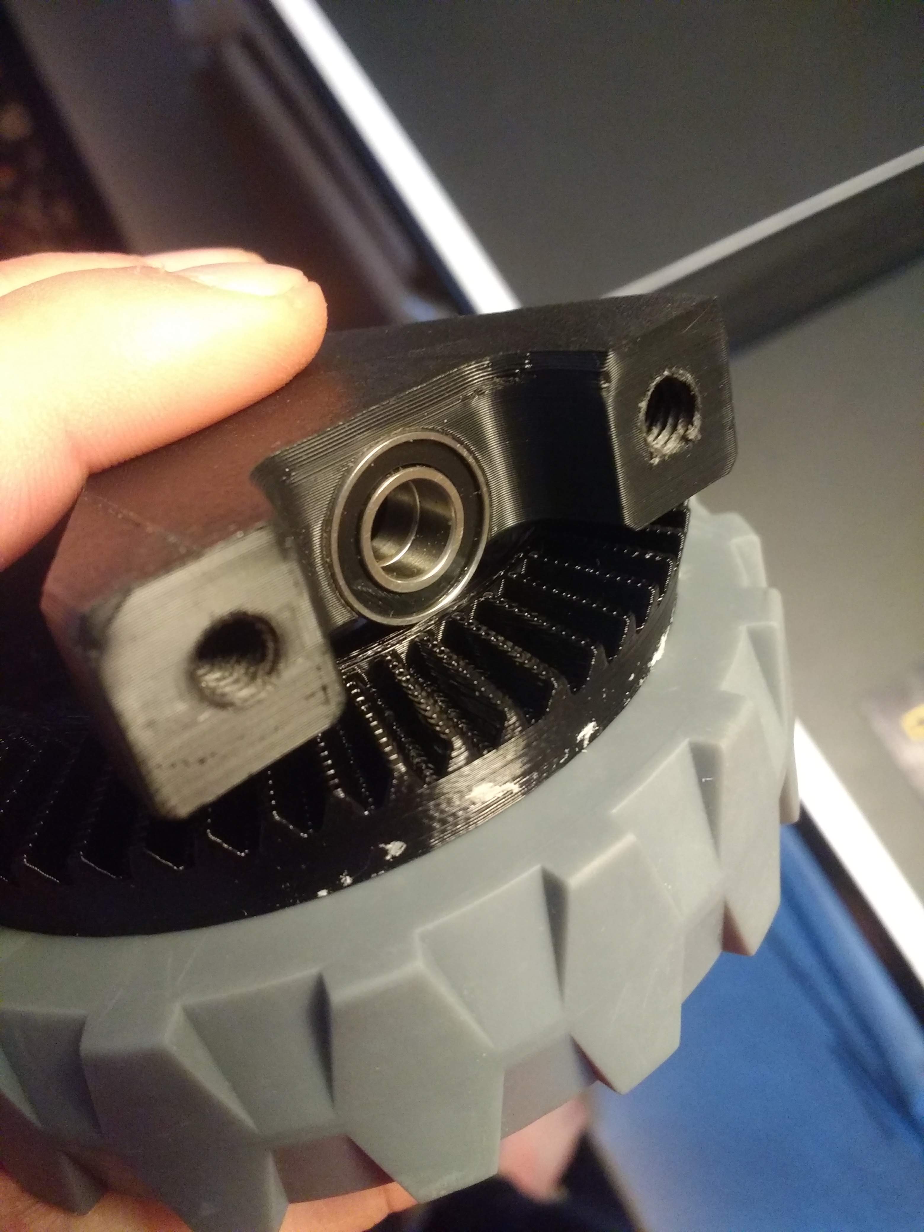

The printed bevel gears (Taulman 910, 100% infill, 0.2mm layers) actually worked surprisingly well. We reinforced the large gears slightly by connecting the teeth on the inner edge before printing and I still have all four gears. We only ran these printed modules on a small practice chassis but they held up extremely well with almost no wear.

Under what conditions was this chassis run? Did it encounter any pushing, drops, etc?
Imma just take that thank you…

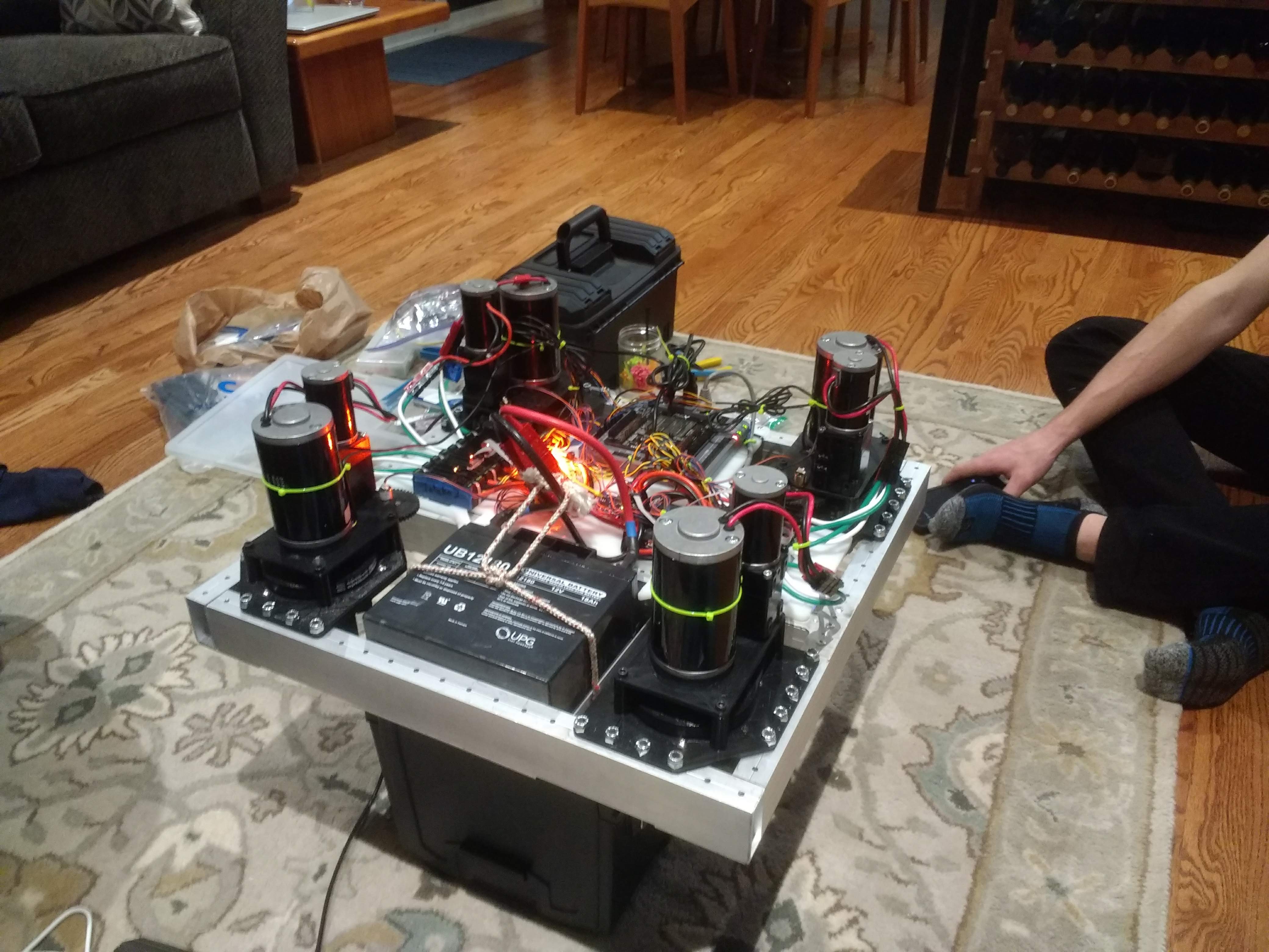

We didn’t do much dropping with it, we were trying to avoid breaking the mounting plates because those would not have held up to a big drop It was mainly a test bed for the software team to play with. If we had dropped it from a significant height directly onto the modules we probably would’ve broken the plates. That being said, I’ll make a bold statement and say that if you made the main plate out of metal (and probably the bevel gears) you could run a full size FRC robot with the rest 3D printed.

The pla face plate on the cim will likely warp a little if CIMs warm up much at all, probably not as bad as ours did. The plate like you said and maybe where the wheels mate with the fork our the most vuneeable and could break easily enough with drops or hard hits on floor elements, like the cargo hold boundary bar.
We ran nylon plates on our 2018 modules. The main plate that the module bearing mounted to was a 3/8" thick nylon plate that was admittedly conservatively lightened, but we never were remotely worried about breaking it. I guess unsure if it would have survived dropping off of HAB2 this year, but my guess the plate itself would not be the fail point, but either the wheel forks or the module bearing itself.

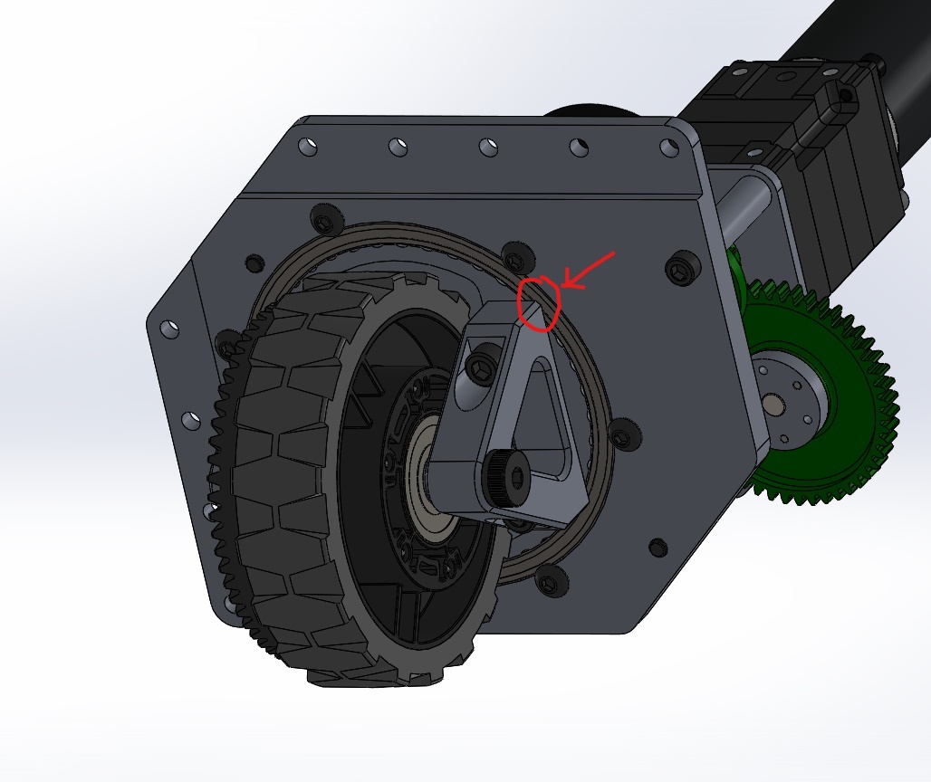

I kinda forgot about this. The edges transferring the force from the wheel/pulley to the bearing/plate are pretty small; it’s probably pushing it for 3D printed parts. (Though with some CAD time it could probably be modified fairly easily)

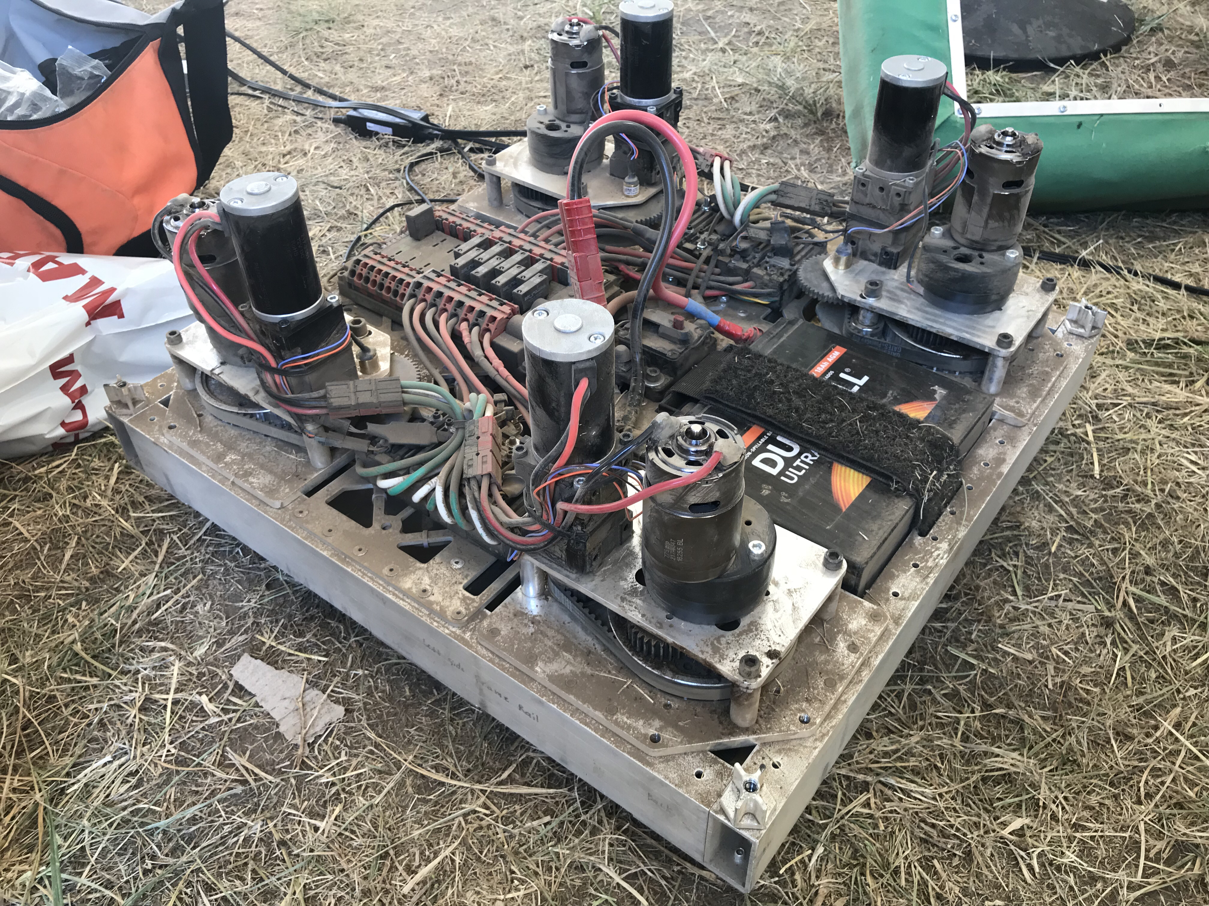

On a related note, 2910 drove the mini swerve robot on a grass/dirt field for hours at the FIRST Washington Seafair booth last summer. Definitely not the team’s best decision.
The robot remained functional the whole time and was completely disassembled for cleaning after the event. The big steering bearings weren’t turning as smoothly as they originally did, but luckily we were able to completely revive them by flushing all the dirt out with WD-40 and re-oiling.
