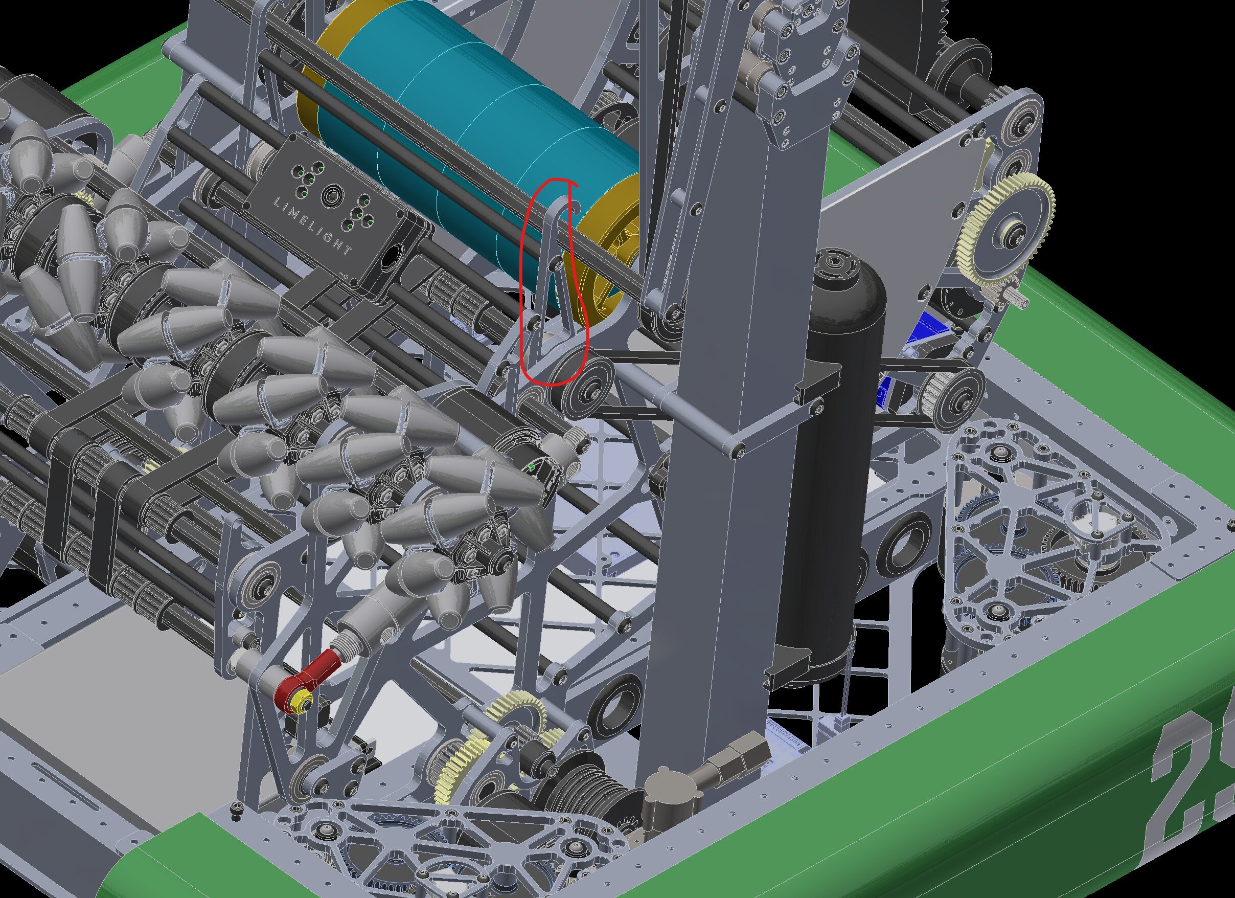

I had a quick question, the hook circled below, is that to keep the climber stowed? Does it start the match latched? If I’m guessing correctly, when you climb, you pull down the climber slightly to clear the hook then run the intake to un-latch, then un-winch to extend?
You are correct. The constant force springs are enough to back drive the climber gearboxes when the robot is turned off. Those hooks are to prevent the climber from extending. The hooks are spring loaded with some surgical tubing (not shown in the CAD). When the match starts the robot homes the climber to the down position and the hooks unlatch allowing the telescopes to extend when we are ready to climb.
What gear ratio and/or strength of CF springs did you use?
We had a similar set up but nowhere near enough spring force to backdrive our gearbox. Though we had less stages on our telescoping arms than 2910 so that would reduce the spring force.
Each stage had 4 of these 2.3 pound constant force springs 9293K263 per telescope assembly. So a total extension force of about 18.4 pounds minus the weight of the stage.
I think the main reason why they were able to to be back driven was because the gear ratio was pretty aggressive. 13.2:1 on a ≈2"D pully.
Having more stages doesn’t inherently increase the extension force. For example if you have 1 constant force springs on each stage of a 4 stage elevator (total of 4 springs) your extension force is not going to be any more than the force of 1 of the springs. The springs are in “series” not “parallel”.
