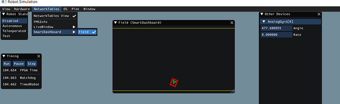

Also, the 2d field window moved from last year (this is in the docs that @auscompgeek posted above, but took us a bit to figure out) . Last year it was in mechanisms, this year, it is in NetworkTables>SmartDashboard>Field.
