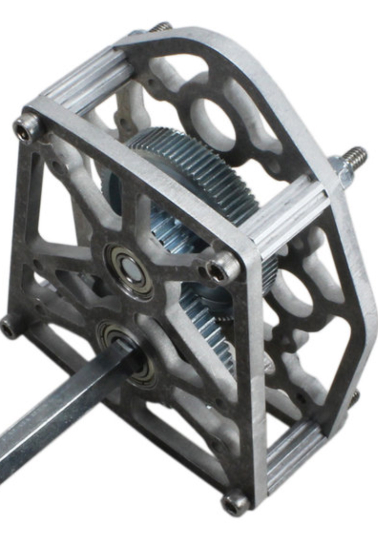

How do these gearboxes compare?
One is a shifting gearbox. The WCP one has “snowman holes” to mount the CIMs with which can cause gear grinding unless you print something to fill the other side of the “snowman”. Check the CAD for more info.
The 3-CIM ballshifter will mount to a 1.875" versakey pattern (or a versablock) if you’re using the 3rd stage (which most of the time you will be). The WCP SS will mount to the holes in a WCP gearbox bearing block, which requires a precision 1.500" hole to be milled into the driverail. Alternatively, it can be mounted with an odd hole pattern and the bottom corner screws.
Why would they make a gearbox that is likely to experience gear grinding?
The “snowman holes” allow you to attach different sized pinion gears to a CIM/NEO. You have the option of 11, 12, 13, or 14 teeth, using one side or the other depending on which one. The unfortunate side effect of this is due to the shape of the holes, sometimes the motor can jump from one side of the snowman to the other, which is what causes the grinding. My team had this happen at an even this year. Luckily, since we had seen the issue when originally receiving and assembling the gearboxes, we were able to identify and remedy the situation within a few minutes.
Many teams have had issues with the grinding, but we used the WCP SS for a couple years (and then messed with them before season with them too) and have never had issues with the snowman circles. I know a lot of teams do, but it’s not every team.
Several of the posts in this recent topic deal with solutions or at least workarounds for the snowman hole problem.

I’ve seen a few times where the motors are installed correctly, work fine for a few hours of run-time, then “jump” into the wrong holes. After that, the gearbox starts making a terrible noise and self-destructing. You can solve this by plugging the wrong holes and/or using a hose clamp or spacer block to hold the motors in position.
