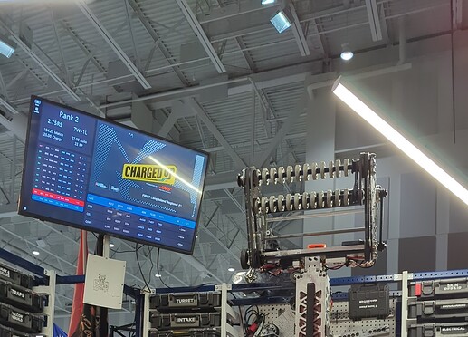

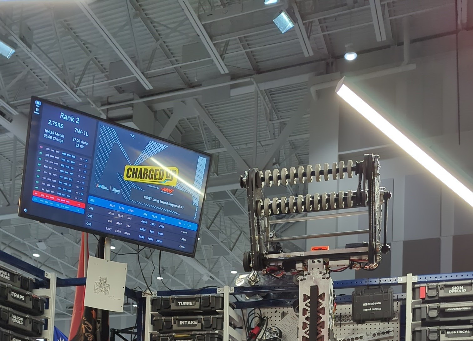

Are there pictures available of the pit display in action?
That was just some testing I didn’t get pictures of it in the pits at RIT but I’m sure someone from 3015 has a few
This is the display in “Event Mode” showing the current rankings and such.

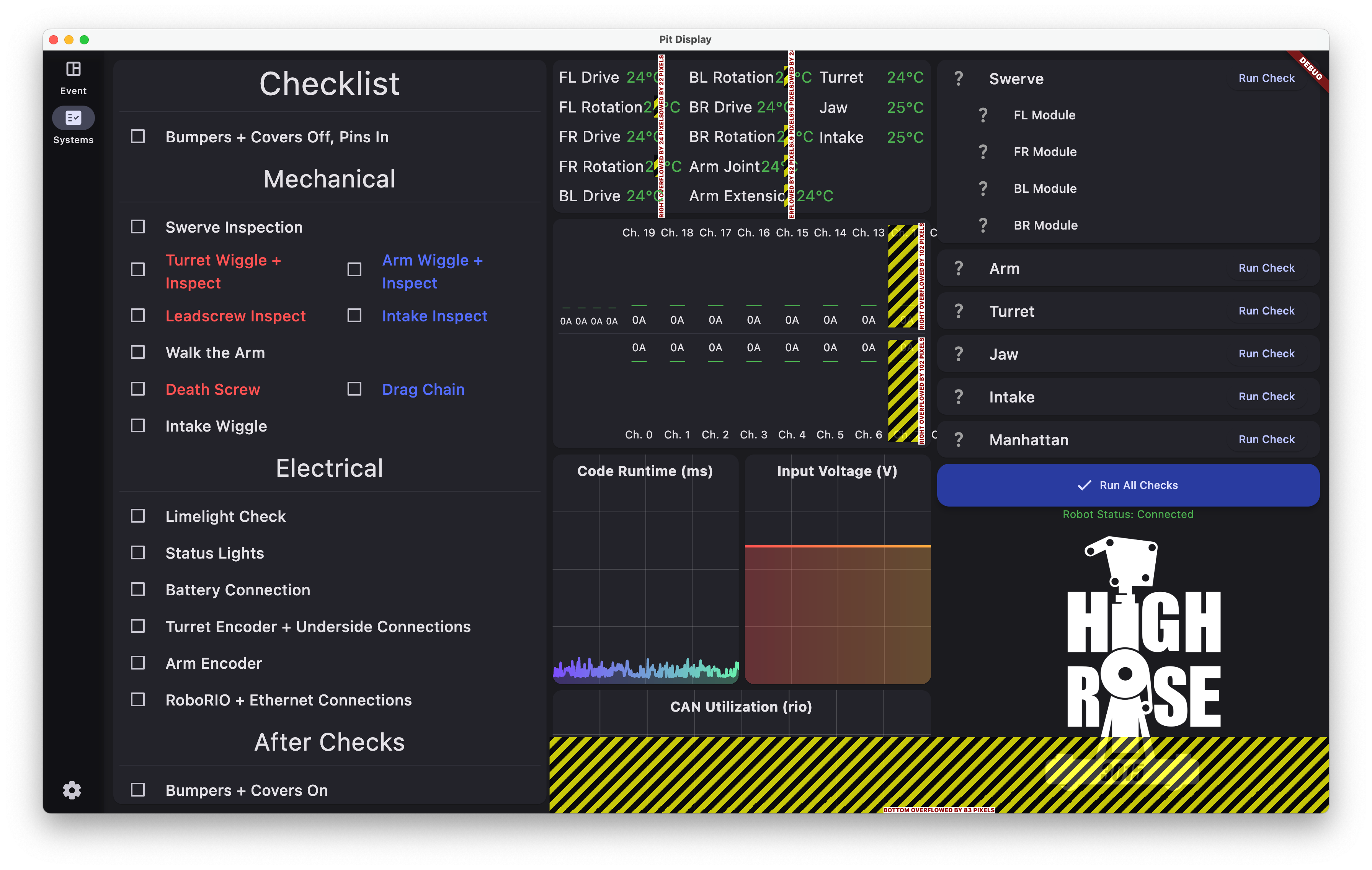

I do not have any pictures of the pit in “Robot Check Mode” but I will see if any of the students have any good ones.
The problem isn’t necessarily bloat, just an annoyance for teams to have to download other libraries they won’t use when installing it. If you just make a note in the installation steps that you need those other vendordeps it shouldn’t be a huge deal.
Apologies in advance for how much of a headache it will probably be lol. Our pit TV is 1920x1080 so we just hardcoded everything for that size instead of spending the time to make it react to different screen sizes properly.
Definitely seems interesting though, looking forward to seeing what you make of it. If you need any help with anything feel free to reach out.
