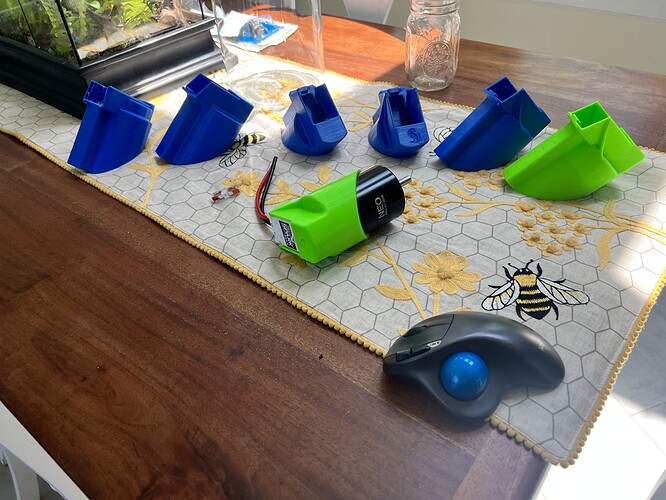

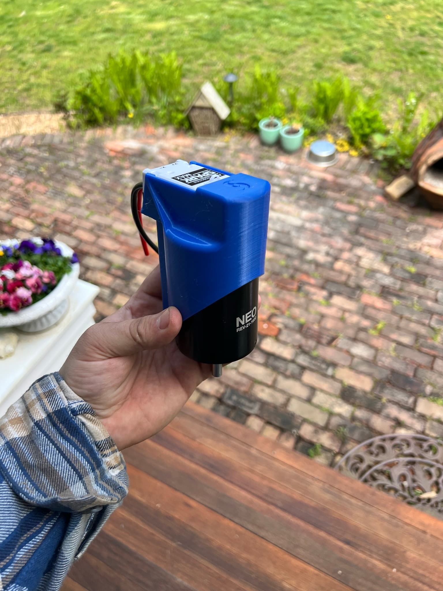

Introducing the HurriLink, an easy-to-print adapter to join a NEO 1.1 motor and SparkMax into a compact package. The print requires no support, save for two bridge tabs included in the model. No modification of the motor or controller is necessary. The print utilizes a tapered recess for the motor, and the new 10-32 hole provided by REV for press fitting provides retention. All high voltage wires are fully shielded, and the annoying encoder cable (sorry REV, it’s the worst part) is completely protected.
Needed additional parts are 3x WAGO 221 inline connectors, or similar crimp disconnect male/females, and 1x 3/8" 10-32 machine screw and washer to secure motor. Instructions for assembly are provided in the Printables link.
There are two flavors of HurriLink provided, regular and compact. The regular version is 4.6" overall height and requires NO wire shortening, so you can give it a try without hacking up your expensive motors and controllers. Love it? A compact version at 4.0" is provided, which requires shortening the high voltage power leads on both controller and motor to fit into the assembly, but has space for the full length encoder cable to alleviate the need to recrimp the tiny connector.
Best of luck in 2023/2024 from the 3171 Hurricanes!

Couple print notes:

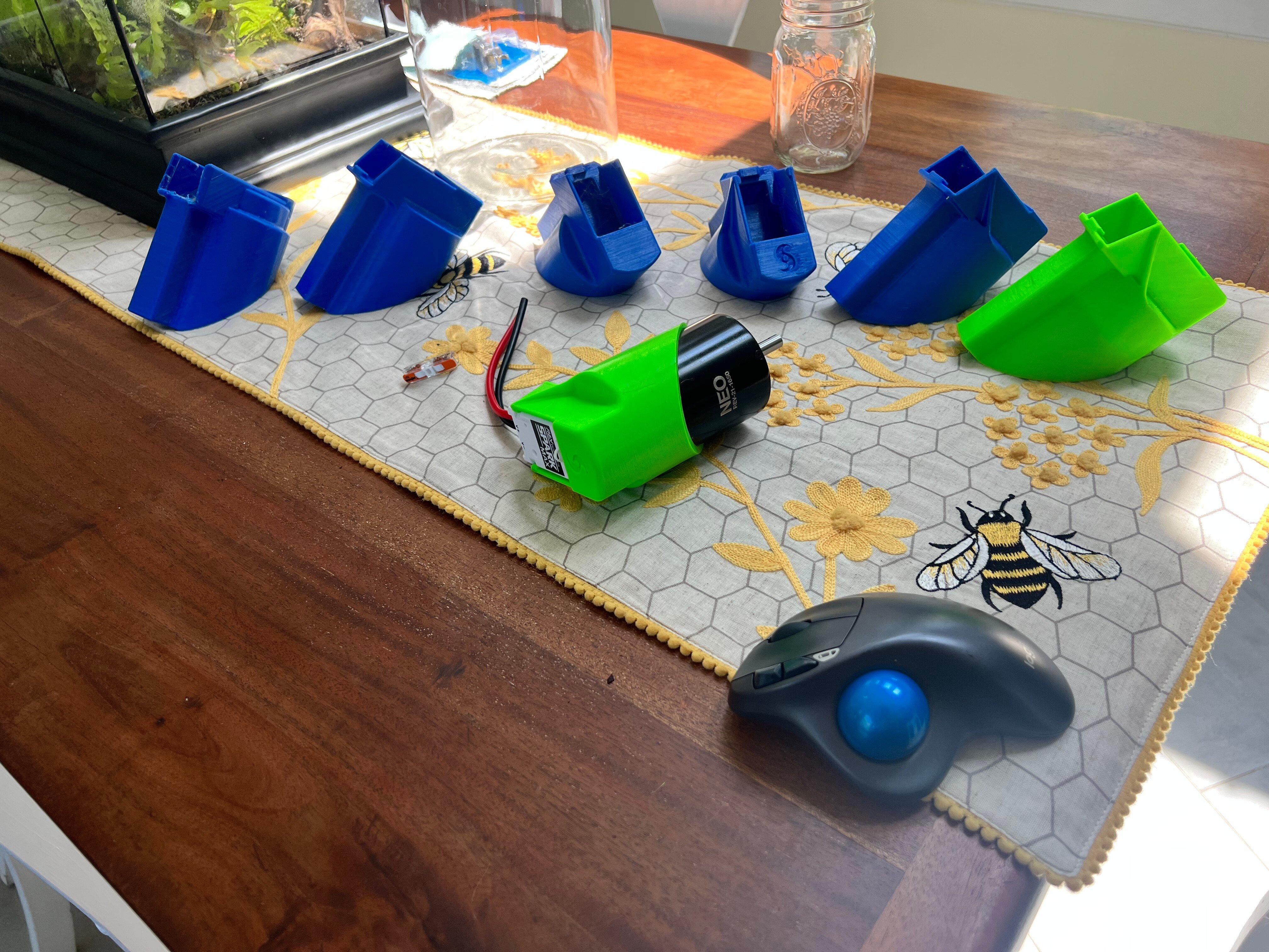

For the base HurriLink, 7.5 hours is a good number for a .4 nozzle. I print with 6 shells/perimeters and 5 top/5 bottom which makes a thin wall print like this basically 100% infill, however with the layer lines oriented with the model curvature for better strength.
For a 0.6 nozzle, I moved to a Prusa Mk3 s and it’s a sub 5 hour print at .3 layer height. It should be noted with a scarfed (45 degree) print, every layer is basically an overhang. It’s best for quality not to exceed 60% of nozzle diameter to reduce sagging, especially with PETG. Best quality/speed was .24 height with a .4 (the blue ones pictured above) and .3 with a .6 (green final ones).
They also take longer because there is more layer distance due to the scarfed print. But, greater strength in both functional axes, no supports despite somewhat complex internal geometry, and exposing at least half the motor case for cooling make it a great trade-off.
I could go on and on for awhile about PETG settings, but the cliff notes are 35mm/s max speed for anything, and print hot - 240c nozzle/75bed. Limit fan to 30% speed max. Very strong parts.
