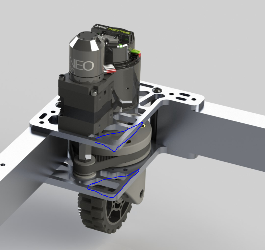

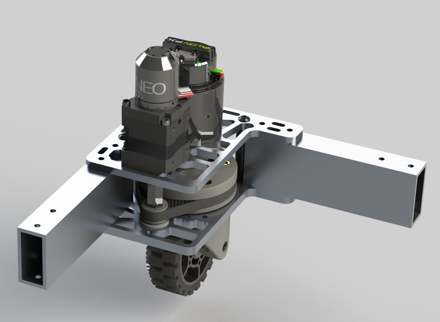

This is a swerve module I designed as a custom swerve my team would actually build and compete with if we are comfortable using custom instead of COTS. This is design is heavily based off of team 2471’s Hermes module, it also takes inspiration from team 33’s winter swerve.
The main goals of this module were to minimize footprint and weight with a 4in wheel and use COTS parts when possible to make it easier to manufacture and build.

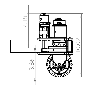

Some stats:
Weight 4.5lbs
Footprint 4in wide x 5.5in long
Height 10in
Ground Clearance 3.86in
Gearing 13:22 (normal) ->15:60 (bevel), 4in wheel
Free speed 16.5fps or 13.9fps using the same spacing
Azimuth gearing 10:1 VersaPlanetary Lite → 20:80 belt reduction
The drive motor is a Falcon 500, azimuth motor is a NEO 550. 4in black tread HiGrip wheel for simplicity (no custom tread, no hassle). The bevel gears are the same as 2910’s MK2 module and are from from Swerve Drive Specialties. The top plate is 1/4in thick aluminum and the bottom plate is 5/16in thick aluminum. The azimuth pulley and wheel forks would be 3D printed out of PETG or onyx.
image (4) image (5) image (6)
CAD can be found here : https://grabcad.com/library/swerve-10-1-1
I would like to reiterate that the majority of the design work was done by teams 2471 and 33, so big thanks to both of them for sharing their designs.
Feedback is greatly appreciated

Any reason why the plates are filled out here? It doesn’t do much for the rigidity, and you might want that real estate later on a robot. Alternately, you could put a standoff in the corner instead to improve rigidity.
No particular reason that I left that. I will mirror the mounting holes on the other side of the versaplanatary into that space and add a stand-off, thanks for pointing that out.

If you got rid of the extended part of the plates that mount to the tube, you could make the plates rectangular and symmetrical so you wouldn’t need multiple spare modules and plates for each version (left/right). Even if you can flip the plates for each module so you don’t need to machine different plates, you’d still need twice as many spare modules at a competition.
I can’t just cut that part off because then the tube would not have enough surface area to mount on and I don’t want to extend the full plate to that width because that takes up robot space and adds weight.
I see what you mean I didn’t notice the tube cutouts.
